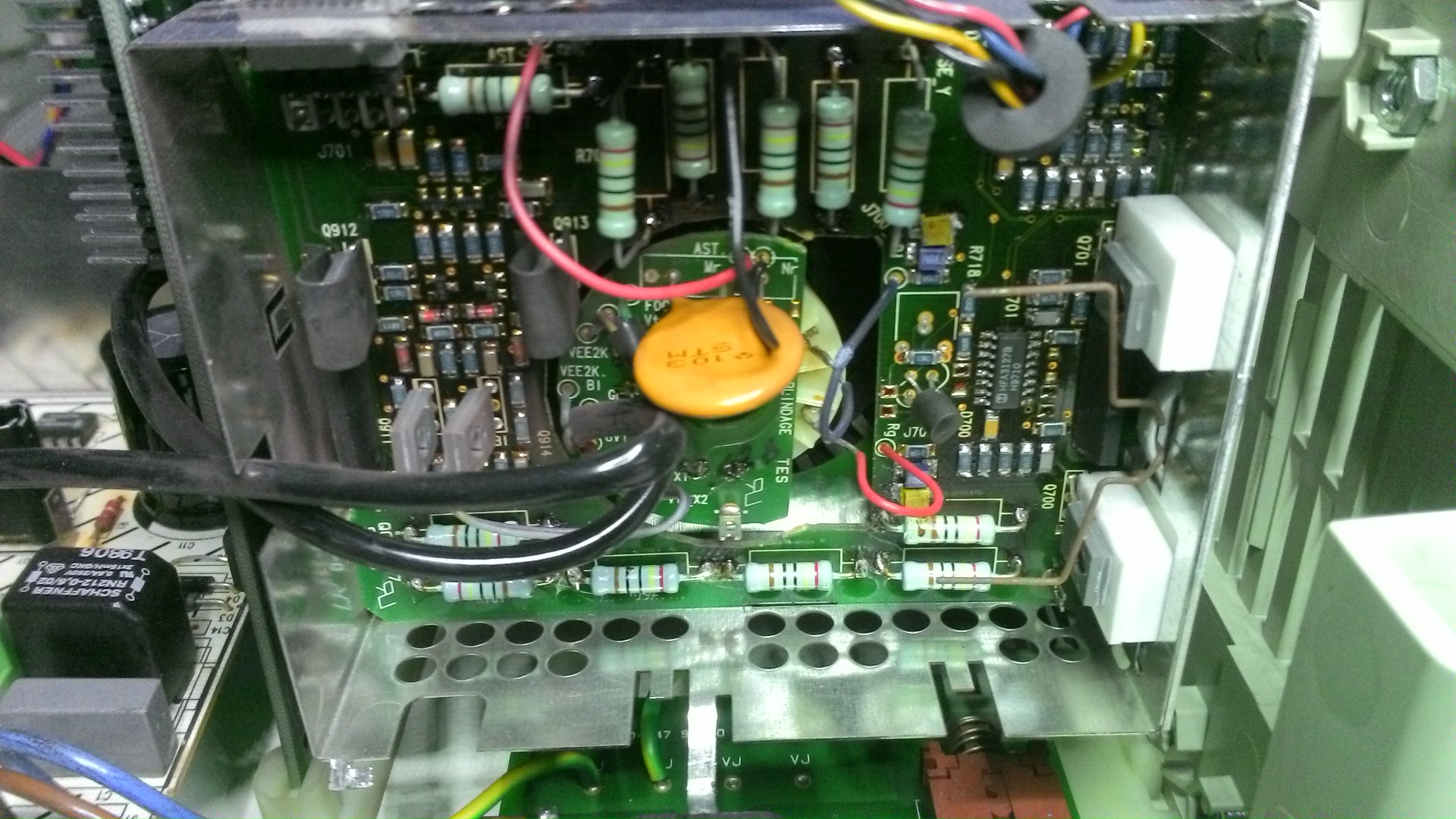

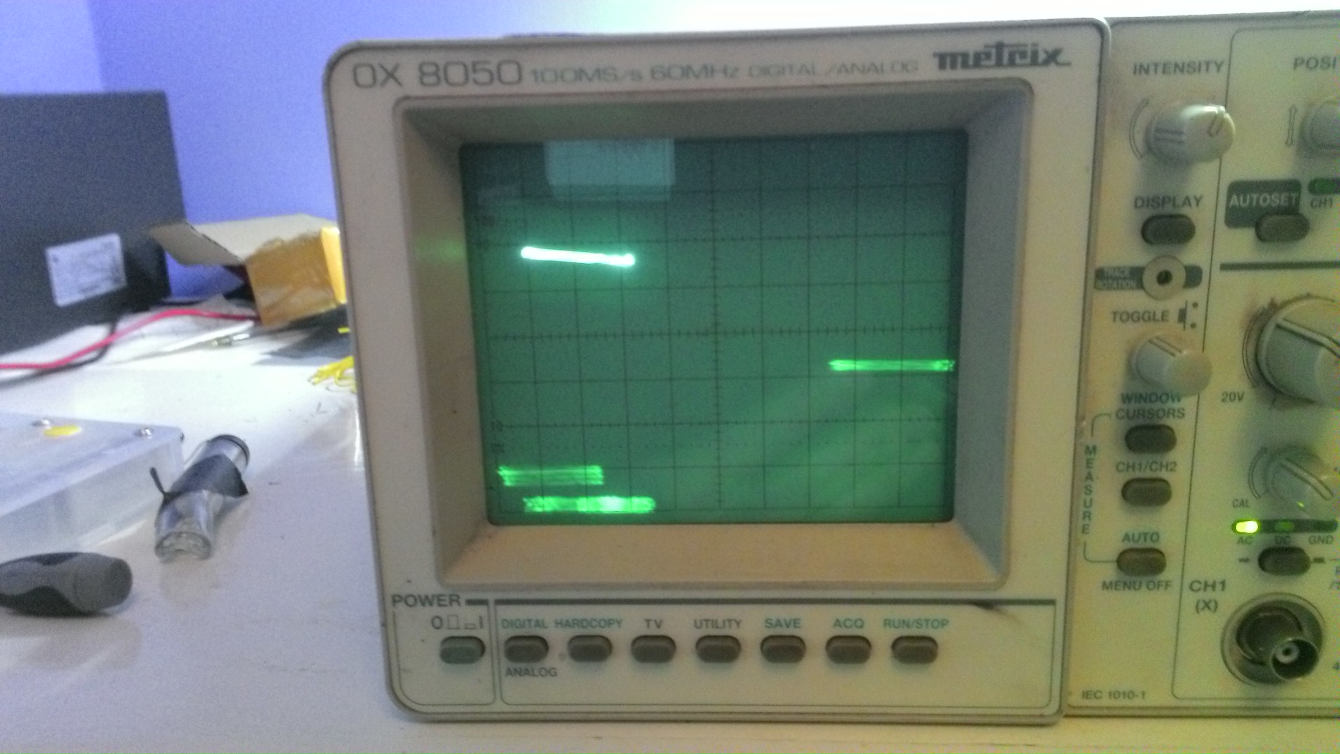

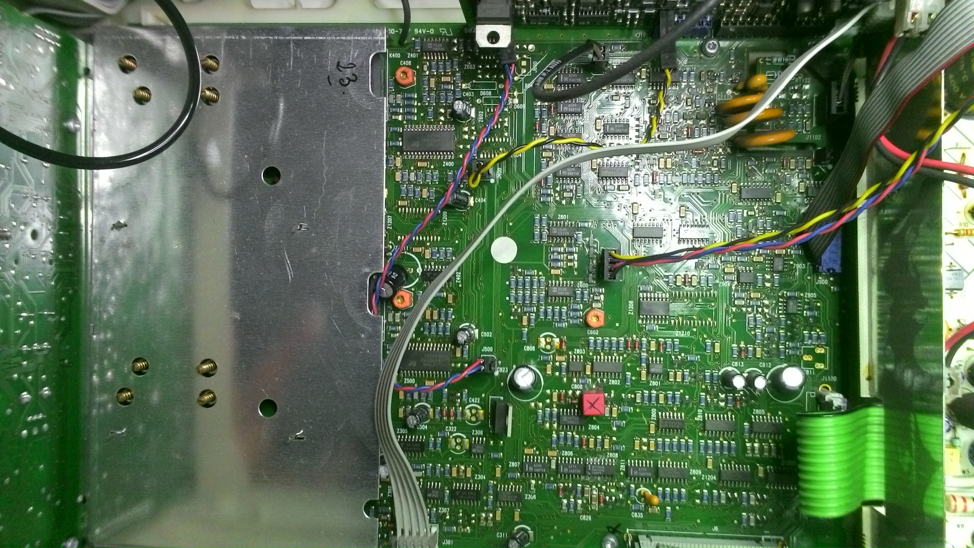

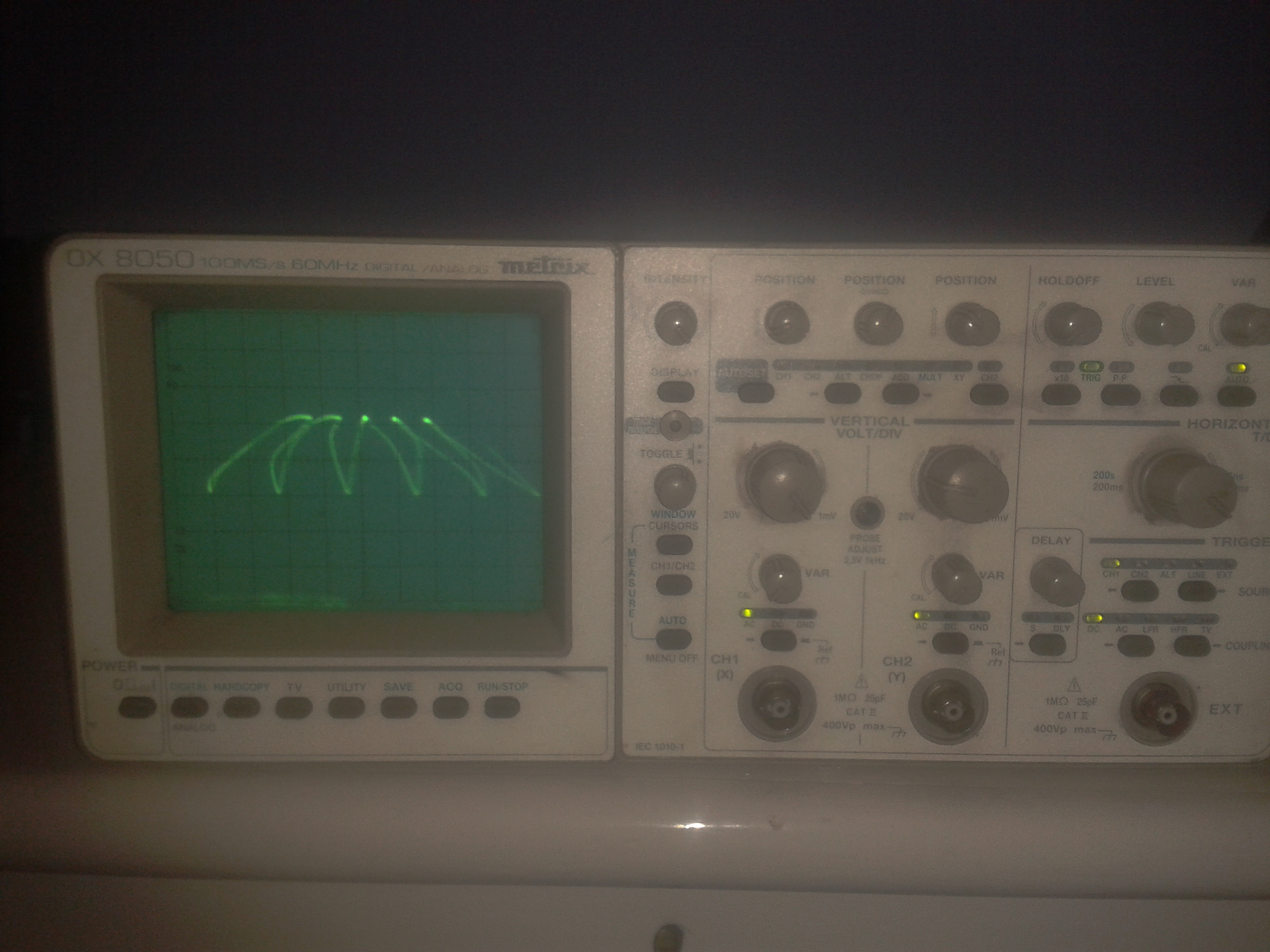

The display is constantly fuzzy and displays this noise from somewhere! The odd thing is I can tune in to this frequency using the oscilloscope functions although the writing from the digital processor is also displayed fuzzy! I'm banking on it maybe been a noisy power supply seen as it's all driven from a switched mode power supply, but we'l see!

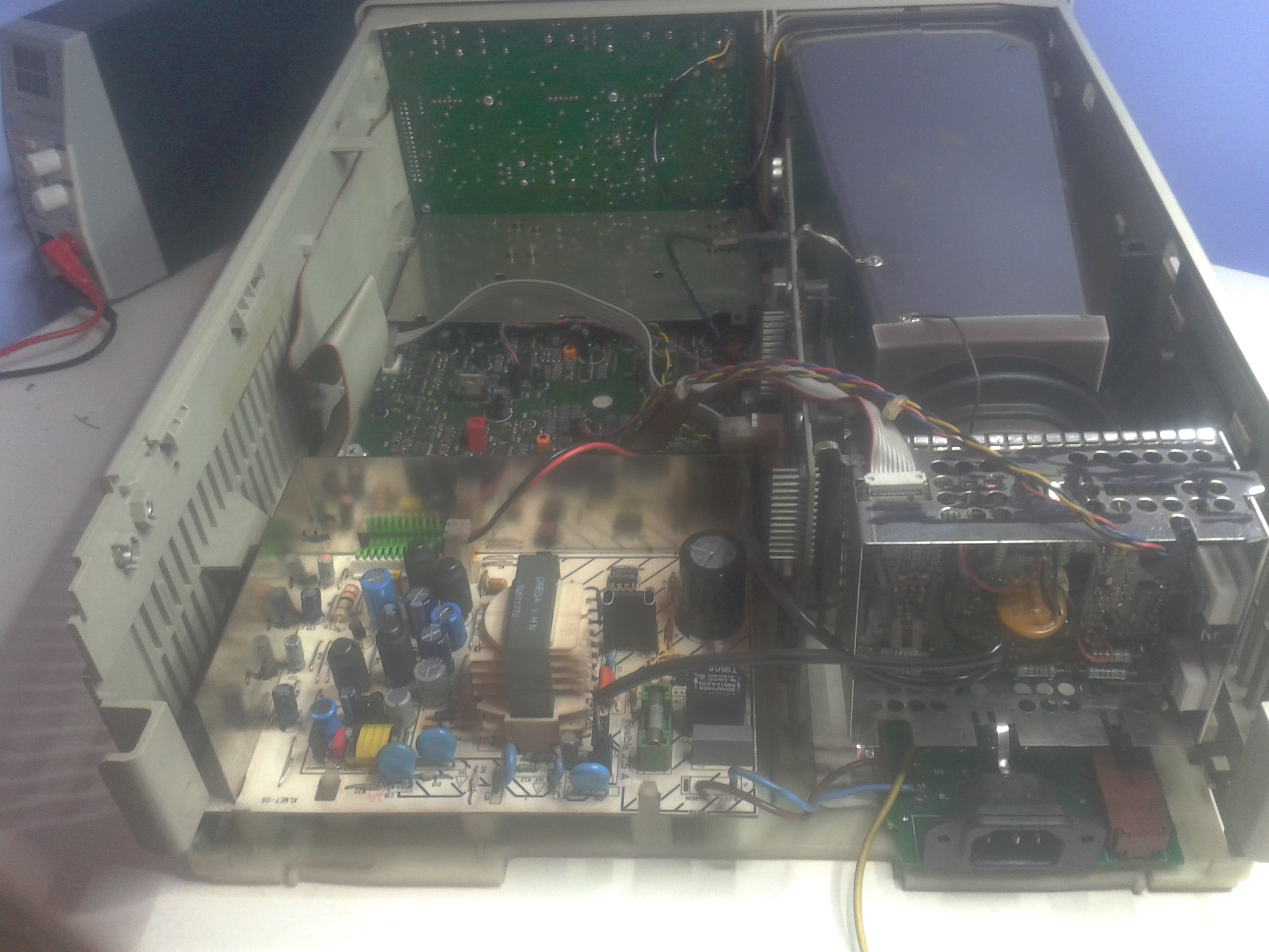

The internals are relatively empty for an oscilloscope this size!! Can't seem to find anything on Metrix at all in terms of a service manual or a schematic!
See What you think!
Tom

Just out of interest I fed a 1200Hz frequency into the scopes channels to see what it would display. I could tune into the waveform using the oscilloscopes controls but the display of the waveform was very fuzzy? Thinking now this could possibly be a fault on the scopes tube driving circuit! The tube circuit is also new to me as it has no flipper transformer so I'm not entirely sure what type of tube I have! Any advice would be really helpful right now?

These scopes all look to be very similar in basic construction as you can see below. As to the buzzing, its most likely a duff capacitor, which one exactly I don't know, but I might be able to offer some assistance by comparing with my now functional OX 803B
What I would be interested in are some better pictures of the inside of your OX 8050, as it might give me some clues about the unused connectors on the main board of my 803.

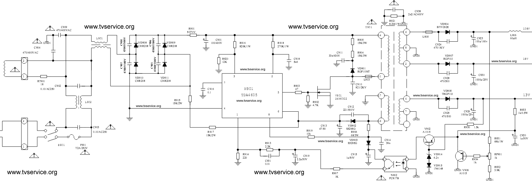

The noise you are hearing could also be due to issues with the switch mode PSU glitching, so if you follow through my post on the badcaps site, you will see the parts I replaced on my PSU there. If you have an ESR meter then give all of the PSU caps the once over (pay particular attention to the caps I swapped as they are the most likely ones to fail).
Check the values of the resistors associated with the TDA4605 and the MOSFET.
If the switch mode controller circuit is not working correctly then the MOSFET may be overstressed or firing when not required, and this might also cause noise. (The usual warning about high voltages applies, there are some pretty hazardous voltages in that part of the world, and these persist for a while even after switching off and unpluging the mains lead).
Take care when replacing components, I found my board was very prone to tracks lifting. That may be because my de-soldering technique is a little rusty, but I'm blaming it on the fragility of the board. If reworking any of the TDA4605 stuff, carefully discharge the associated caps with a high value resistor before replacing the TDA4605 or the Mosfet, particularly the big 400V main input electrolytic (C11 - 100uF 400V on my version). Pay attention to the accuracy (1%) and wattage and voltage rating (500V plus, depending on the location) if changing any of the PSU resistors, use good quality low ESR high temperature replacement caps if you want the thing to still be working in 10 years time.
As I said previously, carefully remove as much dust as you can with a clean dry paintbrush. Dust + HT = horrible crackling noises, arcing leading to untimely demise. Many years ago I used to work with faulty CRT monitors and terminals a lot. The grubbier they were, the more likely they were to fail. Dust + airborne grease and grime can have a surprisingly low resistance.
I couldn't find the schematic for the PSU online, but there is a similar design here..
http://www.tvservice.org/files/img/n583_big.gif
Obviously there are differences in component values, layout, and so forth, but this is the closest TDA4605 based design I could find. Similar but different. Close enough for you to get an idea of how it works though.

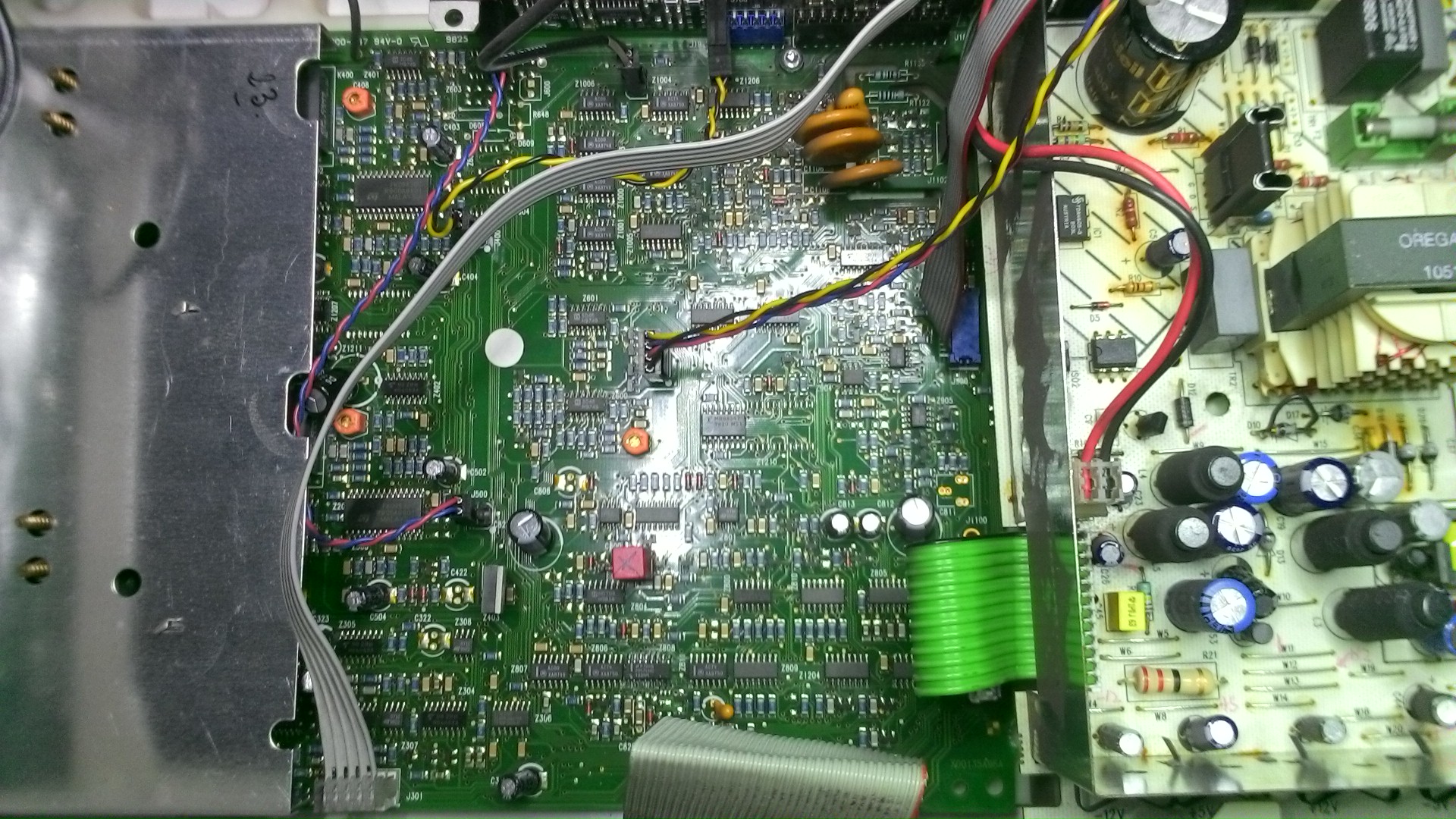

If you do get a chance, see if you can get some clear sharp pictures of all of the boards in your scope (no need to take them out, but the pictures need to be clear enough to identify traces and chip markings). I have a feeling that it might be possible to do some interesting hacks on these things. My first target is trying to add a serial port. Next is to try to figure out how the digital card in the 8040, 8050, 8100 series does its magic.

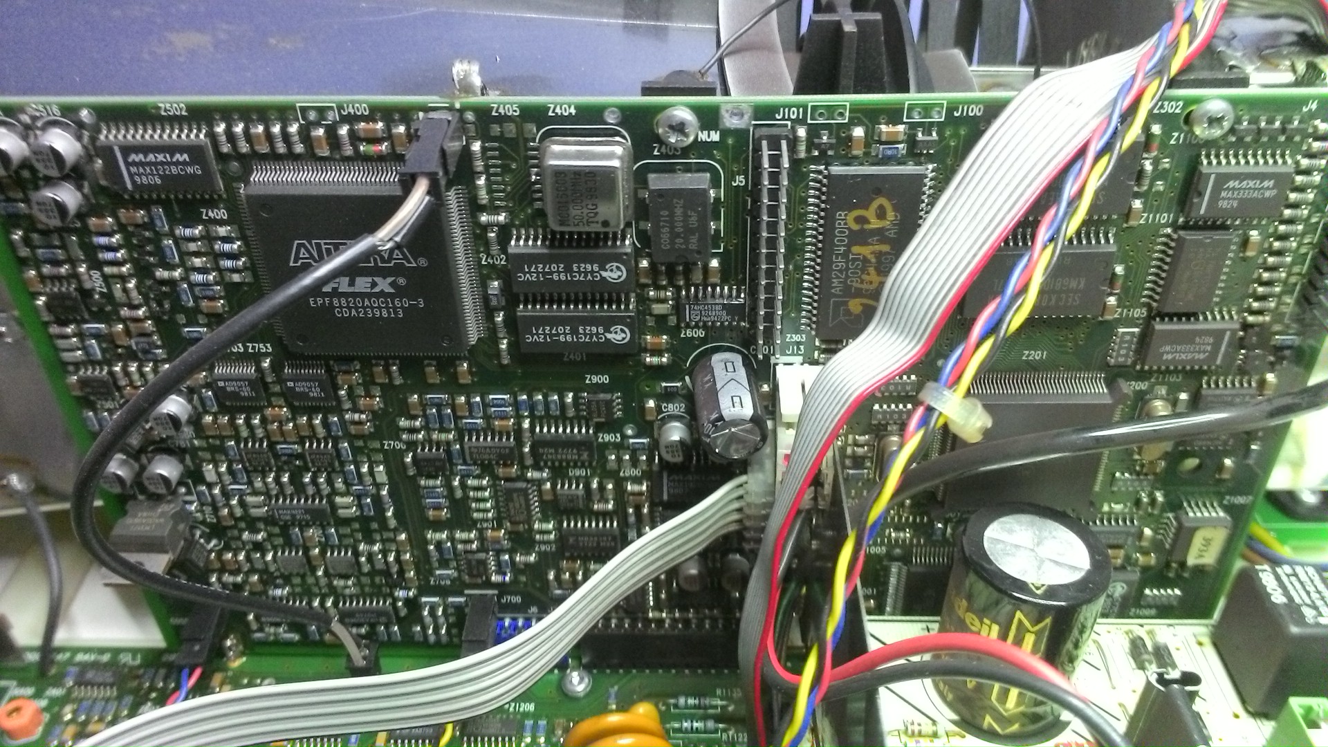

Interesting. Lots of stuff on the A to D card. I didn't realize it was that complex.
Some of the more interesting parts are listed below.
12bit ADC
FPGA
4Mb CMOS Flash
2x8bit ADCs - 80MS/s

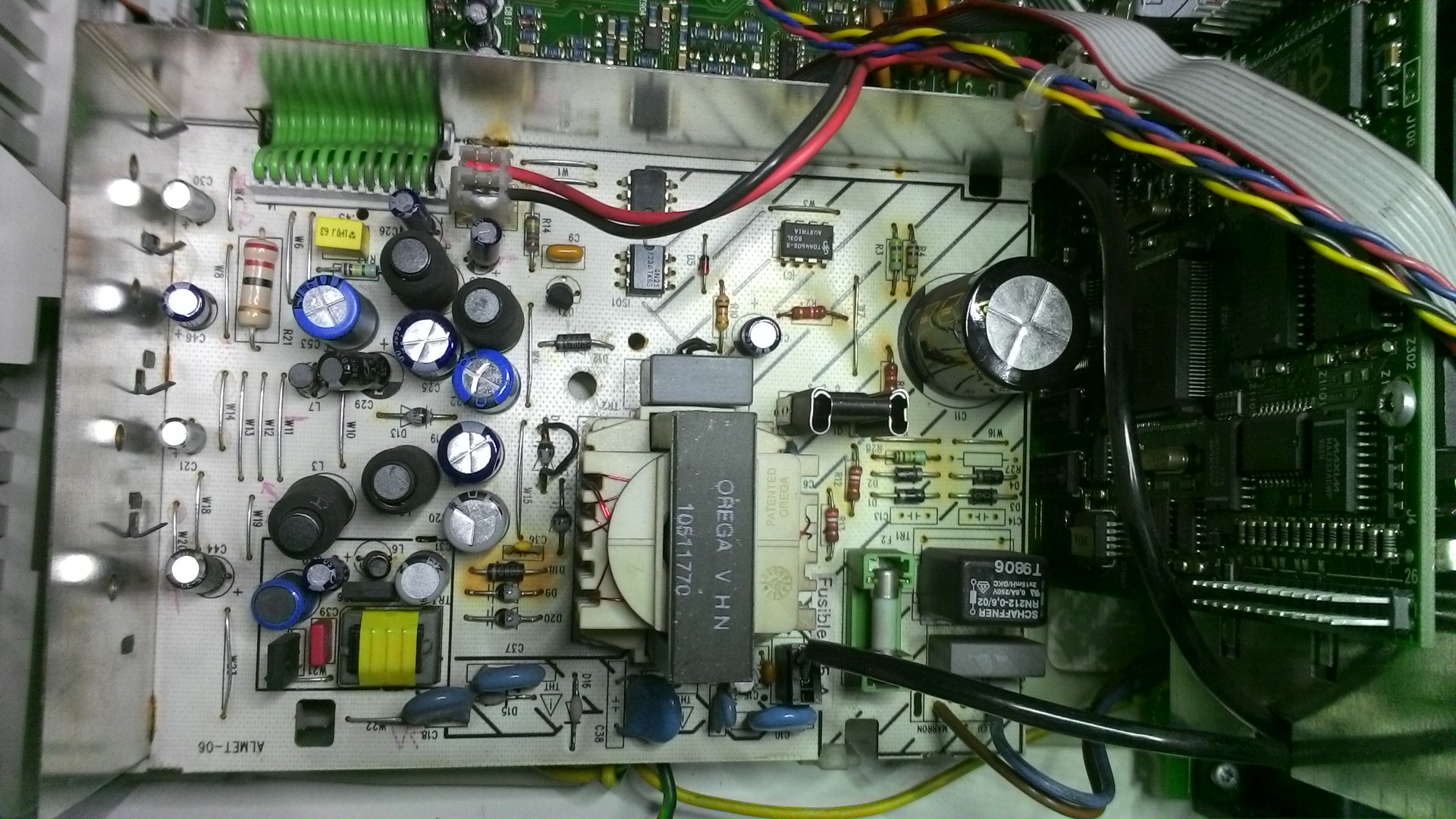

If you compare the PSU pictures of the 803B, mine looks like a slightly later revision of the same PSU as this. There is a fairly complete set of pictures of all of the boards in my OX 803B here.
https://plus.google.com/u/0/photos/111082960064282217370/albums/6094881872199591361
My gut feeling is that your problem lies on the PSU board. There are a number of heat marked areas on that, and C5 looks a little the worse for wear. Also check the values of R3 and R4, if they are more than say 10% out, then I would suspect them too. Strangely all of the resistors on my version are 1% and possibly higher wattage.

PSU board
Compare your PSU with...
https://lh3.googleusercontent.com/-...AAAABec/BNGRNo8kByw/w754-h566-no/RIMG0234.JPG
... layout is slightly altered, but component names look to be the same.
While I remember... I would check and if necessary replace C15 - on mine it looked a little cooked, and was one of the things I replaced.
What is the story with the Diode next to W15 and C63, it looks from the photo as if it has a bodge wire soldered across it, and there appears to be another bodge next to R10 - are those your modifications?

Are the images stable or shaking?
Do you have a high voltage (>2.5KV) probe for your other scope?
Did you clean all of the dust out of the HT side of the PSU, and the tube connector?
Is the image brighter/squashed at the top or the bottom, or brighter/squashed at the left or the right, or anything odd like that?
If so, that would suggest that the ramp voltages to the plates are getting distorted by the problem, and this would also tend to suggest the high voltage and/or HT side of the switch mode PSU is the probable cause.
Can you show me what the "Probe Adjust" test waveform look like?
When you change from Analog to Digital mode, and vice versa do things get any better?
I would check the caps on the HT driver (C31 and so forth) they are only pennies, so perhaps just replace them anyway and see if things settle down. Watch out when working on that part of the board, I imagine you can get a nasty belt from there even after things have been powered off for a while.
That shorted diode is a little bizarre.. since I don't know what that part of the circuit does I can only speculate on the effect, but it seems odd to fit a diode and then short it out. Certainly shorting it would screw up any rectification it might have provided but I would have thought that might result in a... lot of high frequency noise, or magic smoke as the output from that switch mode transformer coil would then be passed un-rectified to wherever.
EDIT: I just took a look at some of the pictures of my PSU, and there looks to be a link labeled E1 that allows shorting of D10, so there must be a reason for this strange arrangement. Different models presumably use different arrangements. Very odd, needs closer study.
I would need to know what is going on, on the back of the board (pictures of both sides of the board) to figure out what that the effect of that bodge is likely to be. I wouldn't remove that bodge wire just yet, until we know what its intended purpose is. It may have a deliberate purpose, rather than being some previous attempt to fix this issue.

I will have PSU board out again and have a look where d10 feeds! hv sounds like a possible cause then as the picture does dance around quickly insinuating hf noise! the trace is like it is compressed in the center yet as you move it side to side it stretches! Intresting thread on the crt tube manufactures there!!
I suspect the link across D10 may be a red herring. I would concentrate on the other voltages. I suspect that whatever voltage is used to power the ramp voltages to control the plates is sagging and having issues, and that probably means a duff capacitor on the PSU side. HT breakdown is another possibility. The dancing picture certainly suggests something is leaking/breaking down. Is the shimmering only in one axis? In other words does the picture shimmer left to right, or up and down, or both?
Well I think I have cleared up the mystery of the diodes (i.e. the link across the D10 diode).
There is the option to have one or two diodes in series on one of the power rails, selectable by linking out one of the diodes. This must be model dependent, so not the result of some misguided attempt to bodge up the PSU.

Forensics on your 1st photo indicate the digital vector output is very limited. A working display would be very complex series of dots filtered to show only the lines connected between the dots.
In this case 5 dots are on the screen and 6 loops that would appear to be spurious loops between the dots.
I would expect hundreds or thousands of dots on the screen to form the characters and the signal but filtered to convert the dots into slew rate limited vectors between the dots.
Therefore I would start looking at the Dual DAC for problems either digital going in , or analog going out. It appears the Y axis DAC is not working at all.
