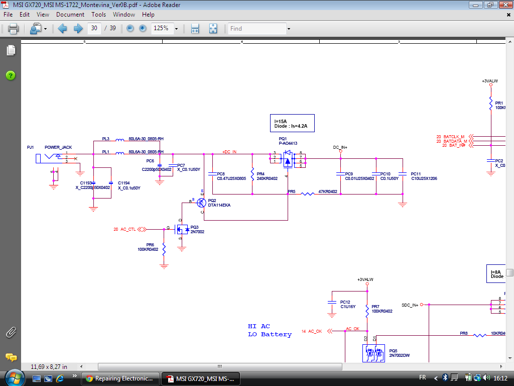

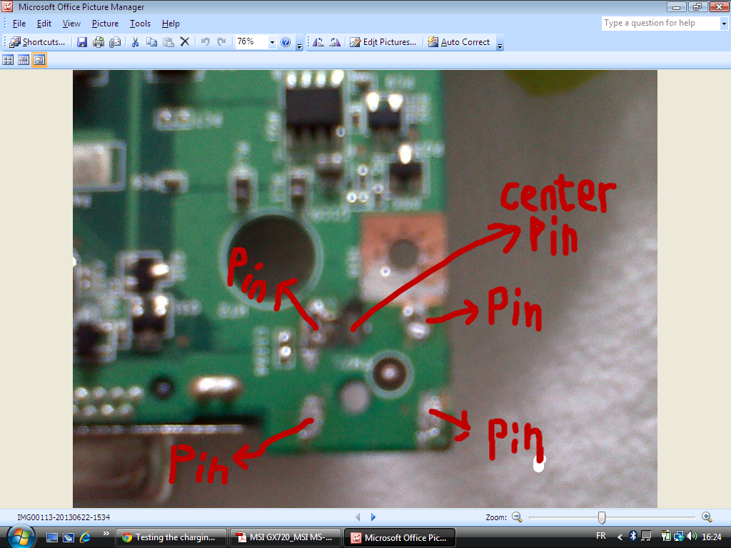

i have MSI GX720 1722 laptop ok the motherboard works fine on battery the problem is the pins on the
motherboard are messed up i lost all traces of them this laptop has dc power jack (5 pins which is brooken)
i ve removed the faulty connector ,and i bought a new one but the problem the pins holes on the motherboard are lost so ther is no way to reconnect the new dc power jack.
i will attach a picture of the dc power on the motherboard ,and a shematic of the motherboard.sorry for the quality of a picture.
thanks for help

The good news is that only two connections appear necessary; ground (outer sleeve) and centre pin. Providing you can physically anchor the jack to the board (epoxy, bracket,....?) it should be possible to run wires from the jack terminals to suitable points on the board.
If the original jack was fixed to the board only by pins which are now damaged or missing you will have to find some other way of fixing it. Options include epoxy resin, or a hand-made bracket or clamp.
yeah the original dc power jack connector is brooken ,and the center pin on the motherbord is lost.
if you look at the schematic the pin 1 (which is + positive) from dc power jack goes to PL1 and the negative(ground)goes to any groun terminal on motherboard. my question is it possible to connect the (positive+ which comes from power supply to the PL1 ,and the ground which comes from power supply
to the ground pin on the motherboard what do you think thanks
i want to connect directely from the power supply to the motherboard avoiding the 5 pins holes
what are the points on the motherboard should be used (see shematic)

You've already identified them....
So you think that ther is no risk when connecting directely + from power supply to PL1 and ground from power supply to GND terminal on the motherbord tell me what i do
