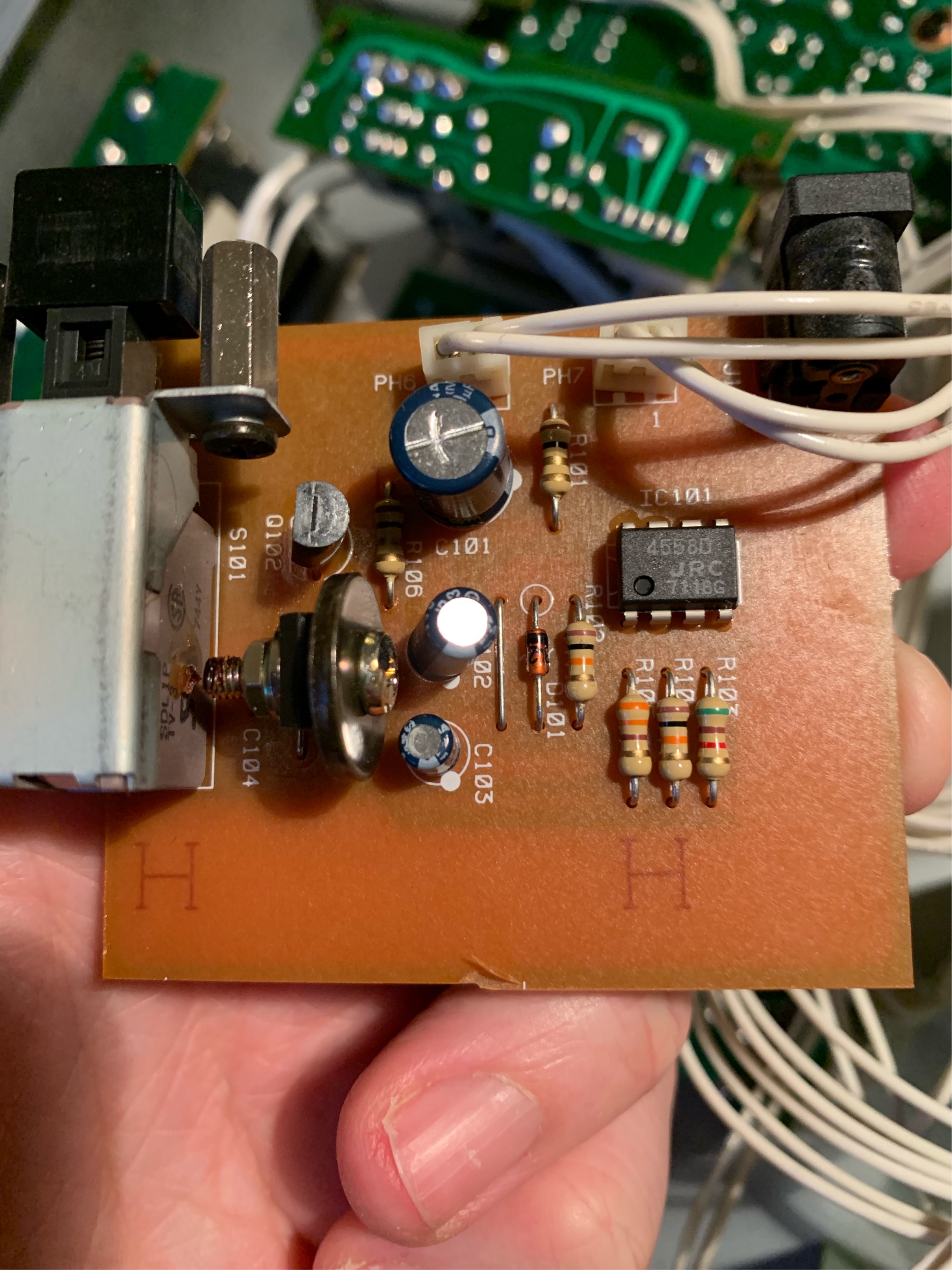

I got a Vestax 05 pro that does not turn on.

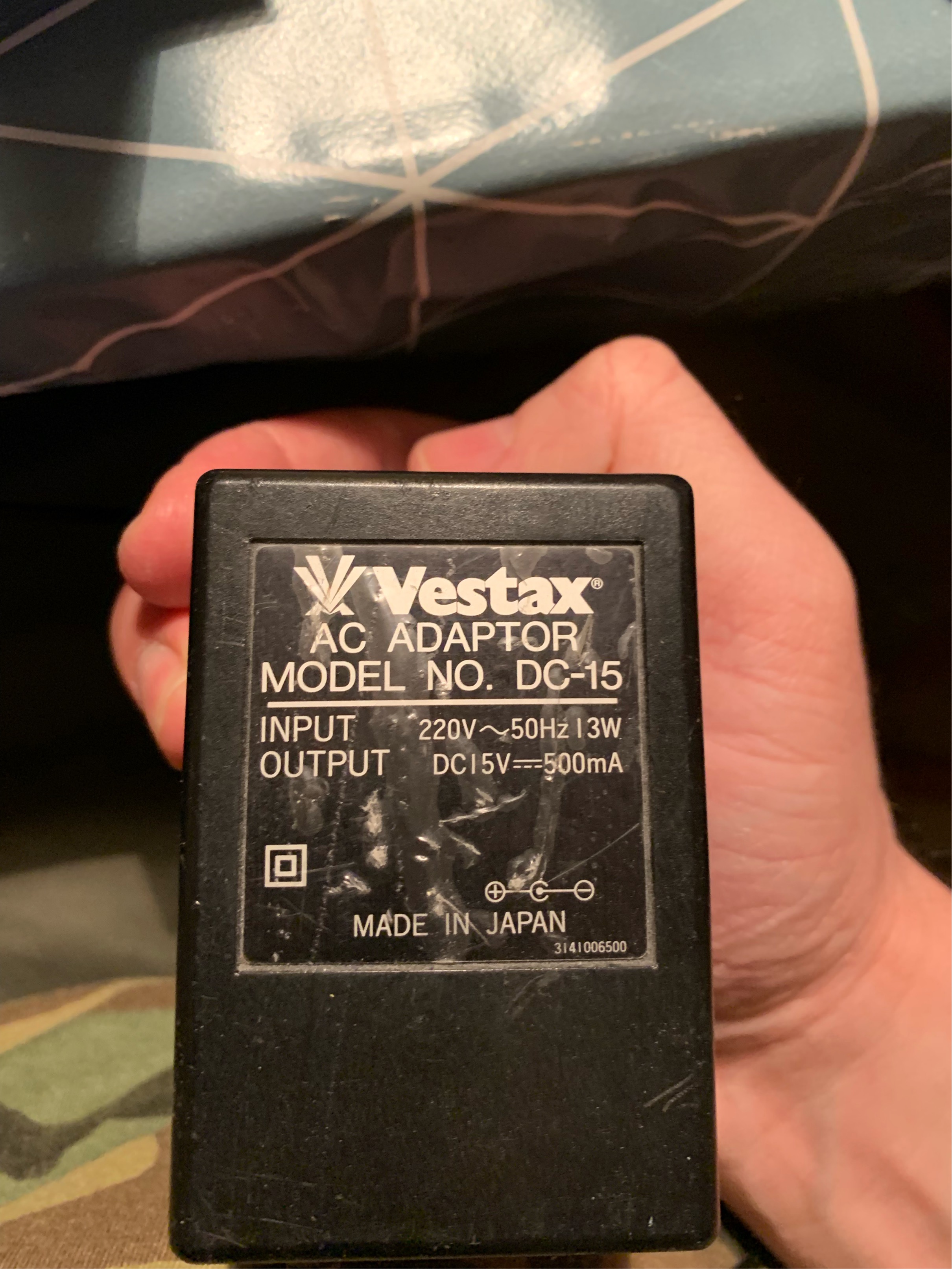

Previous owner told me it stopped working after trying using a different power supply. Maybe wrong polarity.
I got the original Power supply.
Spec says DC 15V. Output measures 22V.
I have another one exaclty the same and output on that is 19V.

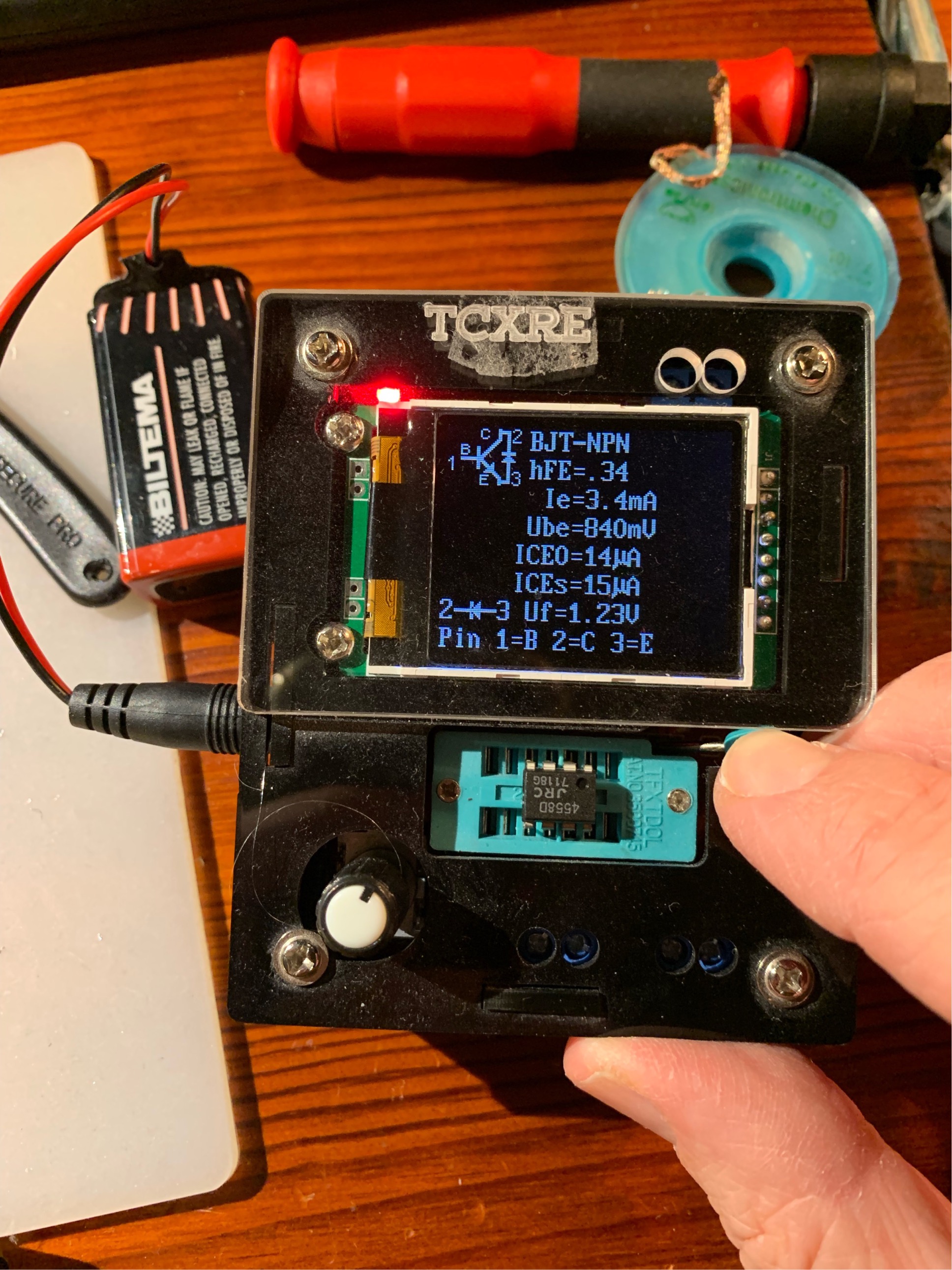

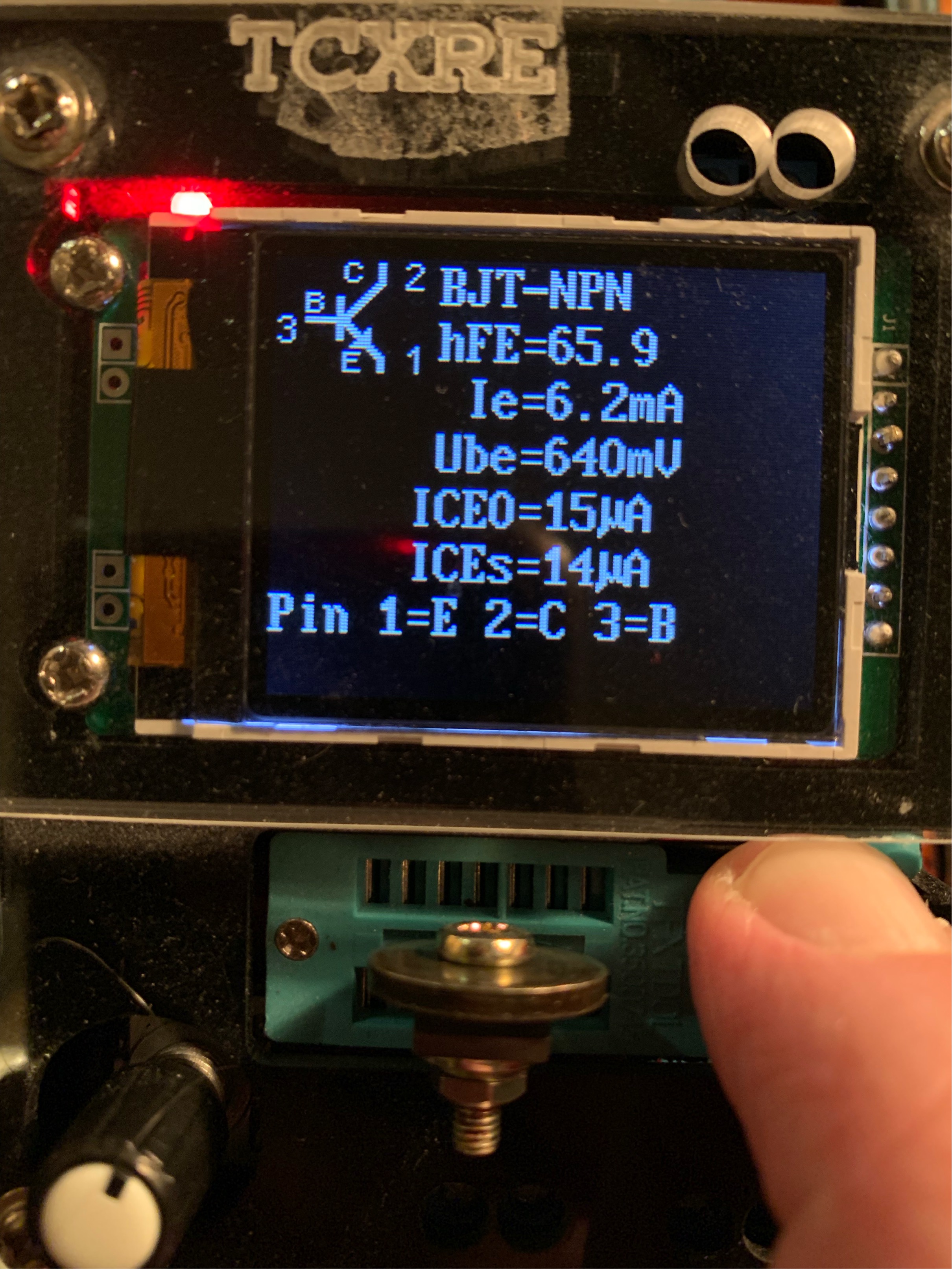

I desoldered:
Q101 and the component tester indicates:
Q102 same on that one:
Diod on the board seems ok.
IC 4558D desoldered and tested with a OPA2134 dual op-amp as a test replacement (only thing I had home).
Nothing above helped.

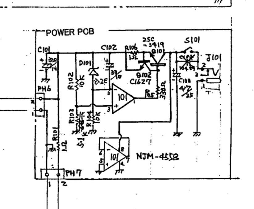

I only get 22V voltage on the red line in the
picture. No other voltage indications.
Any ideas what to do next?

PS has a negative tip. In my experience, a pos tip is much more common. Assuming that is what happened (i.e., former user tried it with a pos tip PS), would you suspect that the 8.2V zener (D101) would blow? Can you remove and test? Yes I am just guessing, but enough monkeys at enough typewriters....
This monkey suggests that IC101 is toast due to the reversed polarity of the PSU.
I measure 0.7v across diode in one direction and 0v in the other. Removed from board.
But why did it not work with the OPA2134?

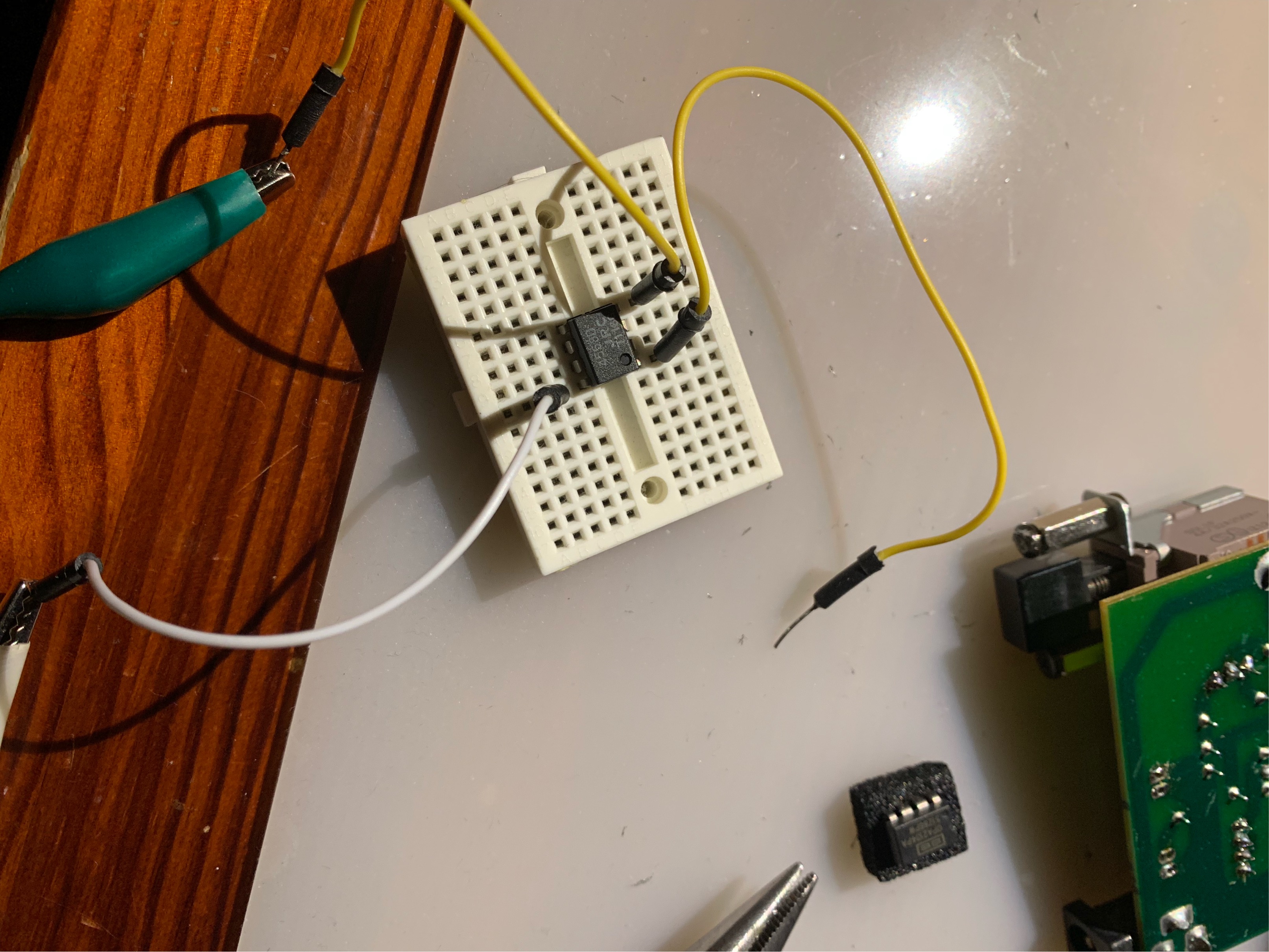

Tested IC101 outside the circuit. 0V on output feeding with the 15V supply.
Also tested the OPA2134 same way and that gave me viltage on output but does it does not solve the problem if I put it in the circuit.

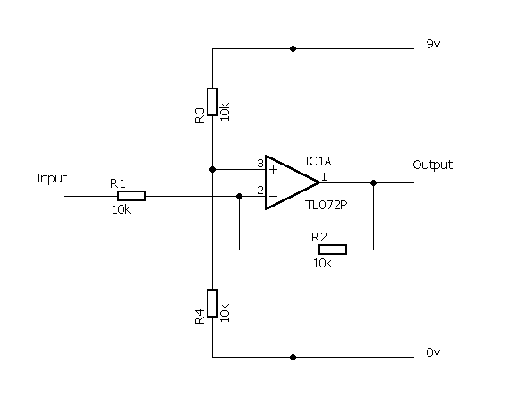

Rorut, what you are doing there is not going to be a reasonable test of an op-amp.
Do something like this:
If you apply a variable voltage to the input,
With the input at 0v the output will be around 9 volts.
When the input reaches about 4.5 volts, the voltage at the output will start falling.
When the input reaches 9v, the voltage at the output will be around 0v.
Depending on the op-amp type, if it is not "rail to rail" the output may not go below about 2v or above 7v.
But the idea is that you should be able to see a smooth variation in output as the input is changed.

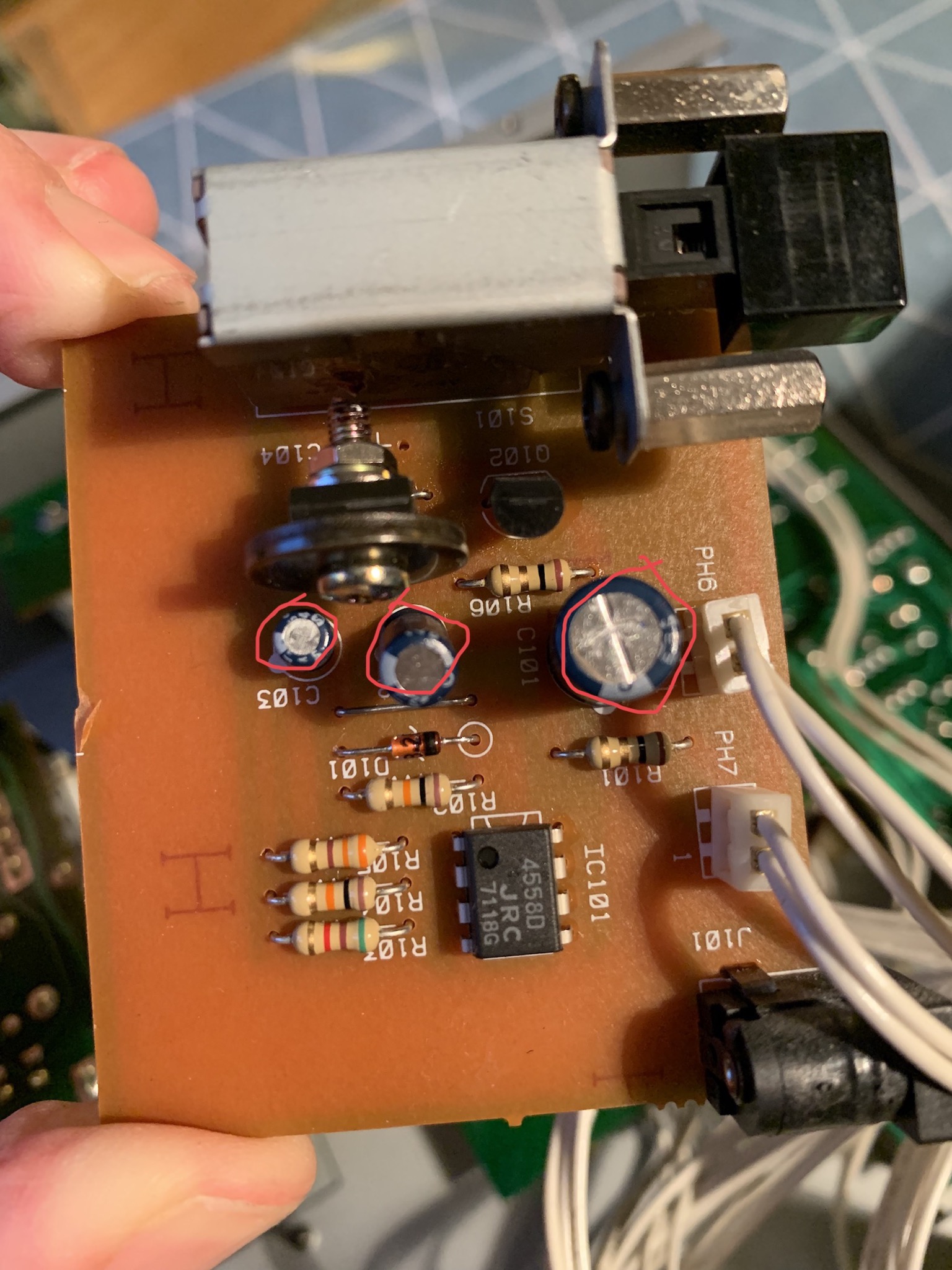

Tested the mixer again today and it will not start normally.
Discovered that it starts if you quickly press the power button several times.
Then once it has started and you turn it off, it starts if you test directly again but if it is switched off for a few minutes you have to repeat this procedure.
The power button measures voltage through regardless so it seems not to be faulty
Tested with another adapter and the same thing there.
I replaced the capacitors marked in the picture but that did not help.
The power supply circuits seems to be a bad design.
There is no absolute guarantee the opamp inputs will have any difference before the control transistors turn on, or enough to overcome any offset within the IC - and the IC must give an output for the transistors to start to turn on at all...
Try adding a high value resistor, eg. 100K, between pins 8 and 3 on the IC. That should put a small positive bias on the amp and make the regulator start.
It will fractionally affect the output voltage dependant on the input, but if it works a slightly more sophisticated add-on with an extra diode and a change to one resistor could fix it without side effects.

No other issues with the mixer. Previous owner forgot the power supply at home and tried a different one...
The mixer starts whithout any problems if I feed ph6 and ph7 with 12v computer PSU. Sounds great from both channels
Having the original psu connected for a while (until its hot) and then start the mixer there is only a couple of seconds delay and it starts by itself.
Maybe old/bad capacitors in both my oem power supplys i tested with?
