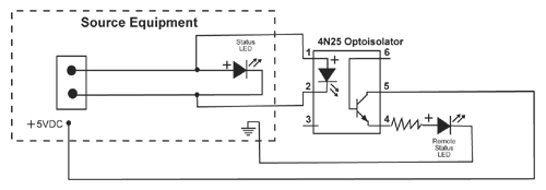

However, I am thinking something like the above may work more reliably and we will not have to worry too much about voltages.

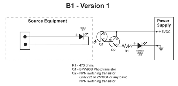

I like the idea of the phototransistor as well and will do a quick circuit layout of it later tonight.
The idea of using an opto coupler is good, but...
Connecting the LED of the opto in parallel with the status LED is a bad idea.
If the two LEDs operate at different voltages, then one of them will not operate correctly.
Try connecting the opto in series with the status LED, or simply replace the status LED with the opto.
Also, if I were doing this, I would not run the +5v supply from the "source equipment", out on 100 feet of wire.
I would have a separate supply for the remote LED.
That way there is no possibility of the long leads conducting "noise" back into the source equipment.
Very good reply jimB.
We could use the source led and a phototransistor. This way we would be dealing with a known voltage all the time of 5 VDC. The circuit would be very reliable and most likely work in all cases.
In addition, your point about the noise is something I did not think of.
I have done a prelim circuit picture of this above. I picked the R1 value out of the hat. I chose Q1 because I believe it is sensitive to visible light. I added Q2 to boost the output. Did I do good?
In the meantime, does anyone know of any phototransistor examples which would apply?
