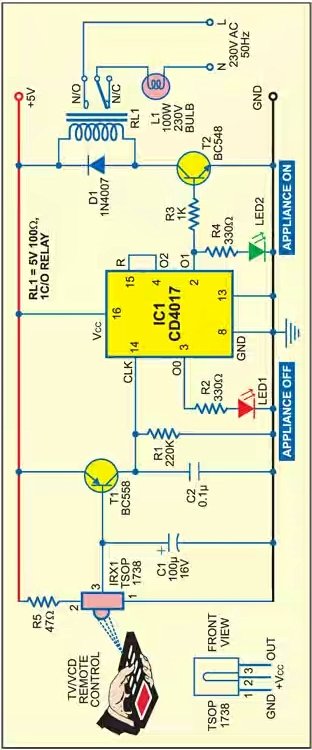

I am designing a circuit for remote controlled operated switch for the household lighting, circuit is taken from efy projects.
I am using 5 v DC supply for the circuit, here I have some questions regardin the circuitory,
Here I have to put a transistor BC 558, can we use a transistor BC 548 in place of BC 558, if not thenwhat are the effects if I do So??
If this is the circuit YOU designed then I do not see why you need to ask these questions. To use an NPN transistor in place of a PNP transistor would require re designing that part of the circuit. As the IR receiver you have chosen is designed for a 38 KHZ carrier then it will only work with remote controls that use that frequency.

No, you can't use a BC548 (it must be a PNP type). Alternatives include 2N3906, 2N5807, BC557, BC857 etc.

I would think a 2N3702, 2N3906, BC557 or BC327 should work. While looking at the data on the TSOP1738 I noticed that the maximum output current rating is 5 mA There is nothing in your circuit to limit the output current. I would suggest adding a 1K resistor from pin 3 of the TSOP1738 to the junction of C1+ and the base of T1

I do not believe that this design uses any coding. The 100 uF capacitor C1 will filter out the normal codes sent by the remote. I think pressing any button (Probably longer than a normal press.) will toggle the power on and off. This is my understanding of how it is intended to work. Any burst of infra red will pull the output of the TSOP1738 low (As C1 will filter out any fast pulses.) This will turn on T1 causing the clock signal to the 4017 to go high which will step it to the next state. If it is in state 0 (Output off.) then it will step to state 1 ( output on.). If it is in state 1 it will step to state 2 which will cause a reset to state 0 (As output 2 is connected to the reset input.)
Edit. I cannot see a link on your circuit between pins 4 and 15 of the 4017. Also a picture taken from directly above the board would help.

Correct, it is a simple envelope detector and the equivalent of a toggle flipflop. The chip has an internal 100K pull up and an NPN output transistor. 38kHz bursts discharge C1 until T1 turns on and presents a positive edge to the 4017 clock input. T1 turns off at around 4.5 V, or 90% of Vcc. 95% would be three time constants (30 seconds), so how soon the circuit will respond to another button push depends on how long the last one was. After a long received pulse the circuit will not see another valid input for about 30 seconds.
There should be a 47 uF decoupling cap from pin 2 to GND.

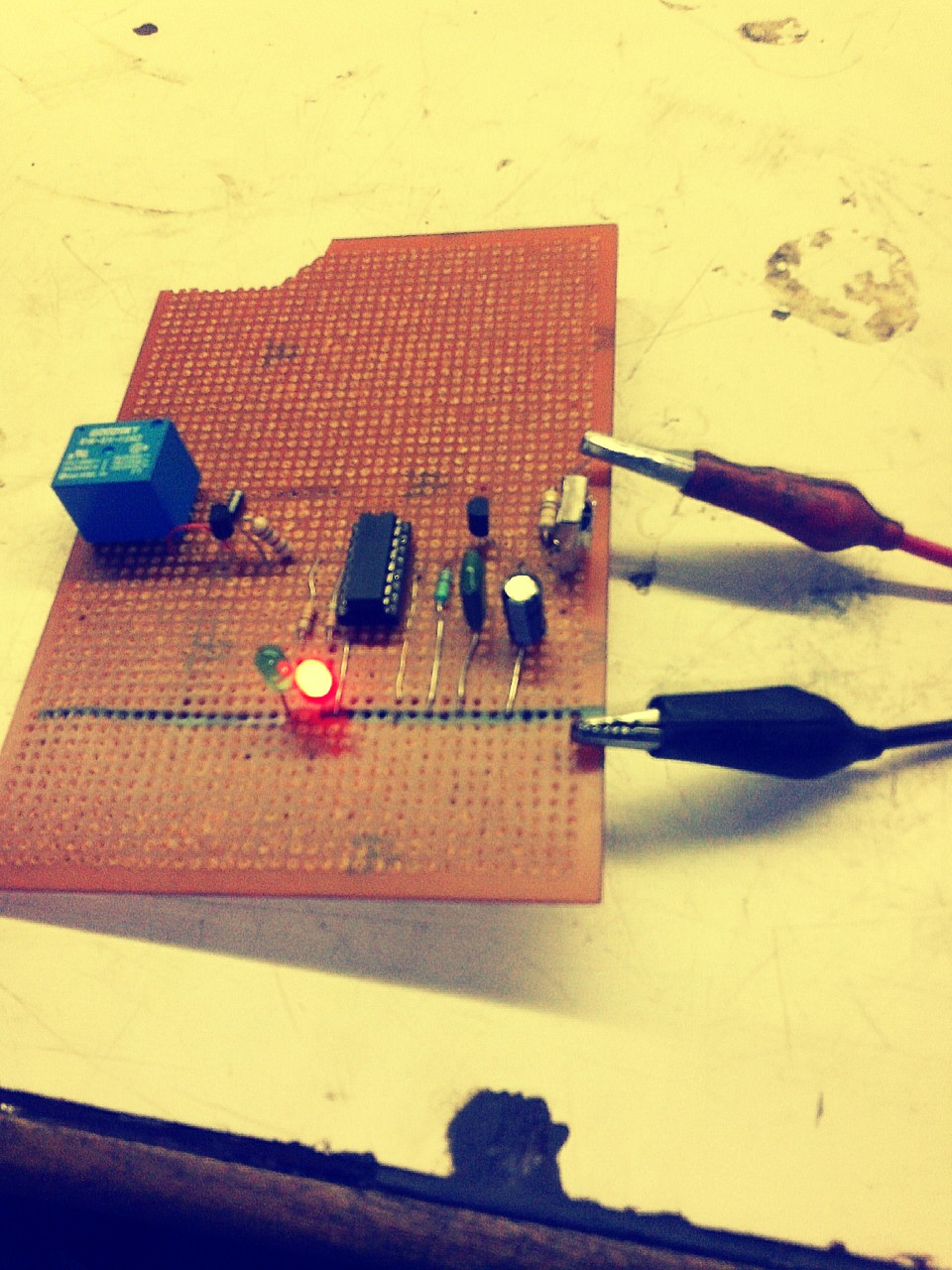

I have completed the circuit .. but output is not coming from pin no.2 of the ic ..
I have used
Ic 4017BE
please help how can I make this in working condition ...
Les .. plz help..
