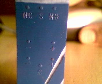

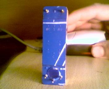

i need info on this conponent i dont know weathe it is a tilt swich or a relay
i says this way up.
and it is called: mercury wetted contact relay i have a few pics
It is "exactly what it says on the tin", a mercury wetted contact relay.
The relay contacts are in a sealed envelope with a small quantity of mercury, which helps to give good contact at the relay points.
They should be mounted with the arrow to the top so that the mercury forms a pool in the correct place in the envelope.
The pins:
C Common contact
NO Normally open contact
NC Normally closed contact
+ positive side of coil
- negative side of coil
The relay probably has a protection diode across the coil to kill the back EMF when the coil is de-energised.

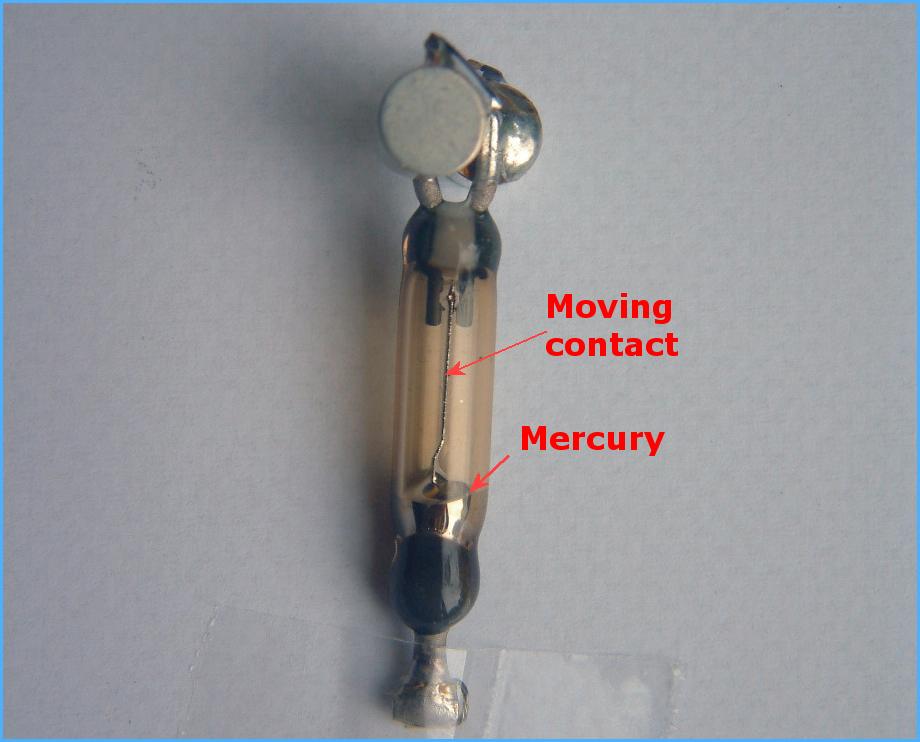

The image shows the inside of such a relay after removing its casing and taken out the magnetic operating coil.
Shinny mercury coating can be seen along all the surface of the moving contact.
These contacts are usually for fast signal switching purpose where contact bounce is a problem. You can see from the image that large cylindrical metal block is attached to each fix contact at the top to absorb the energy that the moving contact carries when the contact closes.
Nice picture.
That is the first time I have actually seen what one looks like inside.
Note the contact point is the tiny bits at the bottom of the semi-circular depression on the fixed contacts in the image. So it is really tiny and not meant for a lot of current.
The nice thing is mercury will climbs up the moving contact and "wets" the contact point.
