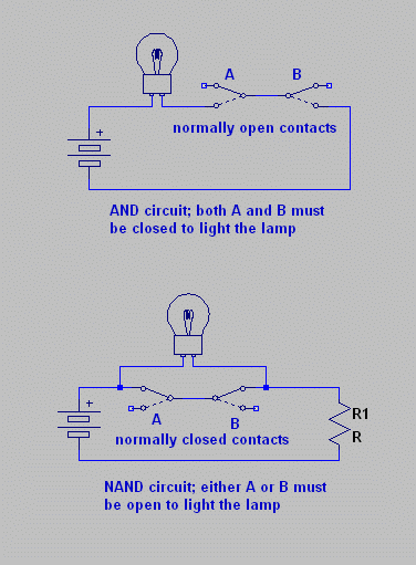

I’ve just joined the Forum so hope that this is the right place to ask my question! It's a question about relays, not semiconductors.
I retired twenty years ago (so my knowledge of modern components is pretty vague) but worked all my life on relay logic circuit design (mainly 12v, 24v, 110v DC circuits), however, I’m more than a bit rusty.
I did, on occasion, work on semi-conductor design but the industry I was in wanted mainly relays.
My son has asked me to design and build a NAND gate and an AND gate using just relays, with lights or whatever, to demonstrate how they work. It’s for pupils in his Computer/Electronic classes at the local school.
I, of course, said “Yes” (!?) – then realised just how rusty I’d become but I don’t like to admit it!
Could anyone, please, give me designs for the two gates and give me details of relays (and anything else) suggestd? If I could build these gates, satisfactorily, I would lie to my son for a few days and, then, tell him the truth – someone designed it for me – but, for those few days ....Glory, just like the old days!
Thanks,
John
To clarify, you want to show how to build NAND and AND gates from using only relays?
If so, you are talking old school relay ladder control system electronics.
Since the input(s) are likely to be toggle switches, you can just use the switches directly without any relays.
Yup. Battery -> switches -> light bulb or LED.
Two switches in parallel = OR gate.
Two switches in series = AND gate.
Or, two switches can go individually to SPST relays.
Two contacts in parallel = OR gate.
etc.

The only word I can think of is ....blimey! Look at all the answers I've got! Thanks to you all. Yes, I can see now what I need to do, now. I'm surprised that I had forgotten something as simple as this - - but I genuinely had! Stupid! But it has been 25 years since I actually did any DC logic control design and I used to love it -- going to work was a pleasure.
But, at least, I think I've found a new hobby. I shall be back to this forum looking for ideas as to what to build next.
Brilliant! Thanks to all. I really am delighted.

Just out of interest, I've drawn simple circuits using just switches. I thought, why use a switch to operate a relay which only closes or opens a contact when that's exactly what a double throw switch does. Making them DPDT switches I can use LEDs to indicate the switch positions.
I've been asked to do the same for the NOT, EXOR, and EXNOR gates and, thanks to all your help, I reckon I can do that myself. If I can't I will come back!
