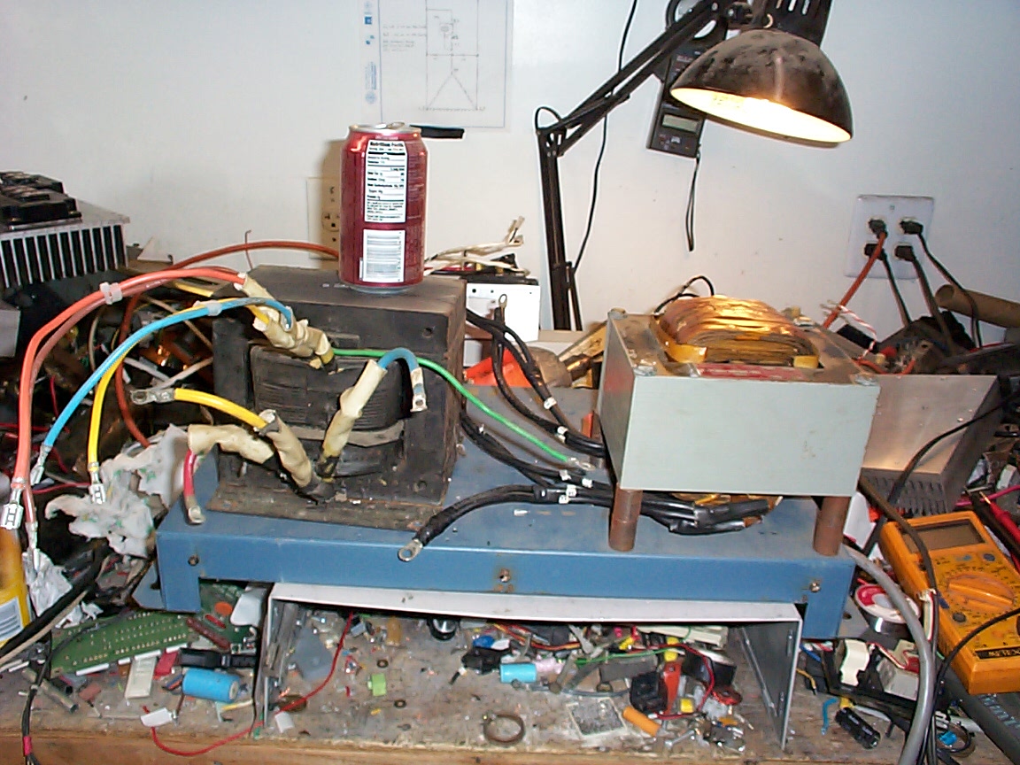

I am fixing a 24 volt 120 amp golf cart battery charger supply right now.
The guy just dropped it off about an hour ago!
The transformer is around 35 - 40 pounds and the whole charger could be reduced to a 1 foot cube and weigh under 50 pounds if really need be.
The old transformer growls horribly and he wants me to change it out. The one it uses is a common 120/240 input to a 48 volt ct type. and its not a ferro resonant current limiting type either.
The actual open circuit DC is around 34 volts. It's rated to hold 28 volts at 120 amps.
I am switching it out with a 24 VAC 3 KVA buck/boost transformer. I just need to switch its DC side from a duel half wave bridge to a full wave bridge.
The control circuit is a simple voltage monitor. When the voltage gets over 28 -29 volts it disconnects an SCR that bypasses a big 3 ohm resistor. The resistor gives it a low current trickle or float charge.
It's old but well built, and the guy says it has never had any problems charging golf carts back to back all day! He picked it up from some golf course that he frequents that was clearing out old stuff.
They told him it worked very well for many years but it just started growling so bad it made people worry that something was wrong with it!
He had it in his garage mounted to a wall for a few days and he said he could here it hum through the whole house! The wife said fix it or trash it!

Here is a picture of the actual charger system all taken apart. I used a pop can as a size reference.
3 KVA is physically not all that big. As transformer core dimensions go up the VA per inch of cross section goes up too!
A 10 VA from a wall power pack may only have a 40 - 50 VA per square inch capacity. But large ones like these can easily equate to a 150 VA per square inch of core area.
The old transformer is on the left. It still works good but it does have a horrible growl. I may try re varnishing the windings and core to quiet it down some. If not I just got a good 10 pounds of copper!
My old bathroom scale says the old transformer weighs 43 pounds. The new one is slightly smaller but still rated the same KVA wise.
The output leads on the new transformer are doubled up 6 Gage. And the bridge rectifier I am using is a standard international rectifier 150 amp full bridge. So yea I am pretty sure its not a 12 amp!
