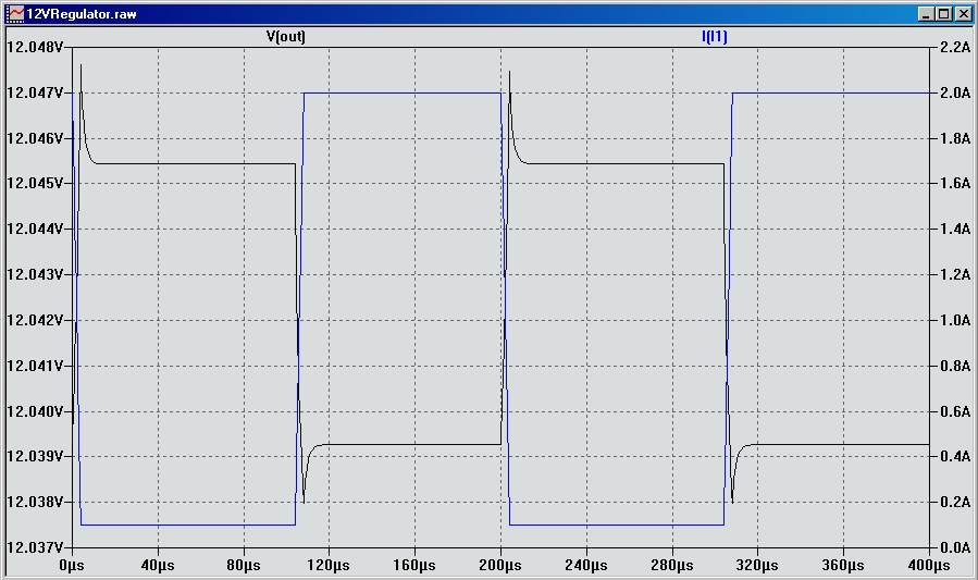

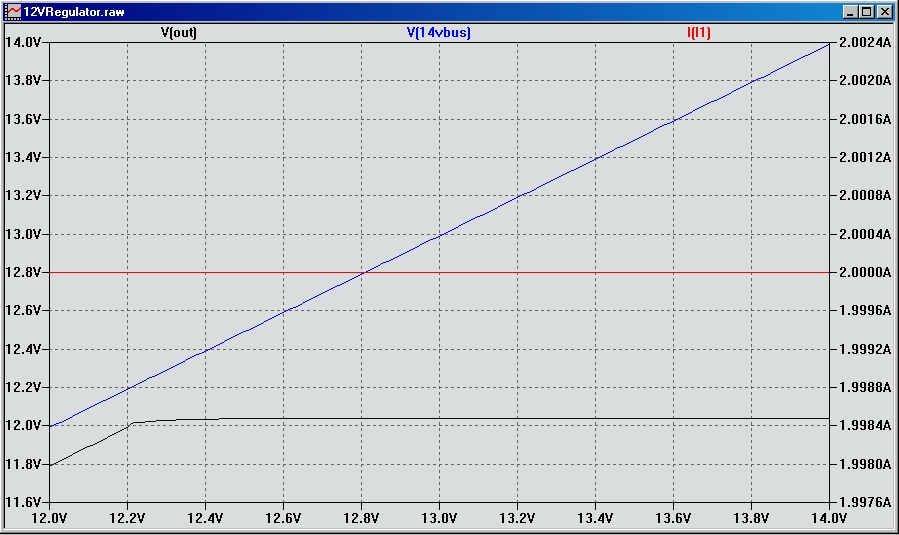

Here is my home-brew Low Dropout Regulator. Parts should be relatively easy to obtain. The PFET is not particularly critical. The PFET dissipates up to 5W, so it needs to be mounted (using an insulating mounting kit) to something metallic, like the car body.
There are two plots shown. The first is a sweep of input voltage from 12 to 14V. Note that the min. drop across the PFET is only 200mV at 2A. The second shows the dynamic recovery of the regulator as the load current switches from 0.1A to 2A.
