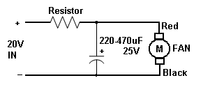

When adding the capacitor is there an order I should be aware of when connecting the parts? Positive to resistor to capacitor to fan? Or positive to capacitor to resistor to fan?
The resistor can go in either the positive or negative lead. It doesn't really matter, but tradition puts it in the positive lead. The positive lead of the capacitor goes to the positive lead of the fan. The negative lead of the capacitor goes to the negative lead of the fan. Like this:
220 uf capacitor is the size found in power supplies for whole computers. If your 20 volt supply is large, then its capacitor might be that massive. No readon for a cap that large.
I never needed a a capacitor to reduce fan voltage. Keep it simple. Do it without a capacitor. Later get curious. Touch a 1 uf, 0.01 uf or a massive 10 uf cap across the fan to learn - to discover what changes.
It is not there to reduce voltage. It is to keep the ripple on the supply to the fan controller at a manageable level. A computer fan doesn't use a simple DC motor with a commutator, but a complex electronic drive circuitry.
