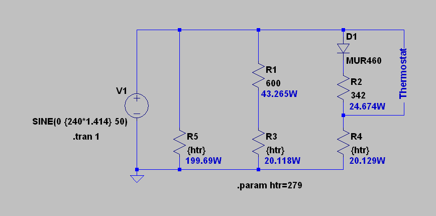

Mike I had to read your suggestion about 4 times before I understood it, what a good idea! You didn't attach the attachment for your test case though.

Mr Al, the iron was sold as a 220v one, but when I looked inside the handle there was a diode in series with the element, implying it was really a 110v element. The replacement elements (pack of 2) were sold as 220v elements, implying they are intended for AC use, but when I turned off the tc (I have added an override switch to the station) I watched the temp climb up past 600 degrees before I turned it back to being controlled. The iron was originally sold as 40W (though don't think it really was - no power given in English on the the pack) and the replacement elements are sold as 35W
I did wonder about a diode in parallel with a resistor and a small capacitor, in series with the element (which on examination is just fine wire wound round a ceramic core, and inserted in a ceramic tube.)

So next on this experiment, if mains "softening" doesn't work, I'm going to try to make a 24v 2.5A hfac supply, so I can put a 24v element in this handle.
