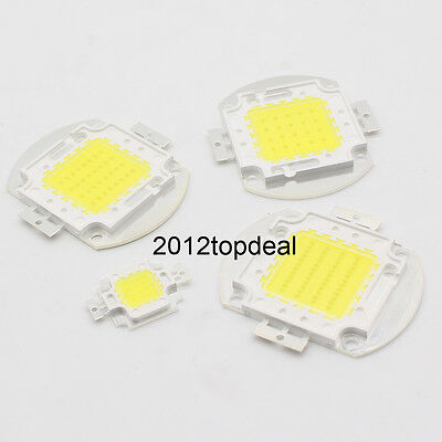

The LED is designed to be used without a driver as long as voltage is 12v. Typical power is from 12v marine battery or sealed lead acid battery (8Ah). The problem has arisen when using a high amp automotive alternator that is putting out 14 volts to the battery that powers the light. When used with only 12v battery, no problems, but the 14v is destroying the LED.
I disagree. I cannot find a data sheet, but I am certain it was no designed for a 12V power supply. It does have a Vf of 12V +/- some amount.
Looking a similar part. 12V=4.5A as tested by you. 15V=7.5A, from data sheet 9.5V=0A

They do not require a driver... I have used this same LED as a marine boat light (photo below) without any issues as long as battery is 12volt. One boat has been in use for several years with out problems, however it is running a lesser output alternator (Delco one wire 65 amps). I do agree that a 4A constant current 12v LED driver would cure the problem
Here is same 12v LED currently sold on eBay:

Those LEDs are supposed to be used with a driver. You may have got away with it on the boat, but at 4.5 A, you only need some long wires to limit the current like a resistor would do.
To drop 2 V at 4.5A needs 0.444 Ohms, but increasing the resistance will only dim the LED a bit. I would suggest somewhere between 0.5 and 1 Ohms, with one resistor per lamp. The resistor will get hot, so use 25 W resistors or larger, bolted to a heatsink.
