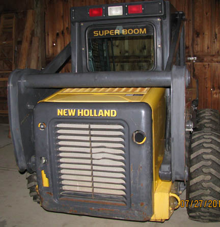

I have recently acquired a small, used skid steer. It is quite useful around the "farm." Problem is that I am too old to turn in the seat to see what's behind it. Apparently, I am not the only one in that predicament. If you look at used skid steers, you will notice that many of them have the grill in the back damaged. Here's a picture of the way mine came:

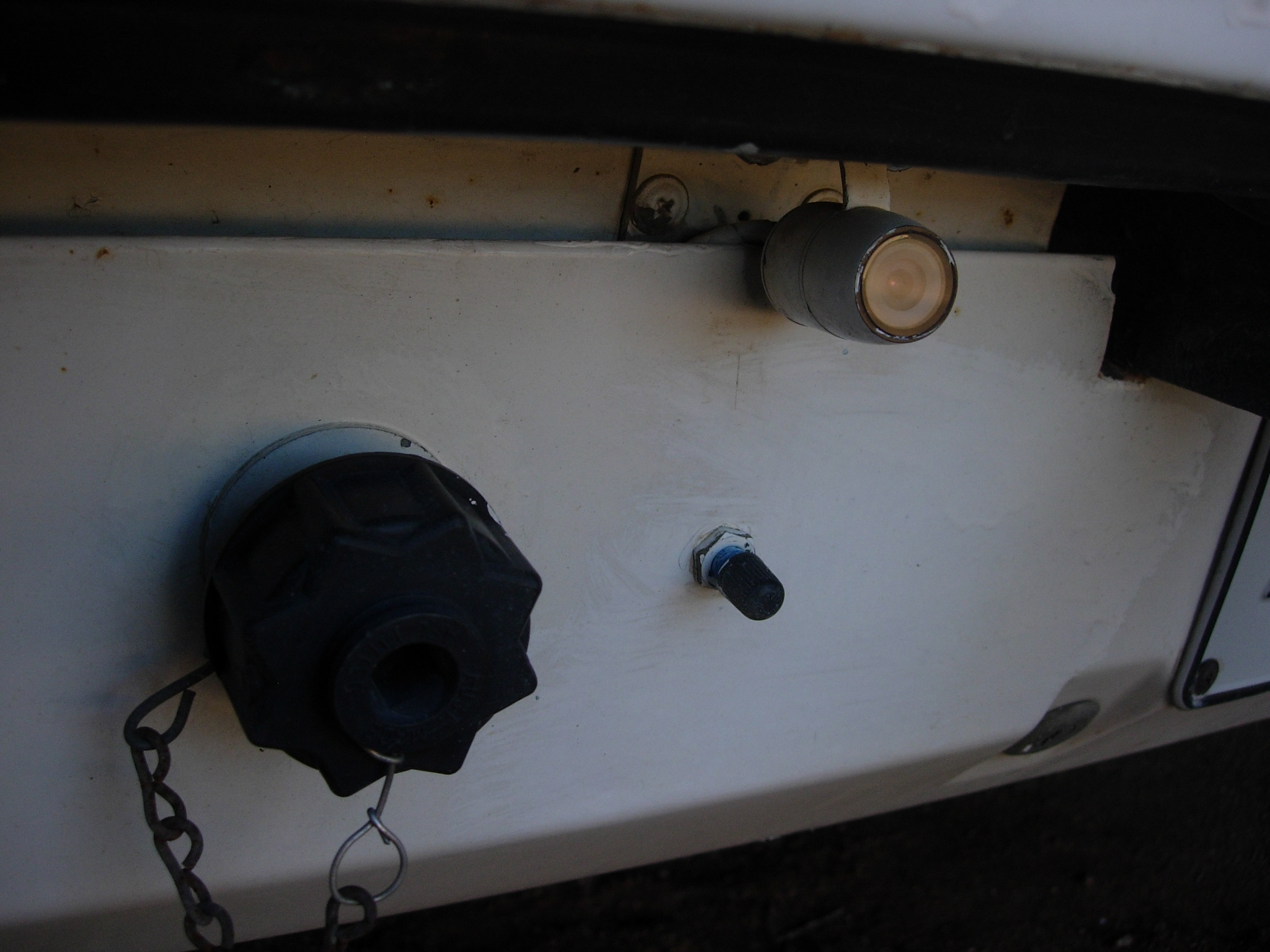

My comments are based on the camera which is fitted as standard in my 4x4 (SUV).
I would put the camera right at the back, between the O and L in Holland.
This will give good visibility right at the back, allowing you visibility of the last inch before hitting something.
The camera will be easily accessible, it will get dirty and need cleaning sooner or later.
Much easier to wipe while walking past the back of the loader than reaching up to the light bar.

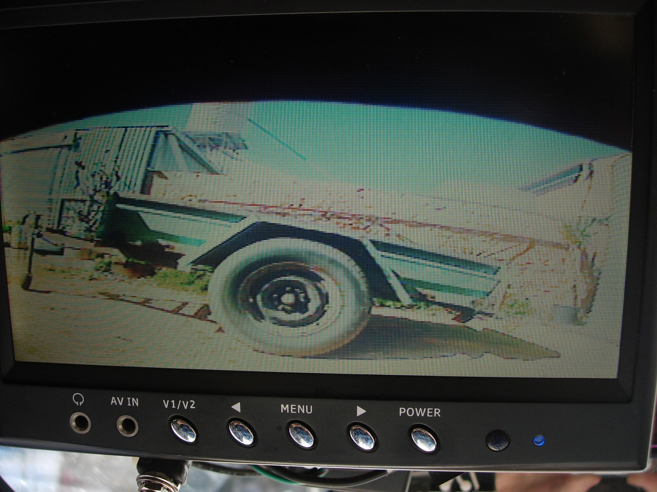

I use this on my Panel van as its hard to see out the back, & also for reversing onto trailers. Camera is an Ebay $12 free freight. The screen in the pic is a 7inch screen, but have used 4.5inch screens on other vehicles & they were $35 freight free on Ebay. The lines aren't on the screen just in the picture from my camera.

Nigel: I can assure you I won't be using glue for the monitor. :D Skid steers are a rough ride. There are actually some screw mounts on the operator's cage for an accessory that I don't have. I may end up using them. Some of the aftermarket units provide lines to indicate distance. On looking at debe's post, I just may get that option. It can always be turned off. That is the reason I mentioned capturing the rear wheels of the skid steer. My monocular depth perception is not good.
JimB: The mounting location you suggest is good advice, particularly after looking at debe's picture. I had considered a round camera with tapered rings to adjust angle. Now, I think I will get a camera with a bracket mount. That can be mounted easily to the rear radiator door basically by using U-bolts and without drilling any holes.
debe: Thanks for posting an actual picture. Clearly, I will need some reference for distance. I also need to re-evaluate whether a 7" screen will fit. The factory units at my local implement dealer all have the larger screen. Of course, the price is about three to five times as much as for non-branded units. I have a spare headliner for the machine. One option is to mount a larger screen up there.

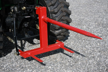

Thanks. I not worried as much about walls as backing into something like a bale spear:
Ouch. For that, I trust my vision. :D
John
