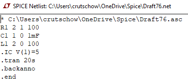

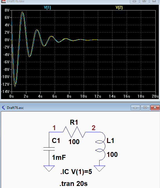

I haven't worked from a Spice netlist in at least 20 years, and if you are still using netlists in your electronics course you are well behind the state-of -the art (unless you are using it just to demonstrate how Spice internally describes a circuit) .
So below is the LTspice simulation from the generated schematic with its attached .asc file.
The netlist generated from the schematic is below the schematic.
  • Draft76.asc

Hi
If you've used many versions of spice, you would know that all spice's are not created equal.:)
The "Run:missing node(s)" message is due to LTspice's interpretation of the unsupported statement "run" as having no connecting nodes. :cool:
Its interpreting "run" using its leading "r" as a resistor with no connecting nodes.:)
While LTspice is somewhat PSpice compatible, LTspice does not support .control, .endcontrol, plot and run statements, so you will need to comment those out.
See below.
R1 1 2 100
C1 1 0 1mF
L1 2 0 100
***End netlist
***Specify initial condition (5V at node 1) with .IC command
.IC V(1) = 5
***Perform transient analysis
.TRAN 0.1s 20s
***Begin control block
*.control
*run
*.plot V(1) V(2)
*.endcontrol
***End control block
.end
