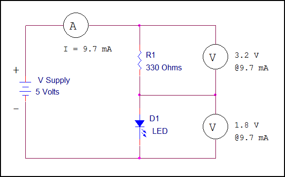

Where's the schematic?
I am new to this forum and do not see any diagram of the posters LED circuit. Are you guys telepathic:) or am I missing the circuit?
Bruce in the Peg
You need to see that
5v->anode[led]cathode->resistor(330ohm)->0v
is the same as
5v->resistor(330ohm)->anode[led]cathode->0v
(series circuit)
then it will be obvious :)
Cartoon provided. :)

NO not really. The idea is the LED and the resistor both have a voltage drop and those drops are additive in nature. So if I drop 1.8 volts (LED) and 3.2 volts (Resistor) I have the 5 volts I started with. We can't change the value of the LED short of a different LED but if we change the value of the series resistor all bets are off. :)

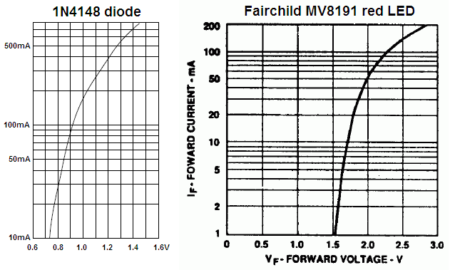

The forward voltage does not remain the same. When the current is increased then the forward voltage rises a little like any diode does.

Ok, so the voltage does go up, but not by much.
From the graph, 1.5 V to 1.8 V as the current goes from 1 to 20 mA. That is about 15 Ohms. For a first approximation, which is probably good enough for a lot of applications, that 15 Ohms can be ignored when there is a 330 Ohm resistor in series.
The current is a function of the voltage, and the voltage is a function of the current.
That is because the voltage - current curve has always got a positive slope, and it doesn't have hysterisis.
The graphs happen to be drawn with the voltage on the x axis, but they could just as well be drawn with the current on the x axis. I don't see that either is necessarily the dependent variable.
The slope can be measured in ohms. I reacon that it is about 15 ohms, give or take, in the 1 - 20 mA range. It will be very different at other currents.That is 5% ish of the 330 ohm resistor.
