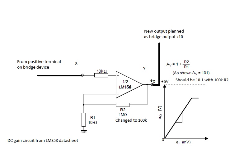

Hi again guys,
Well I have done what I thought was right and built an op amp circuit. I actually did the one for a none inverting dc amplifier from the LM358 datasheet.
When connected to my bridge I get strange readings from the output of the op amp. My bridge is a 1A one and when I check its output with a 0r47 resistor the DMM across the bridge output shows .47v when I check this against the output of the op amp I expected to see 100x0.47v or 4.7v but I got 5.35v instead! I then thought that the output may be better with less gain and changed the gain resistor of the op amp from 1M to 100k which I thought may be better in the long run as I would then have a bigger scale that I could test with the circuit, as in fro 0 to 50r instead of 0 to 5r. But the results were similar only obviously smaller with the r47 giving .53v at the op amps output.
A little about the bridge circuit and op amp. I am powering both from a SLA 12v battery for test purposes ( I wondered if this was enough headroom for the op amp?)
I intend still to use a PIC12F628a or similar as a voltmeter with an LCD display and build it all into the same box for convenience sake.
Can anyone suggest where I'm going wrong here?
Help appreciated, Al
PS I have checked and rechecked the circuit and it is exactly the same as the one posted below.

I think thats a little too high a fb resistor, you'd be better with a 1k and a 100k, or as you say reduce the gain to 10.
Also is the ground side of r1 a proper ground, ie its not subject to volts drop caused by the load.
The lm358 can go to almost ground, but needs around 2v or so clear of vdd.
If you want to go rail to rail an lmc660 is worth considering, there is a single version too.
