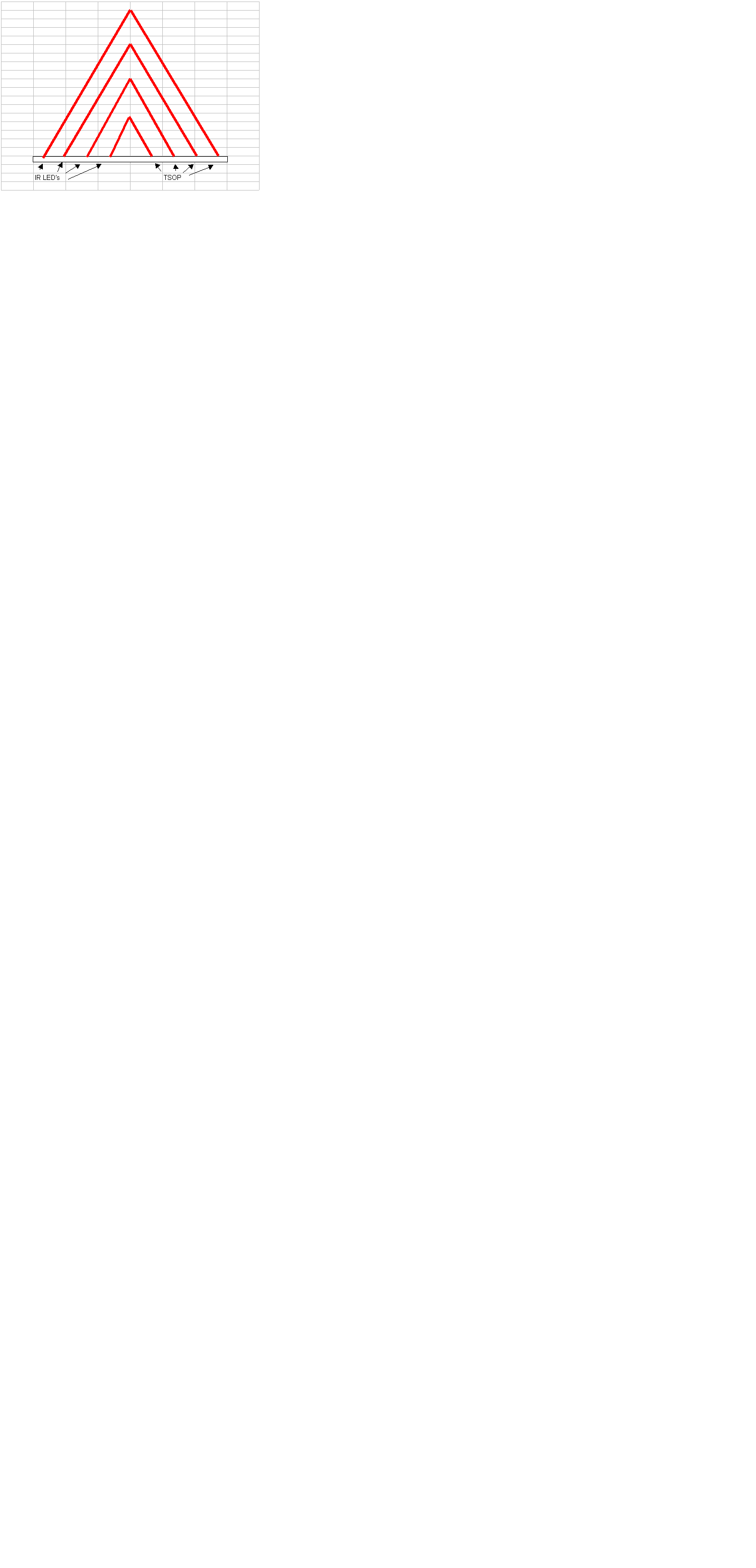

IR Driver
Is this what you need?

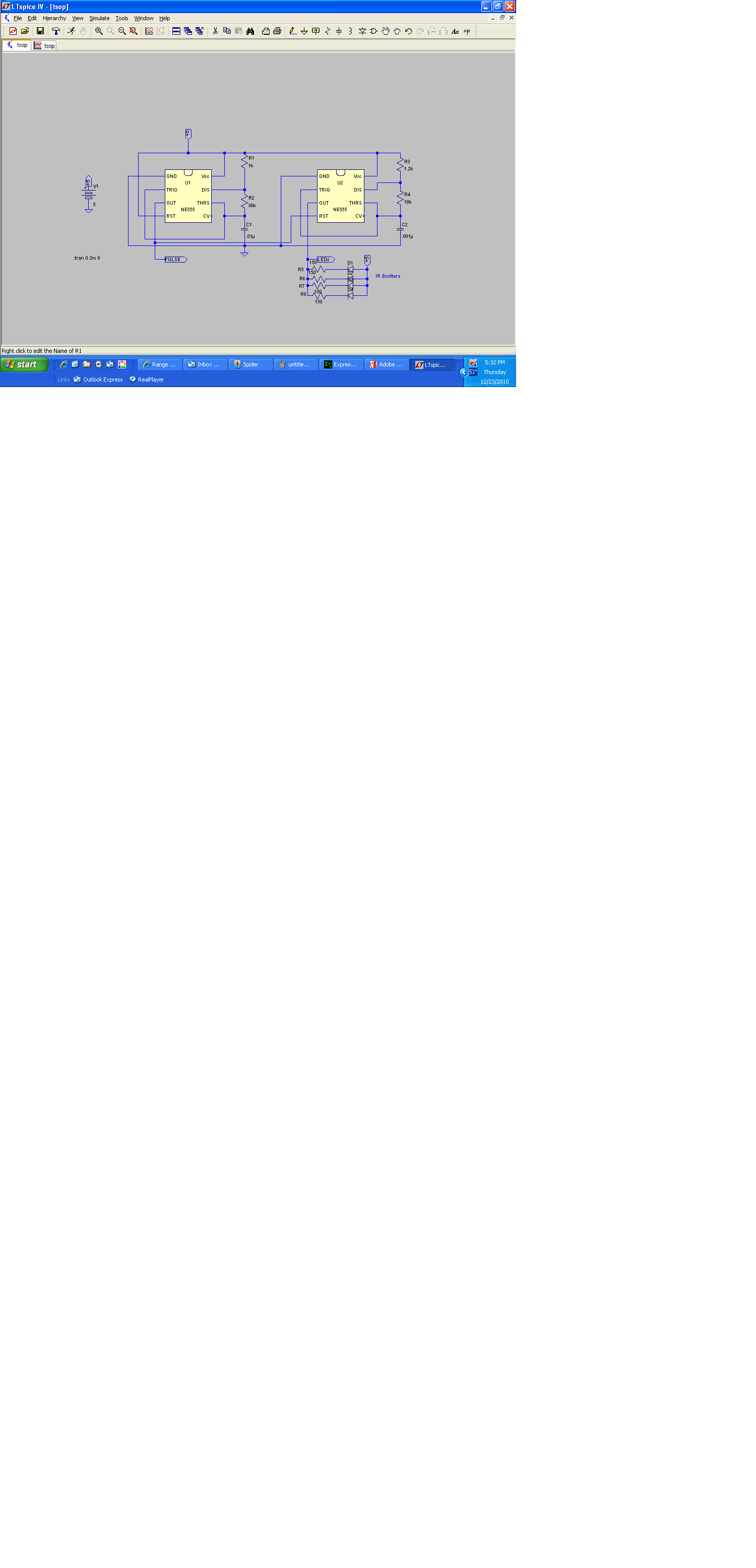

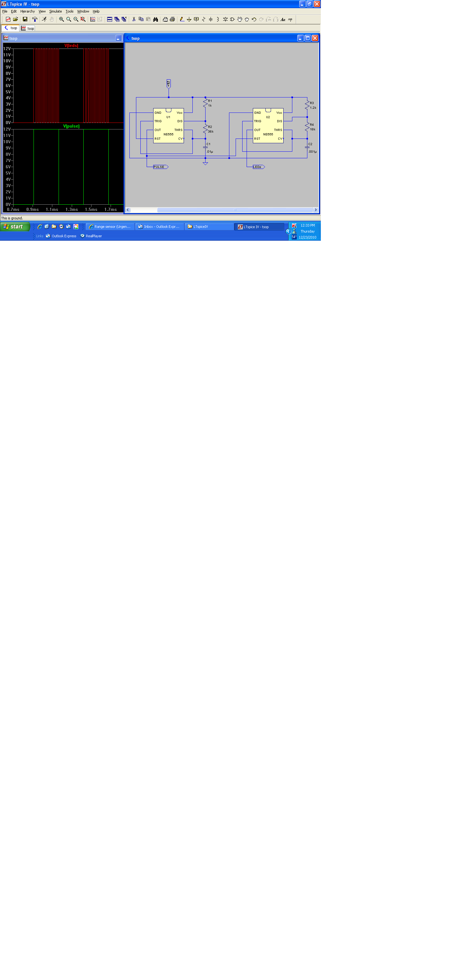

Distance sensor
Here are some more circuits. If I understand correctly the 4 leds should come one when the "wall" gets to each distance. This is one way I think it might be done. Make sure to shield both the sensor and the emmiter from each other as the TSOP is very sensitive.
The 555 circuit is the transmitter and the other the TSOP receiver.

Use only 5 volts to make the tsop happy. (like last set of drawings)
38khz
Not as good as the timers, but it should work. If it needs to run off of 3 volts you will need a different FET.
Yes, but the circuit won't have much power to drive the leds so you may need more circuits for your project to work.
