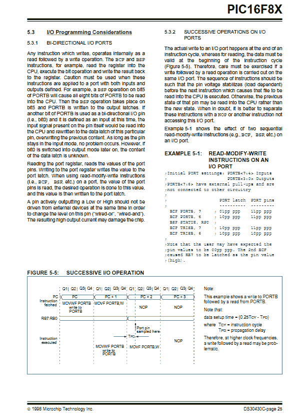

It happens to a lot of people using 16 series PIC. Ever heard of Read-Modify-Write limitation regarding port pins?
Consecutive BSF, BCF, BTFSS, BTFSC, RRF, RLF and other commands on port direct will absolutely be asking for troubles. The first instruction changes port pin(s) status, but pin(s) level take time to change if there are capacitance connected to it. When the second instruction read the pin status, the wrong status will be read.
Solution: Use a port shadow register or insert several NOPs between port change instructions.

Never hear of the Read-Modify-Write limitation, do you mind pointing me to any documents/articles relate to it?
Also, what is port shadowing? And do you mean put a few NOP each time I change a bit? Reguardless weather that bit is input/output?

I'm glad that your problem is solved. But the issue of Read-Modify-Write might come back to haunt you, when you are least expected. You can type that phase in Google and get lot of hits.
It was mentioned in the 16F84 datasheet but got deleted in the 16F84A datasheet so you might not have seen it. Why it is deleted I have no clue because the problem is still there. The insertion of NOPs is to give time for the pin to attain the correct logic level and depends on what is connected to the pin.
A test by one user in the Microchip forum using just a 0.1uF capacitor on a port pin reveals it could take 10us or more for the pin level to match with the port latch. Within this time, there can be many PIC instructions and any read port instruction would return the wrong logic level.
Port shadowing is to set aside a register to store the port bit and we change the bit value of the shadow register instead. After we made the change, the register value can be outputted to the port.

Thanks for the info.
Would this only matter when doing a bit test on a input pin? Would the solution be put 10 NOP instructions before and after testing a particular bit?
No. Not limited to bit testing as RMW effect is present in all instructions which change the port pin status. So BCF or BSF are also such instructions. The key element is "Sucessive" operation on the "Same" port.
LOOP2
   movwf BIT            ; Move Bit
   andwf CMDOUT,w         ; Is CMD high?
   skpz               ; If not, skip next command
   bsf PORTA,1            ; Set CMD bit high        <<<<< OK
   bcf PORTA,3            ; Clock Low               <<<<< possible RMW problem
It is difficult to tell whether 10 NOP instructions are sufficient. See the previous post of a 0.1uF capacitor resulting in a 10us port pin level delay. How much time would ten NOPs take?
