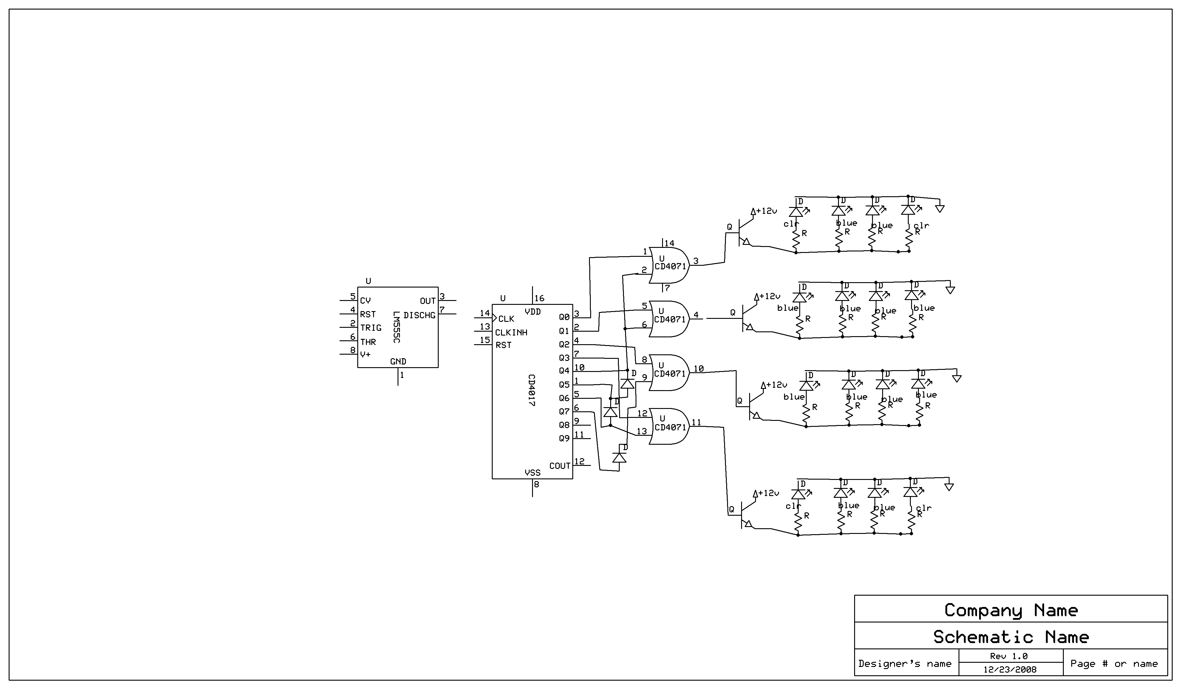

Building a display cab for LOML and planning on using some LED's for accent lighting.
idea is to use a 4x4 grid of LED's , with 4 LEDs wired in parrell per
each 4 LEDs are connected to a 4017 counter so the LEDs(4 per line) will cycle on and off.
The 4x4 grid has 4 clr leds on each corner and blue leds to complete the grid
4 High powered 140Kmcd clr LEDs and 8-13Kmcd blue LEDs
idea is to create a lighting ripple effect.
perhaps I need to draw out a schematic??
Sounds like you have it solved anyway ;-)
umm, changing accent lightling may prove to be a bit irritating after a while, are you sure you want to go that way, seems a bit cheesy.
cab light schematic
hope this is readable?
plan is to cycle through the 4 seperate set of leds wuith one or more sets on
the and gate needs some redoing but want to turn on 2 sets then 3 sets then 4 sets then all blue etc.

Question on using the 4029
Have what I hope is a working drawing of planned circuit but am wondering why is pin 2 of the 4029 connected to pin 1?
In my planned circuit I added a fourth transistoir and still connected pin 2 to pin 1.
why ???
orginal circuit bit-tech.net | Rainbow LED
attached my planned circuit
  • random lights.doc
The pin 1 to pin 2 on a CD4029 causes the counter to reset to zero and will mess up your 4th output.

well what to do with reset??
if pin 1 goes to pin 2 in orginal schematic what should I connect to reset or ??
The 4029 does not have a reset pin like all other counters have. Instead it has 4 preload pins and the pin 1 load pin. When pin 1 goes high then the counter goes to the loaded setting.
The circuit might be much simpler if a CD4060 oscillator/counter replaces the 555 and the CD4029.
But can I adjust the speed?
looked at data sheet ? ofthe 4060 but saw no speed adjustment except adding a crystal??
may just stick with the 4029 but what to do with pin 1??
The CD4060 uses a classic Cmos oscillator made with 2 resistors and 1 capacitor. Use a pot to replace one of the resistors for a speed control.

found the 4510 is same pinout as 4029 but looks easier to use??
I looked at the 4060 but it starts counting small but timing gets longer??
  • random cab1.doc
The 4060 has a built-in simple oscillator. Its outputs 7, 8, 9 and 10 are in a binary sequence. But it doesn't have an 11th output for a reset.
The CD4516 is a binary counter and the CD4510 is a BCD counter. The Carry-out of the CD4510 is used in your circuit to reset it before it gets to a count of 10, so it operates the same as a binary counter.
