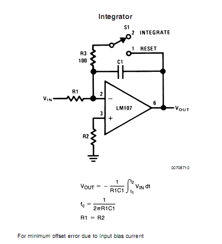

Hi All,
Could anyone advise me where to find the calculation for Ramp Generator gain i need it for an assignment experiment but just dont seem to be able to find it anywhere. The formula is required and any assistance would be greatfully received.

hi Les,
Which type of Ramp gen are we talking.?:)

Hi, eric
There is no information as to which type the question asks
Derive gain equations for Wein Bridge and Bubba oscillators, which i have Log amplifier which i think i have and have yet to design builsd and test. And then ramp generator with no parameters though it is purely investigative for this no build and test.

This image is a basic integrator that produces a linear ramp.
The ramp equations are shown.

Hi eric,
I do not see a gain equation below unless you are asying R1 = R2 thoguh thank you for your effort. I am relatively new to Op Amps and finding things hard to understand
