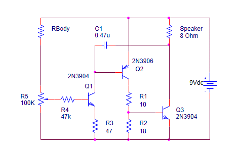

Does that look like the item you are talking about? I believe that Radio Shack first brought out the device as a "Lie Detector" and then later changed the name to something else to do with Bio Feedback. Page 6 of the linked manual shows the schematic.
I built one last year. It works exactly as you describe.

Interesting it uses a case from an intercom! :D
That's the one, a 555 would be quite an advanced design compared to that.

Would have been nice if RS had shown the complete foil side of the pcb but, since I don't have that case, I guess it doesn't matter. Rather than try to reinvent the wheel with a 666 (Satan's version of the 555), I think I'll try to get off my lazy tush and do my own layout. If I have success, I'll post it to this thread, most likely as a .DXF file.

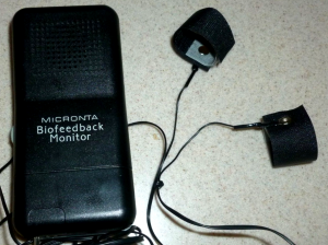

I see this is pretty old, But I also use to own one of the biofeedback oscillators. It worked great .. this is the one I owned.. here is the link. Thanks for bringing this up. brought back memories... lol
http://www.extremenxt.com/blog/?page_id=317

I loved that RadioShack device the blue ones it was excellent I don't know what I did with it but it got me very interested in biofeedback
