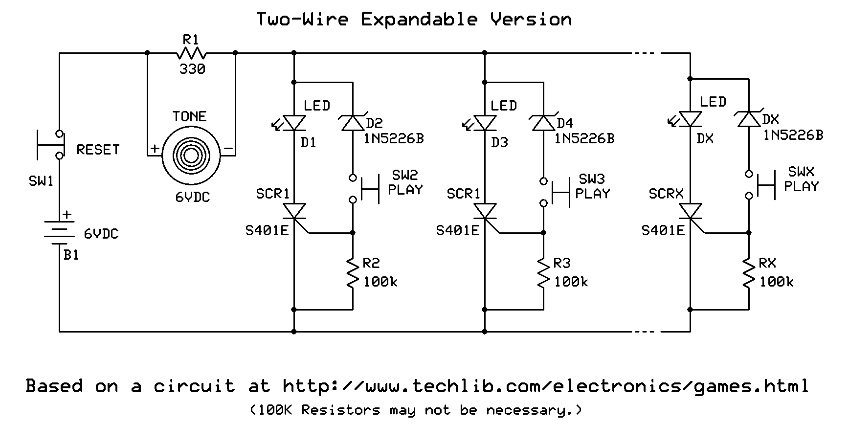

I need help. My daughter has asked for a "quiz themed" birthday party and in order to make it as realistic as possible I would like to build a set of buzzers. The only real requirements are:
a) every child has a "buzzer"
b) I know (as question master) - who buzzed first
c) No one gets electricuted in the process ( I think this should really have been the first requirement )
Now, I'm sure this isn't the most difficult thing in the world to achieve. However my knowledge isnt the greatest - Ive been know to put plugs in the wrong way round....
What I could do with is:
a) a list of equipment I should purchase and a very detailed idea of what happens next.
or
b) the name of a good book aimed at someone like me,
or
c) a different party idea...
I've no idea if anyone can help me. I'm not sure why anyone would want to spend their own time helping a complete stranger who is basically to tight to spend £250 on hiring them. But any advice would be very, very welcome...

you could use ten buzzer , ten 555 ( to make a variant sound ) and ten pushbutton
read something about square wave with 555
and let me know :)

Here is one I've used. First contestant in locks out all others. Buzzer indicates an answer and contestant's LED indicates who answered. 2-wire (cheap speaker wire), expandable to any number of contestants. 2-wire contestant cables can be either arranged in star or daisy-chin fashion.
Parts are from Farnell (UK)...for your convenience. "X" in the number of contestant stations.
X each LITTELFUSE|S401E|SCR THYRISTOR, 1A, 400V, TO-92 | Farnell United Kingdom
X each FAIRCHILD SEMICONDUCTOR|1N5226B|DIODE ZENER 3.3V 0.5W DO35 | Farnell United Kingdom
1 each MULTICOMP|MCMF0W4FF3300A50|RESISTOR, METAL FILM, 330OHM, | Farnell United Kingdom
X each MULTICOMP|MCMF0W4DF1003A50|RESISTOR, 100K , 0.25W 0.5% 50PPM | Farnell United Kingdom
X each CHICAGO MINIATURE LIGHTING|4308H1|LED Lamp | Farnell United Kingdom
1 each KEYSTONE|2478|BATTERY HOLDER, LEADED, 4 AA | Farnell United Kingdom
X each APEM|1213C6|PUSHBUTTON, PLASTIC, 12MM, NO | Farnell United Kingdom
1 each APEM|1212C2|PUSHBUTTON, PLASTIC, 12MM, NC | Farnell United Kingdom
1 each KINGSTATE|KPEG-200A|PIEZO BUZZER | Farnell United Kingdom
Made one for a College Biology instructor for pre-final exam practice sessions. :)
Would help build it if I were there. :(
Ken
