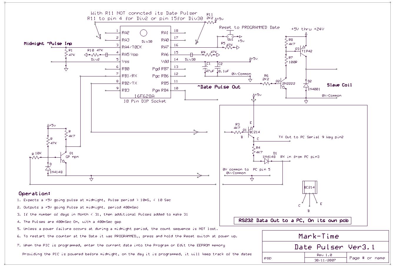

I have a "black box" which outputs a poorly-documented Serial data stream. I think the data stream may be coming directly from a PIC UART with no intervening Max232 driver chip between the PIC pin and the external connector pin. I cannot open the box. I think the data is 9600baud N81, but I am not sure of that.
If so, is this data stream "inverted" with respect to the signals expected by the serial port input to an old DELL laptop I intend to use to capture the stream to be able to see the data?
What is the simplest way of interfacing the data to the laptop?
A single NPN transistor inverter with a pull-up to a 9V battery?

A quick and cheap way to connect is shown in this circuit [ ignore the PIC's main functions ]
Use any general purpose transistor.
E
It uses the PC's -V, that is standing on the PC's RXD line.

Hi MikeML,
The signal to the RS232 port on the laptop should swing from a negative voltage to a positive voltage. (I think the RS232 spec says - 10v to + 10V but laptops often only go from -5 to +5) Weather it will work with a swing from zero to +5V depends on the interface design of the laptop. I suggest seeing if the laptop will display what is typed with a diode with the negative end to the transmit pin and the positive to the receive pin. If this works ( 0 to + 4.4V swing.) then it should work with your single NPN inverter. If there are gaps in the data string then this should be the state when the RS232 signal is in the negative state. (Or 0 volts with your single ended signal.) This should help you to decide if the signal needs to be inverted. If you are sure that the PIC is using its hardware UART then an inverter will be required ad a MAX232 inverts the TX signal.
Edit I've just seen ericgibbs reply. Using his method will generate the bipolar signal. You may even find that one of the modem control signals from the laptop is sitting at + 5 volts so that you do not need an external + 5V supply.
Les.
The circuit I posted does invert the signal and also swings neg/pos.
It is a commonly used option, it works.

The testers use 2 leds on each line one RED for -ve GRN for +Ve reverse connected.

Yes a simple inverter is all that is needed. They use TTL input thresholds 1.2~1.4 on RS232
RS-232 accepts +/3V to +/-30V but the threshold is roughly the same as TTL with optional hysteresis dependent on implemenation.
The bipolar signal give the single-ended signal more noise immunity but the 232 Rx input threshold is still nearly the same as TTL so that a floating input is a 0 for control signals (off) but a "break" for data.
