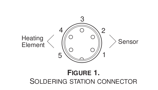

these QUICK soldering irons (pens) have DIN5C connector .. (all pens I saw) .. and I would like to know the pinout :) so if anyone have any ideas where to find it, please let me know ....
Is there some standard pinout that I can check (measure the values on the pins)?

Now for the pinout ... if anyone have any ideas .. please share .... even for some other soldering station if they have 5pin connector I'll try to measure outputs here .. might give me a clue where to start :...
