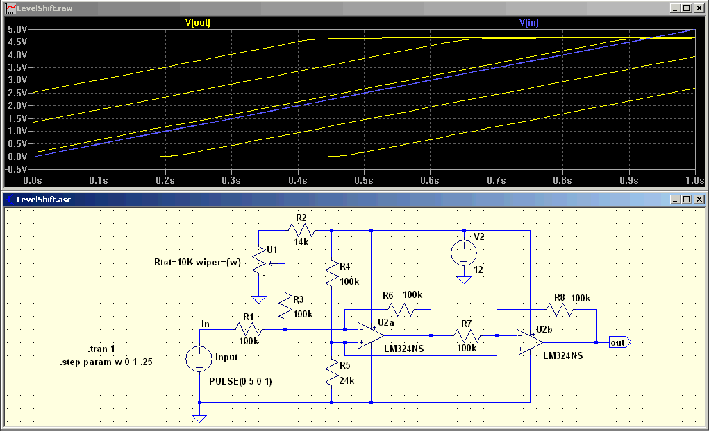

Is it possible to build a circuit with some sort of switch or dial so that it outputs with some sort of + or - gain to the voltage. If for instance the input is reading 3v, i can turn the dial so that it reads 1v, or 2v, or even 5v. The input is going to be a fluctuating 0-5v so the output will need to be able to fluctuate with the changes. Changing an incoming reading of "2,3,4,5v" into "1,2,3,4v" or if its +gain "3,4,5,5v". The change doesn't need to be 1v exactly... just able to be dialed up or down.
This is for a small personal project i am working on. I have a basic knowledge of circuit building and i am just looking for someone to point me in the write direction if you can. I would really appreciate it and thank you.

I'm reading up on the operational amplifiers, thanks.

I hate to be vague but I'm not sure exactly. The fluctuations are slow enough to eye witness at the tenth of a volt but not at the hundredth if that makes sense. Its a 12v DC setup with a fixed input range of 0v-5v and a needed fixed output max range of 5v.
Its just that while at full cycle if the highest peak voltage i see is 3v on the input for instance, i need to be able to manipulate it (with a dial or switch of some sort) so that on the next cycle the peak input will be changed so that the peak output reads 3.5v or 4.0v instead. Several cycles later, it may need to be adjusted lower or even higher again.

From what I'm reading on the subject... offset is what I'm after. Also, thanks on the explanation of both.
Something like this?
The yellow curves show the output (for a 0V to 5V input) for various settings of the pot.
