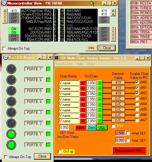

hi Steve,
This 16F88 program uses AN0/1/2 input levels to control 3 LED's on PORTB.0/1/2
It should help with 'compare' problem.
  • ADC_lite_darkV2a.asm

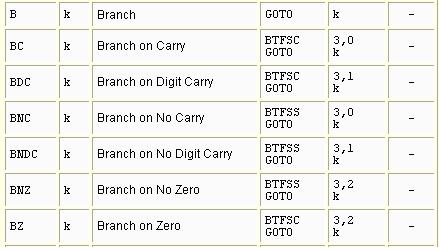

HI be80b Thanks alot for your response. I see the logic within your code and I like your method. Regarding your code, what is the precise function of "bnc"....i understand its a branch but I am unaware of where to find documentation on this?
Thanks once again, Steve
I can't take all the gory ericgibbs showed me that about two years ago
bnc-jpg.46229
