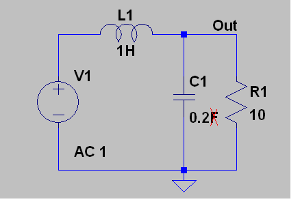

Good Day All;
Could someone help me in this question?
Calculate the resonant frequency of the circuit in Figure in the attachment.

Do you know how to write an equation for the network using complex impedance?
Hint: the circuit is a voltage divider.

Hello there,
There are a couple of different answers depending on how you interpret 'resonant' frequency.
The one most often quoted is the place where capacitive reactance equals inductive reactance and this is given by the well known formula:
F1=1/(2*pi*sqrt(L*C))
or you could simply solve for F1 when xL=xC.
The second point of interest that could also be called a resonant point is when the current from the source reaches max, and this second frequency would be given by:
F2=sqrt((R*sqrt(C^2*R^2+2*C*L)-L)/(C^2*L*R^2))/(2*pi)
A third point that could also be called a resonant point is when the voltage across the resistor (and capacitor) reaches a maximum amplitude, and this frequency would be given by:
F3=sqrt((2*C*R^2-L)/(2*C^2*L*R^2))/(2*pi)
This would mean the resonant frequency for your circuit could be any of (approximately, in Hertz):
F1=0.35588, or
F2=0.35567, or
F3=0.35140
In many cases they would ask for F1, but we'd really have to know where you are in your course work to be certain or what the application happens to be.
Convert the parallel R-C to series equivalent R-C. Then calculate resonance of series L-C. This is maximum current resonance.
Since voltage source has zero impedance, anti-resonance (max voltage across resistor) will be parallel resonance of L-C.

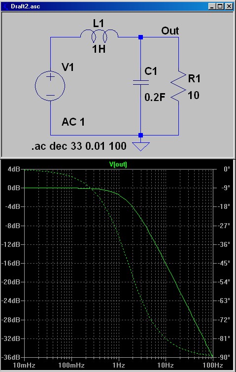

It is a trick question. It has no resonance; it is a low pass filter.
Hi Mike,
It might just look like a low pass filter when C is equal to 0.2 femtofarads, but when C is equal to 0.2 Farads (see diagram correction) it is very resonant. In other words, get rid of the capital "F" after the "0.2" for the capacitor and run another simulation.

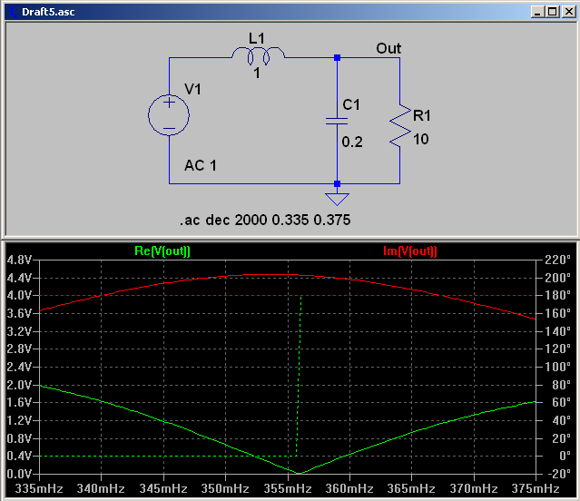

I would use the frequency at which the phase angle difference between the input and output goes to zero.
I assume you mean 90 degrees?
Yep. It is ~90 degrees. Second plot illustrates the Real and Imaginary parts of V(out)/Vin), where V(in)=1@0degrees.
