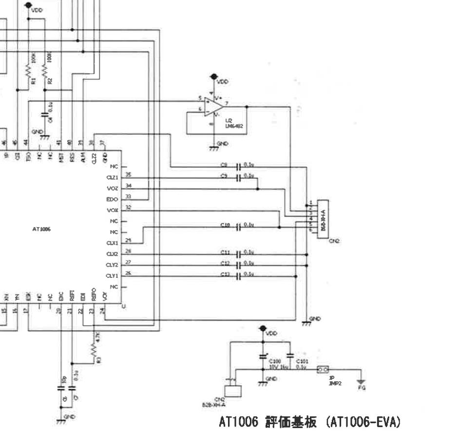

I have a question about a schematic of evaluation board provided by a company.

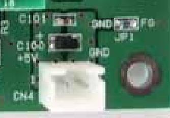

The lower right corner of the schematic below shows a simple circuit for the power supply section of the evaluation board. It seems that there are two ground, one is GND and the other is FG, there can be connected together through a jumper. The components on the board are connected to GND rather than FG.
This kind of design made me confused.
I think in this case, most area of board(copper pour) will be FG, GND only exists in several traces, am I correct? If I am correct, then what's the benefit of doing this?

GND is the Chassis or circuit common, FG is the Earth ground.
Some favour circuit isolation, it seems that they offer the alternative option of connecting Common to earth.
This is often done for noise prevention and/or safety.
They should show different symbols for each.

I think you are right, but I still feel confused, if connecting common to ground can prevent noise and is safe, why didn't the board designer directly connect these two ground rather than placing a jumper? Is there any bad points of connecting these two?
Also would you please help me check whether what I said in the threat is right? I want to make sure when I design the PCB, I have to route GNDs one by one rather than pour a ground plane, because in this case the ground plane will be FG rather than GND.

This board is used to accurately measure extremely small capacitance difference between two capacitors. I only need to connect the external capacitors to the connectors of the board, the output is the capacitance difference.
So I am wrong, I don't need to connect GND from different components one by one, I can still pour copper on top and bottom layer of the board and defined it as GND?
GND is the system, or circuit, or signal ground, the reference potential for all of the circuit's operational voltages. FG is Field Ground, an industrial control term for Earth Ground. This is not necessary for proper circuit operation. Connecting the two brings the system ground down to 0 V difference from Earth. Without that connection the two could be tens or hundreds of volts apart. This usually is not a problem with a stand-alone device, but if you connect to other devices for input or output signals, it is best if everyone agrees on what "ground" is. In systems with sensitive signals, this sometimes can cause problems with ground loops inducing noise, which is why the connection is optional.
