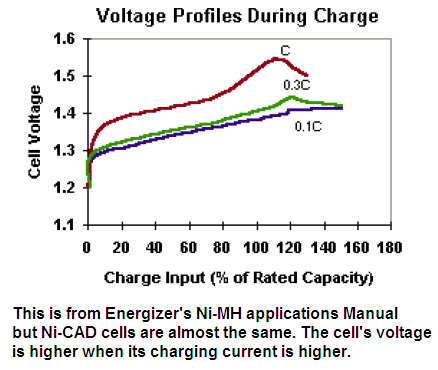

The manuals of an old Ni-Cad cell or a new Ni-MH cell from Energizer shows that its voltage is 1.4V to 1.55V when fully charged. Then 10 cells will be 14V to 15.5V. If the input voltage of the LM317 is higher than 17.5V then the extra voltage times the current makes the LM317 hot. Here is the voltage of a Ni-Cad or Ni-MH cell when charged at different currents. See where the voltage has a peak then drops? That is what a battery charger IC detects as a full charge so that it stops the charging.

In a previous post, I showed the voltage of a charging cell at different currents. Determine how many cells in series you want to charge, refer to the graph for the current you are charging at and add the 2V or 3V extra shown on the datasheet of the LM317.

You need to know the floating voltage of your battery when charging, plus 2v for the constant current section and about 3v across the regulator.
