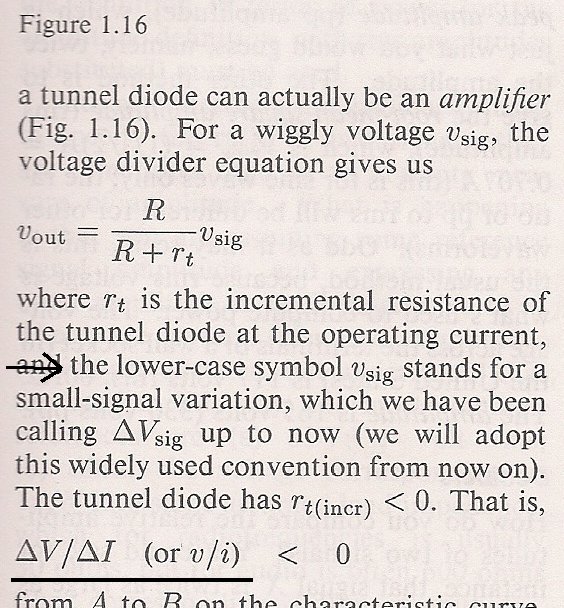

This is from my notes from "The Art of electronics" book.
If that is just a lower case i, this would suggest that it is a changing current.
Just a guess.
Δ delta symbol means the change of a variable or the change in. P.13
example ΔV/ΔI or dv/dI they use d also for derivative.
derivative is change, computed using differentiation.
SO NOW... Instead of using Delta Δ for a change in V, I, or R they will use
lower case v, i or r.
