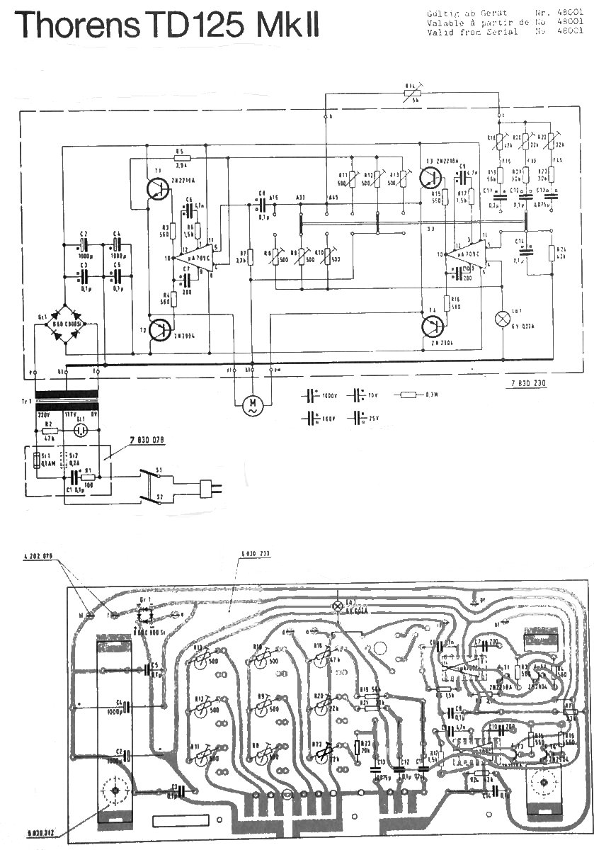

On my old Thorens HiFi deck the motor is driven by a dual op-amp w direct coupled bipolar amp output quadrature oscillator (Wien bridge followed by derivation stage). Input is 2x 12v AC and output on each wave is 6v into 27 Ohms.
It's broke.
I have the schematic, and can send it, but the parts are old eg op-amps are LM-3709C and trannies are 2N2218A/2N2914.
I think it's the semiconductors, because the unit kind of worked until I tweaked it!
Would someone be able to suggest drop in replacements for the Op-Amps and trannies (can replace resistors/caps if requ'd). These must be obtainable from Maplin or other on-line supplier preferably in the UK. I can get datasheets but don't have the knowledge to recalculate bias resistors etc. The other point is that the lamp is a spec which is no longer obtainable so the Wien gain adjusting pots may need to be replaced.

Please post the schematic.
Quad Oscillator PSU

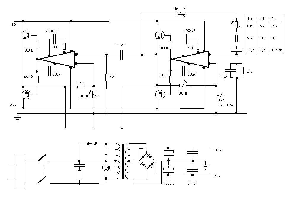

Thanks for your reply. The schematic is attached - both an original scan (pretty illegible) and a redrawn version.
In the redrawn version the 2x 500Ohm presets are in fact grouped in threes and switched with the Wien Bridge pots - ie for each frequency there is a separate gain adjustment on both op-amps.
The base frequency for 33 rpm is +/- 40 Hz but in fact probably more like 36Hz.

I would suggest that as it died when you tweakd a pot, the pot may well be duff? - old pots not only tend to go faulty, they also get very fragile, and it may have broken when you adjusted it.
But the circuit is simple enough, a free running wein oscillator (RHS) and an invert (LHS) - both have a simple pair of transistors to increase their current sourcing capacity.
The 500 ohm pots set the gain of each stage, set the oscillator one first, so the output is high but below clipping (unless you can find proper setting instructions?). Set the inverting amplifier one to give the same size output.
If the amplifier feedback pot is maladjusted, the oscilaltor won't run at all, so it could that that's faulty.

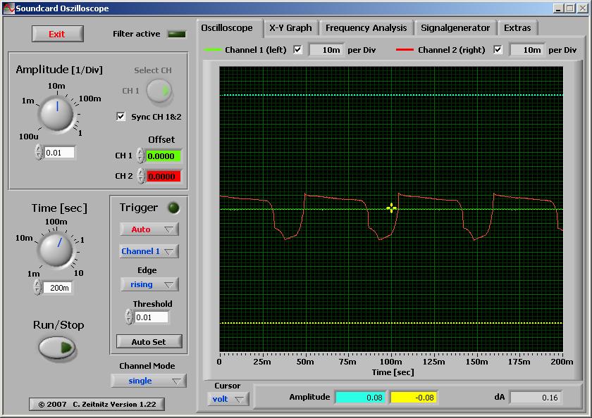

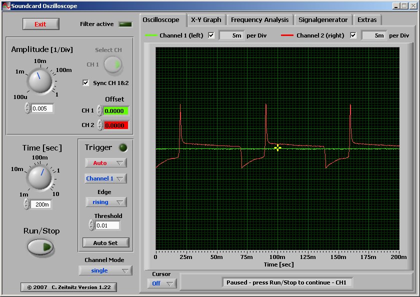

Some more investigation yields the following
1 Thankfully the pots are all OK
2 The PSU is OK giving + and - 18v no load and no ripple
3 Isolating the Wien bridge circuit gives the following results - first trace is from the putput of the current ampliying transistors and the p-p volts here are 2.9v as measured by Fluke digital MM. Second trace is from the output of the OpAmp and is approx 9v p-p.
What next?
R

I should also have mentioned that I can get a sine wave from the Wien bridge but only at 0.2v p-p at the transistor output and unmeasurably low at the op-amp. The other point to consider is that the gain is set for the combination as a whole - ie the feedback to the opamp is from the transistor output, not the opamp output.

That's right. Because the scope is basically using my PC's sound card, I have bridged the line input with a 10k pot. Thus the amplitude of the wave on the scope screen is dependent both on the pot setting and the sensitivity of the scope setting.
