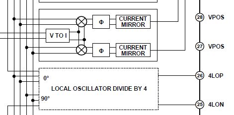

You seem to be overly concerned with using a square wave for a LO. In the case of a Gilbert Cell (most quad mixers), the LO acts as a switch control so a square wave works best for this application. Besides, even if you input a sine wave, it will become a square wave after the internal LO divider. I suggest this again, you should research the Gilbert Cell Mixer.
Thanks for pointing towards right part of data sheet. I actually read this part but as i could not found any mentioning of sine wave frequency range explicitly (as given in AD8333 data sheet), i was confused.
As for as your second point is concerned, it means that if we apply square wave at 4LOP pin or sine wave at this pin, the I/Q outputs will be same. Am i right?
I almost missed your question as it was hidden in the quote (not a good idea to do that). Now I am going to answer your question with a question.
1. As for as your second point is concerned, it means that if we apply square wave at 4LOP pin or sine wave at this pin, the I/Q outputs will be same. Am i right?
Looking at the block diagram, what do you think?

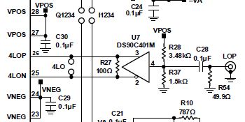

Also be advised, the LO must be driven differentially as per the data sheet.
LO INPUT
The LO input is a high speed, fully differential analog input that responds to differences in the input levels (and not logic levels). The LO inputs can be driven with a low common-mode voltage amplifier, such as the National Semiconductor® DS90C401 LVDS driver. The graph in Figure 22 shows the range of common-mode voltages. Logic families such as TTL or CMOS are unsuitable for direct coupling to the LO input.
See the eval board schematic.
