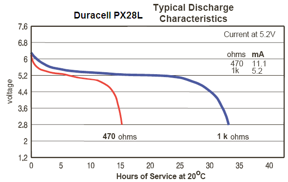

The tiny battery cannot provide enough current so when the relay actvates then the battery voltage drops down too low for the sensor to drive the relay for a second time.
Four AA cells weigh nearly 10 times as much as the tiny battery so they provide much more current without the voltage dropping.
Yeah, that sounds like a plausible theory. Is there any way to tell how much current a battery can provide? Usually they only state how much mAh they last no?
Thanks for your help!
Most battery manufacturer's websites have detailed datasheets for their batteries.
Duracell don't make the old alkaline tiny 6V battery anymore and have replaced it with a much better lithium type the PX28L. It is shown with a load of 11.1mA to last about 12 hours.
I bet your relay draws much more than 11.1mA.
