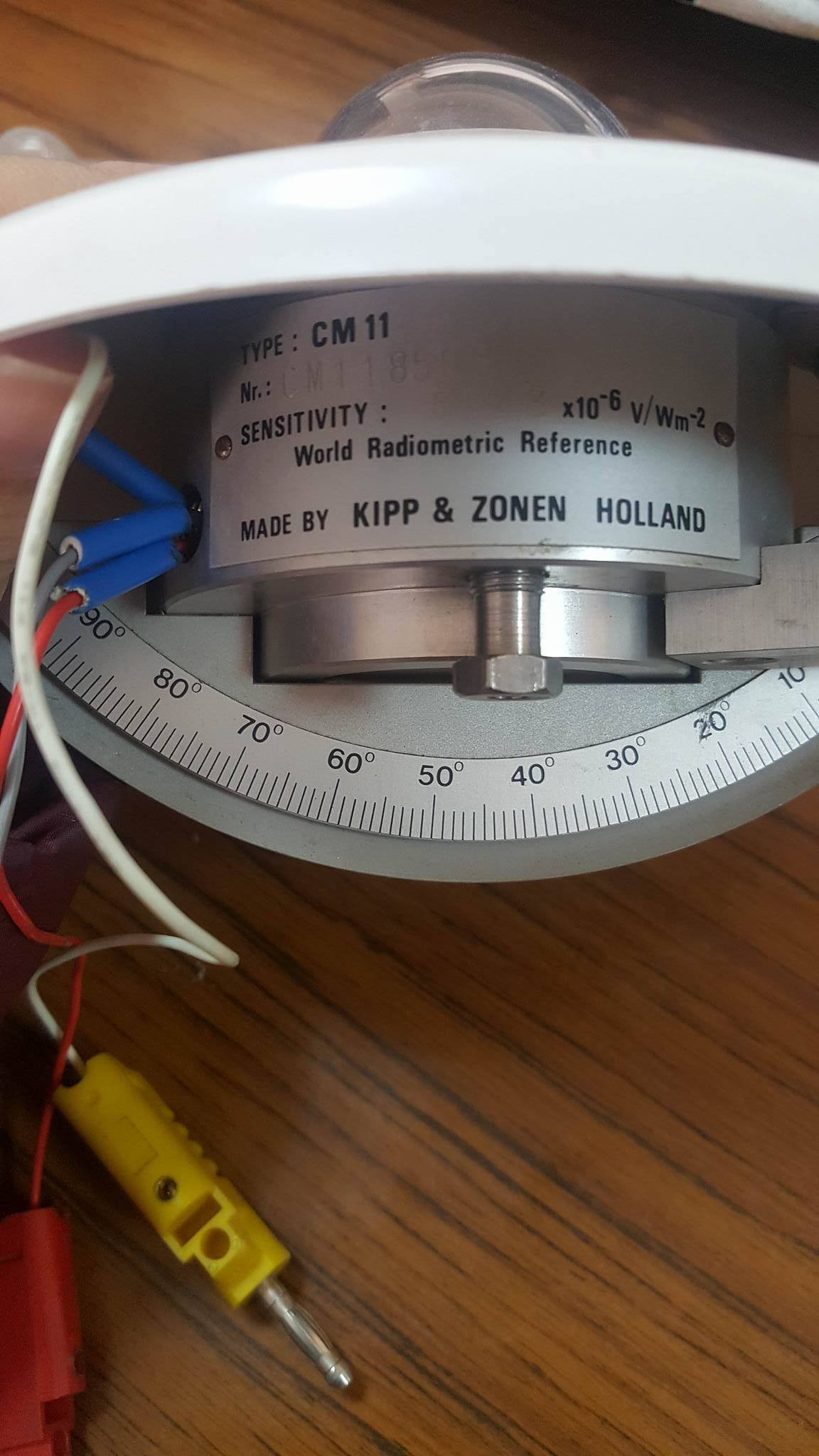

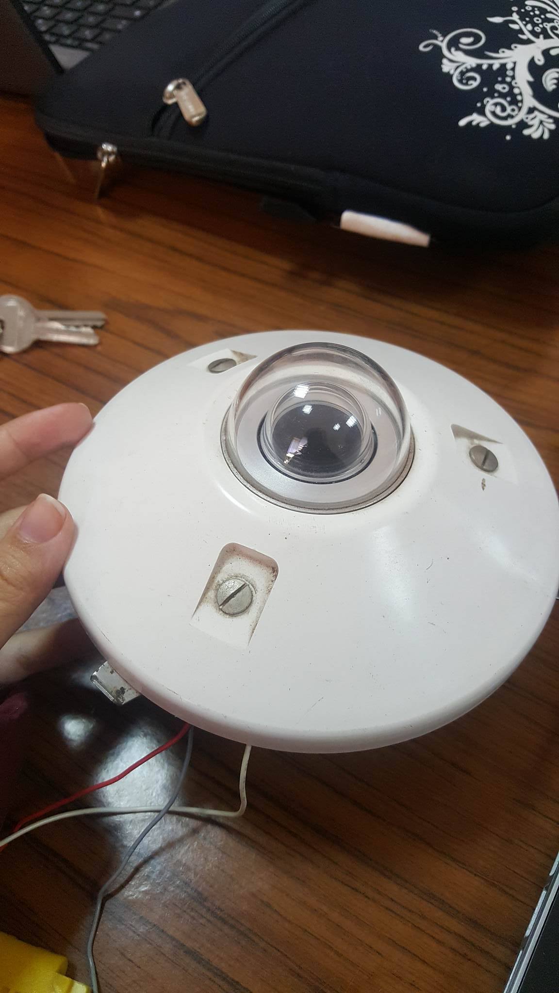

What is the model # of the pyranometer?
I'm unable to find kipp&zonen CM11850828
Got a link?
This is the pyranometer i couldn't find any documents either that's the problem i beleive it is a quite old reference anyway i send some phtos in the attached section
