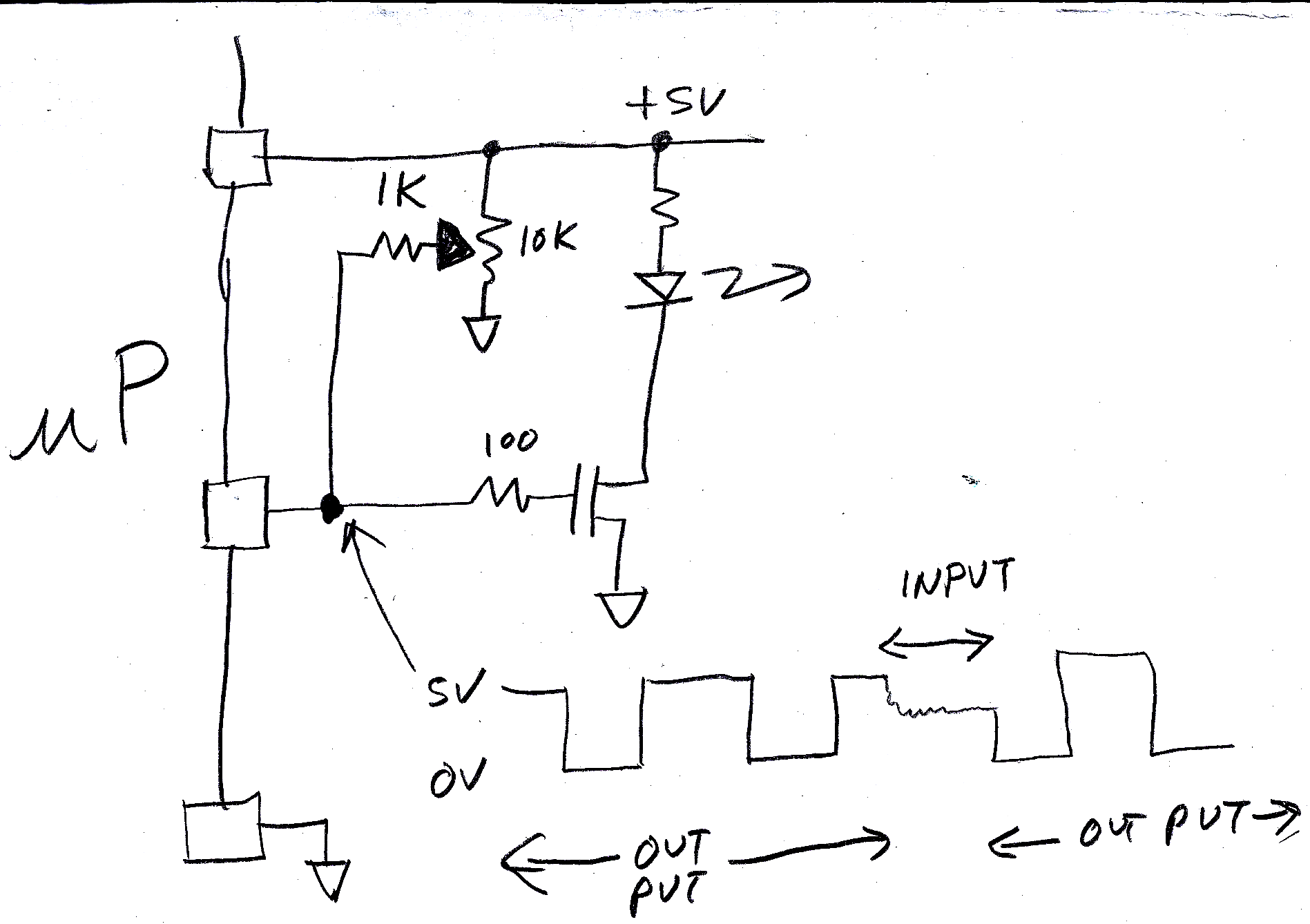

uP is on the left side. +5V, IO pin, ground
When the pin is set to output; the pin over drives the pot (1k & 10k) or could (10k & 10K). Then the pin is high the LED is on, when the pin is low the LED is off.
When the pin is set to input; the voltage will be set by the POT. The MOSFET will be on or off depending on the POT setting.
The pin will be in input mode much less than 1% of the time. Last time I did this I checked the POT voltage only once / second.
