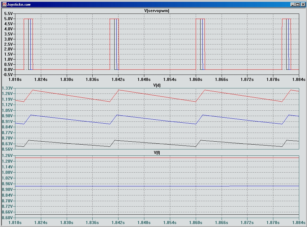

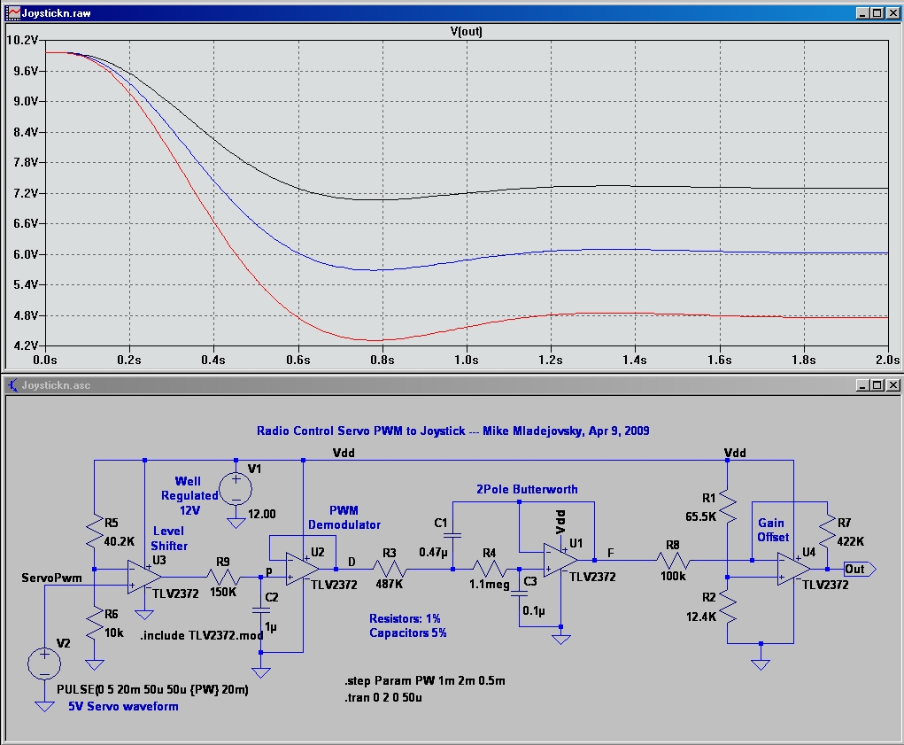

If the Joystick is fed with 12V, it puts out 6V centered, and swings from 4.8V to 7.2V. Here is a four opamp solution that produces the same amplitude, centered at 6V. It relies on a clean, accurate 12V supply.
It uses 12V rail-to-rail CMOS op-amps. First stage U3 just squares and amplifies the PWM signal so that it swings from 0 to 12V. The RC network produces a voltage whose average value is derived directly from the PWM ratios. It has a lot of ripple, so I pass it through a three-pole Butterworth filter with a cutoff of 1Hz (U2 & U1). The final stage U4 offsets the signal to 6V, and provides gain so that the signal matches the same swing as the Joystick. Varying R1 (65.5K, make it a fixed value in series with a trimpot) will center the swing at 6V.
Mike, you are right on with the Voltages - using my cheapie voltage tester I see 11.84 volts being supplied, and the center tap is at 5.91 volts. When at full deflection the measured voltage swing is from 4.82 to 7.09 volts on one axis and 4.84 to 7.20 on the other. Again, cheap equipment being used.
So that brings me to my questions -
1) on your diagram where does the center tap come into play? The existing motor controller goes into lockdown if it does not see 50% of the voltage on the center tap. [Am I understanding joysticks correctly, the center tap voltage never changes, correct?]
2)The R/C receiver uses 6v for power, could I tap into the center tap for this 6V?
3) do I need to worry about the impedance of the circuit? I see it mentioned in the Penny & Giles Technical Specs that are listed, and I wonder, is that just a measurement within the joystick, or might the impedance of the circuit cause me issues?
Thanks again - t
Can you use the 11.84V (tied to the top of the joystick) to power my circuit?
If so, disconnect the input to the wheel-char
servo from the TAP on the joystick and connect it to OUT on my circuit.
In the original, the voltage at TAP controls the wheelchair servo. After the change, my circuit generates a voltage at OUT which varies as the RC pulses change. When the RC pulse is 1.5ms, OUT should be half the supply voltage, ie half of 11.84V (similar to what it was out of TAP). You may have to tweak R1 in my circuit to "center" the wheelchair servo when the RC pulse is 1.5ms, and when the RC joystick is trimmed to center...
If you need 6V to power the RC receiver, you can derive that off the wheelchair 12 or 24V using an appropriate regulator. My circuit doesn't care what the amplitude of the 20ms pwm signal is within reason.
I dont think that the series impedance mentioned the joystick spec will matter. If it does, then put a 1.4K resistor in series with "OUT".
