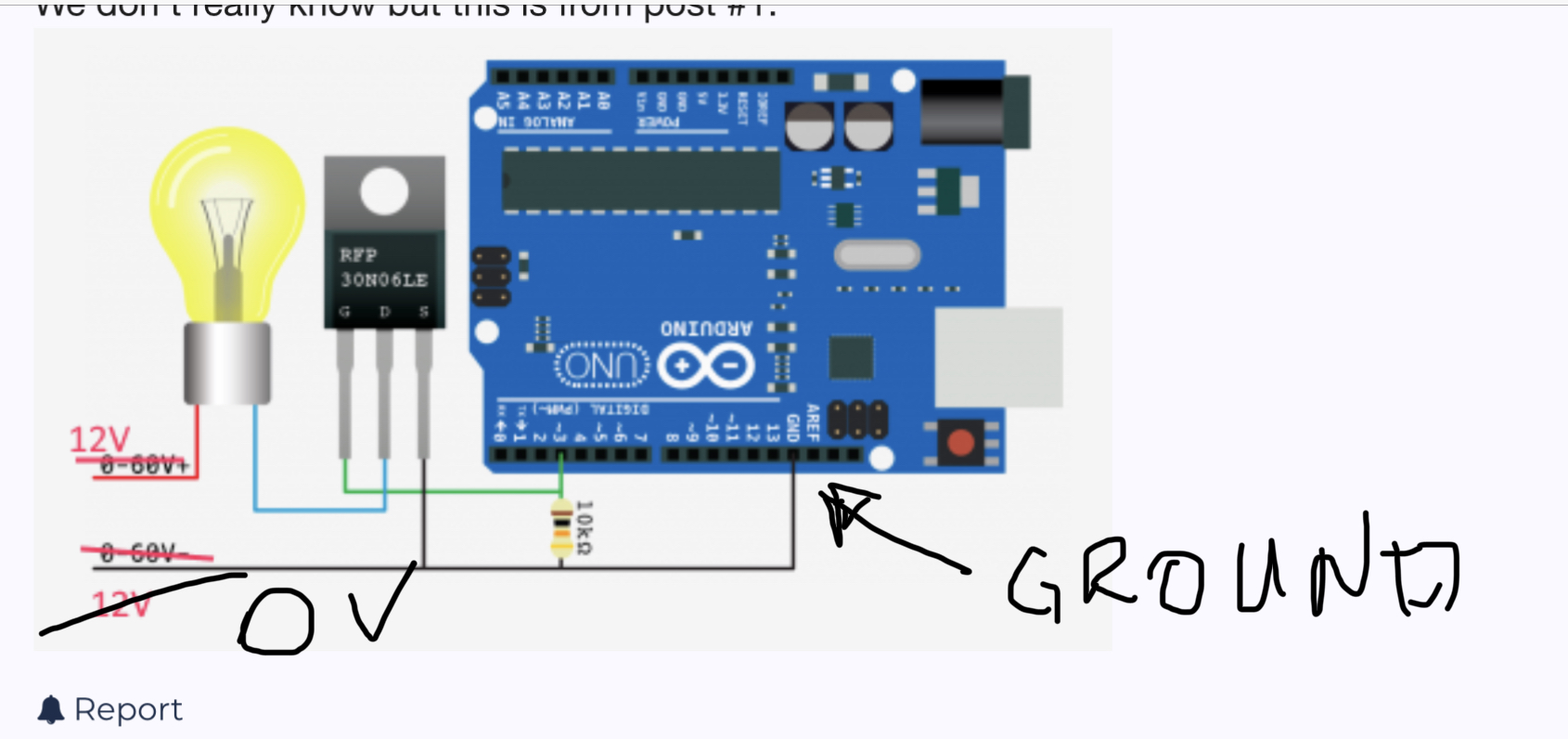

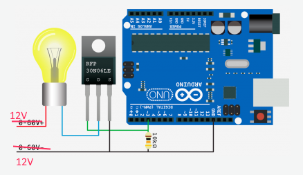

I have a 12V LED strip I'm trying to dim using an Arduino as the PWM signal source and a IRF3204 N-channel MOSFET.
I've kept the circuit simple, basically used this as a guide: https://bildr.org/2012/03/rfp30n06le-arduino/
When I measure the PWM output from the Arduino with my oscilloscope i get a nice square wave going from 0 to 5V. However, when I measure on the "12V side" I still get a nice square wave, but it only "drops" from 12V to about 10V, should it not also drop to 0V when the signal from the Arduino is 0V or have I misunderstood something?
I hope my question makes sense and that I have provided enough info.
Thanks in advanced.
Jacob

What ever kind you use it must be a logic-level type MOSFET, not just "any MOSFET" as your bildr.blog reference incorrectly stated.
It's probably working fine. Once the voltage falls to around 10 V the LEDs (probably 3 white LEDs in series) stop conducting so there is nothing to pull the voltage further down. At PWM frequencies, quite a small capacitance will keep the voltage up.
Add maybe 1 kOhm in parallel with the load and the voltage will go all the way down during the off phase.
We don't really know but this is from post #1.
When the voltage at the gate is zero, the MOSFET is not conducting. That means, you have essentially infinite resistance across your mosfet. If you calculate the voltage divider of an infinite resistor in place of the mosfet, a small resistor (1000 ohms) and an LED, above the mosfet (I.e. they are connected to the 12v rail, you will see 12v Minus the diode (LED) voltage drop, which I assume is a red LED so a drop of 2v to get to 10v.

The circuit is as Ronsimpson posted it:
Also the Mosfet is a IRF3205 not 3204 (sorry typo).

Anyway, diver300 and gophert seems to have hit it on the nose. Once I put a 1Kohm resister in parallel with the LED the PWM signal on the LED perfectly mirrored the input signal.
I'm assuming there is no need for the resister (apart from making the plot look nicer??)
That MOSFET requires 10V to fully turn it on.
You need a logic-level MOSFET with a Vgs(th) max of about 2V.
He has a 9 Watt LED Lighting Strip, with built-in current limiting resistors, designed for 12 Volts DC.
When the MOSFET is ON ... the junction between the MOSFET and the LED Strip should be near 0 Volts.
When the MOSFET is OFF ... the junction between the MOSFET and the LED Strip should be near 12 Volts.
It was reported by JacobT ... when the MOSFET is "ON", the voltage dropped down from 12 volts, to only 10 volts.
That tells me ... the 5 Volts on the Gate is causing the MOSFET to have a high Rds, not a low Rds.
For the IRF3205, the Rds is 8 milliohms when the Gate is at 10 Volts, well above 5 Volts.

I think that JacobT has been measuring the voltage across the LED strip, not the voltage across the MOSFET.
When the MOSFET is off, there is nothing to pull the voltage across the LED strip below about 10 V. Once the LEDs stop conducting, which is at around 10 V, the voltage is essentially floating and a tiny bit of capacitance will keep the voltage at 10 V for the "off" part of the PWM cycle.

The IRF3205 is capable of way more power than is needed here, so it's not important to turn it on as hard as possible. If you look in fig 1 of the datasheet
you'll see that at Vds = 0.1 V, with Vgs of 4.5 V, the current is about 2.5 A. This application is 0.75 A, so the voltage drop will be far less than 0.1 V. So the MOSFET could be driven better, but it's being driven well enough.
Adding a 1 K Ohm resistor across ( in parallel with ) the LED Lighting strip should do nothing to make this MOSFET work better.
It's not making the MOSFET work better. It's making the output voltage look "nicer".

If the output of the Arduino is a low impedance cmos logic that's either 0 or 5 volts, then adding a pull up to +12 will just increase the current loading on the output pin, but won't increase the voltage.
The graphs on a datasheet usually show only a "typical" device. But you cannot buy a typical one, many being made are much less sensitive as shown in the guaranteed spec's. It might conduct only 250uA at its 4V threshold voltage then not do much more when driven with the Arduino.
You could buy hundreds of Mosfets from different places and still not find one that is sensitive enough. A logic level Mosfet is guaranteed to conduct a lot of current when its gate-source is only 4.5V.
