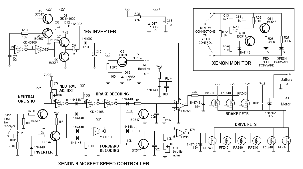

Here is a controller that can be modified to your requirements:

Hi
Thanks for the schematic, but this looks a little more complicated for my needs as i do not need any receiver, no braking, no inverter etc. Also, what is the purpose of having so many FETs?
Jmecherul
Each FET will only pass about 30 amps. But if you de-rate each FET the turn-on voltage across them decreases and the heat generated is less. The total current for the Xenon-9 is 250 amps. You can use any number of FETs according to your current requirement.
You can also use only those parts of the circuit that are needed for your application.
The whole circuit is just a series of "building blocks."
Colin Mitchell
TALKING ELECTRONICS.com
So, the more FETs you have in "parallel", the lower the voltage across them, the higher the load current?
And, you mean the max load current is 250A. My question is now why would they need a 250A load current for a tiny toy car motor control?

If you de-rate the FETs, such as in the Xenon-9 circuit, they do not have to be heatsinked as the turn-on resistance is about 0.02 ohms.

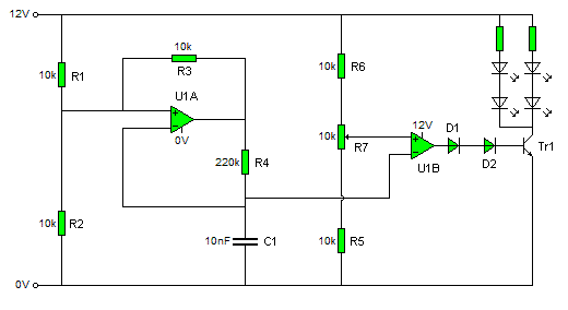

My understanding that two op-amps can be used to create a saw shaped wave and a comparator in order to create the pulse modulation. I just am not a circuit design person, so I am lost.
Jmecherul
Yes, all that's needed is a couple of op-amps.
Of course Tr1 would need to be replaced with a huge MOSFET or loads of paralleled MOSFETs and D1 and D2 would need to be removed.
