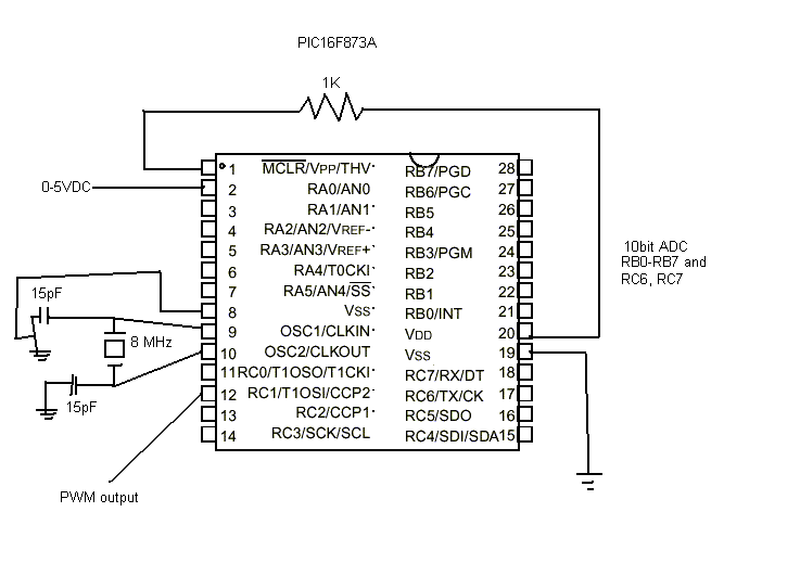

OK,
I want my PIC16F873A to take in 0 to 5vdc, it will output a 10bit adc number where 0v = 0000000000 and 5V = 1111111111. It will also output a PWM wavefrom where 0v = 0% dutycycle 2.5v = 50%duty and 5v = 100%duty.
ADC and PWM both work on simulator
PWM output on CCP2
10 bits numers on RB0-RB7 and 2 MSB on RC6 and RC7
when i hooked it up it does not work, here is my a basic schematic of what is hooked up
:confused:

You'll need a 0.1uF decoupling cap across VDD & VSS
What are your config values? HS, XT etc...
What did you program it with? LVP or HVP?

I set the oscillator type to XT and i also tried HS..i'm not sure what to use i Have a 8MHz crystal.
I will put a decoupling cap between VDD and VSS tommorow
If by HVP or LVP you mean hig voltage program or low voltage program, i used high voltage program.
Do i need a delay (200ms) type command at the end?
Try putting and LED on one of the pins and then when your program your code so that the led turns on as soon as possible. If it does, try changing the position of where your led turns on or off. It will kind of give you an idea where the problem may lie if it is a software related issue. Poor mans debugger =)
Also, might be stupid, but I know that some simulators dont nessarily include vdd and vss connections. You DO have 5V externally connected to both VDD and gnd connections to all VSS ?
A problem which i encountered is if your fuses are not set up properly. Make sure that you are using XT and that WDT is disabled.
But try the led thing, it might give you some insight.

I have 5V on Vdd and VSs to gnd. I have 0-5vdc goign in a was just using a voltmeter on the ADC output to see if i could get a high and a scope on CCP1 but not luck.

I came in today, put the a 1uF cap from VDD to VSS, turned my power on and then put a voltmeter on the output pins and the ADC works..ALL 10bits..:)
BUT
The pwm does not work..:(.I have an 8MHZ clock and my PWM i set to 5KHz.. Would i be able to lock on to that signal off C2 with a scope? wouldint i need a refrence/5KHz clk?
I'm thinking i might need to add a delay_200ms command..im goona try that because all other PWM code i saw included that..any other suggestions are welcome.:confused:

Ok, it was fully working well, then i reconnected the circuit and now...it onlt works when i take the crystal out and put it backl ...it reads the vvalue and displays it.
it only changes when i take the crystal out and put it back it..it will not do it on its own?
any idea?
Update for those of you who care:
I think i got it working now...i re-programmed the chip using HS instead of XT and turned the rigth fuses on and off..well see how long it last this time.
