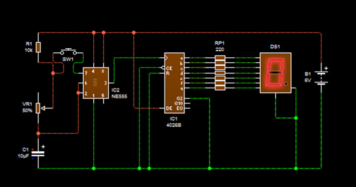

1) This is a simply circuit that I have duplicated from an online image. The function of this circuit is to count the amount of coins that are dropped and making contact with the switch, I know the switch needs a debouncing circuit which has been made and done but I believe other inputs could be better and more sensetive such as piezo transducers but I could use the variable resistor to change the sensetivity of the switch. POINT: Better inputs than the push to make switch?
2)Currently I understand how the 7 segment display works but not the rest. previously I experimented with using 4 switches as the inputs to make binary code and display number but of course with the needed function this is impractical. POINT: How does the 4026b work in co operation with the 555? why is the 555 there? how does this work by sending a single signal while previously it needed 4?

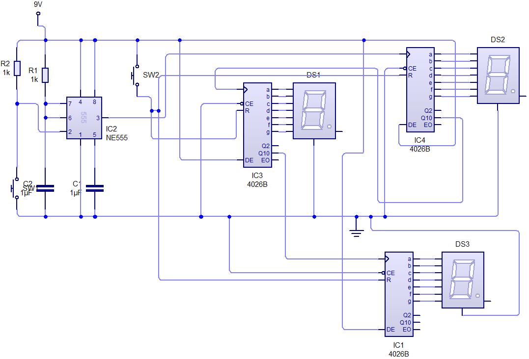

That schematic is a huge mess. Please try to redraw it with fewer crossing wires, and with the order of its operation flowing left-to-right (i.e first LED driver on the left, second to the right of that, and third to the right of that). Also put your displays next to each other with the 100s digit on the left, 10s digit in the middle, and 1s digit on the right.

I'm glad to see you fixed the switch. Your first schematic was wrong, your second one is right--The switch should be connecting pin 2 to ground when pressed.
You do not need the 555 timer though. The switch will act as a clock source itself, so it can be fed directly into the clock input of the 4026. However, the clock is active high. This means that to increment, you need the input to jump HIGH, then low again. In order for this to work, your switch would need to connect the clock input to V+ when pressed. If you use a phototransistor your logic will be inverted, so you would need to invert it back. When no coin is blocking the beam, current will be allowed to pass between the collector and emitter. When the beam is broken the transistor will not conduct. This is not what you want. You'll need to invert the signal back by connecting the collector of the phototransistor to a pullup resistor (pulling it up to V+). Connect the emitter directly to ground. Your output is from the collector of the phototransistor. When there is no coin the beam is present, and the phototransistor is conducting. This pulls OUT down to ground, giving you a 0 for an output. When a coin is dropped and the beam is broken, for a fraction of a second the phototransistor does not conduct, and the output is fed through the pullup resistor, and the output is HIGH. This is your clock signal for the 4026.
The 555 monostable de-bounces the switch. Without the 555 when you push the switch it might bounce many times which is counted. You time it so it prevents switch bounces but allows as many coins that you want in a short time duration.

No. On all electronics fora (the plural of forum) there are two groups of crazies - those who think the 555 is the only answer to just about everything, and those who think any chip over 3 years old is ancient garbage. Tracking which group is less rational keeps the rest of us entertained. Note that 40 *years* after its introduction the 555 still is selling over 1 billion pieces per year worldwide - hardly useless. But I digress...
In your circuit the 555 is configured as a retriggerable monostable, one form of a debouncing circuit. With proper attention to detail, it can be eliminated while still having the input switch debounced. Even if you go with an optical interruptor, a little debouncing on its output will catch the few remaining errors.
Your counter circuit needs a pull-down resistor on the reset line. Also, the 4026 is not really built to drive displays directly. The datasheet has three display application circuits, and all of them have external drivers of some kind. You can drive one display directly, but it will not be very bright and should have 7 current limiting resistor, one per segment. That's 21 additional resistors on your schematic.

The 555 can be kept or I could use a debouncing circuit which I has been done in a previous post. In regards to the resistors you are right 21 resistors is a lot and will be a pain when it comes to the pcb.
Now left with the others the LCM7217 is actually very interesting and a great potential learning curve but once again 28 pins on a pcb is not going to be the easiest thing; a battle for another day. Out of the potential other two ICs the cd4553 seems to be more commonly used and would definitely be a better option to use.
