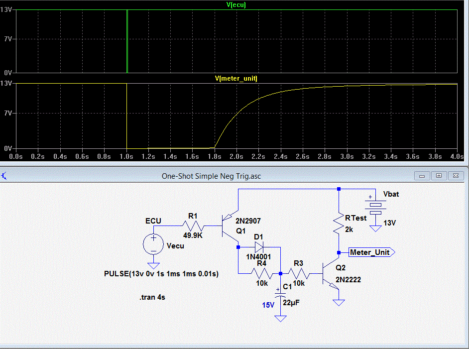

Using a short pulse to initiate a longer pulse is common. The combination of a short negative pulse to trigger the longer pulse suggests the circuit may be based on the venerable NE555 /LM555 chip, such as here: https://electrosome.com/monostable-multivibrator-555-timer/
It is not necessary, however, to use that chip. A search for "monostable" will show several circuits, including ones made from discrete devices (i.e., transistors, capacitors, resistors). The 555 is a durable chip and can operate 12V well. Plus, there will be lots of help available for it. So, while it may lack novelty, it may well be your best bet. You may need to condition your result to stop unwanted blips of the LED when power is first applied, but before the ready signal is received, if such blips will be a problem. None of those blips will be on the order of 0.5 to 1 second, so they may not be a problem.

Here's a simple discrete one-shot circuit (as an alternate to a 555 circuit).
The values shown give a pulse of about 1 second, which can be varied by selection of the value for C1.
Rtest is just for simulation purposes and should not be needed in the actual circuit.
The transistors and diode can be any common small types.
The resistor values are not critical and can be within 10% of those shown.
The output will stay low as long as the input is low and then will go high after the delay when the input goes high.

The blk/wht wire at pin 6 (rear of meter/cluster) is momentarily earthed by the ABS ECU. Is that what your diagram is showing at the left side?
Thanks in advance to helpers.
The left input is the momentary low signal from the ECU. That is what the Vecu source (round circle) on the left is simulating.
The right output goes to the meter cluster to light the LED.
Obviously you need to break the present connection between those two to add this circuit in between.
(This is for how I understand it works).
