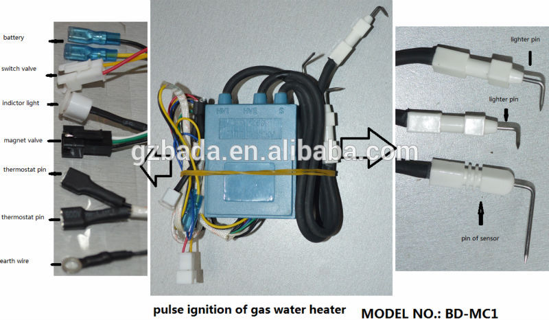

I would like to build my own pulse ignition of gas water heater like below.

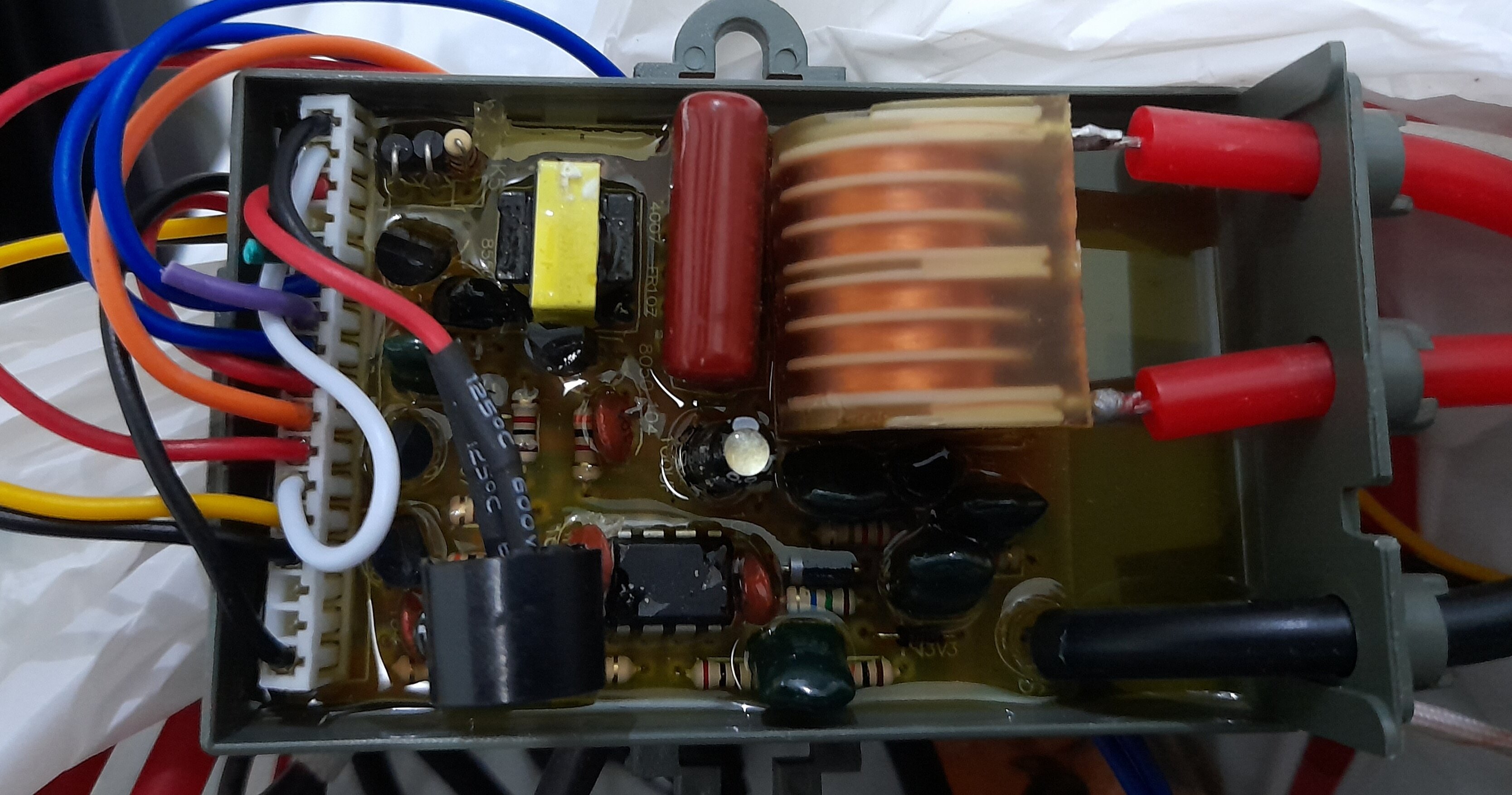

The circuit inside the module is looks like below
Anyone of you know the circuit diagram of this pulse ignition of gas water heater? please share.
And if you know the circuit explanation of how it works, please also share the knowledge with me if you don't mind.

Yes, you are right. It also contains the flame presence sensor, gas control and safety valve to shut the gas line when the flame not present at particular time. And yes you also right a DIY of this module can harm people around if got malfunctioned caused by the gas leaks, but actually the safety valve will handle that one, right.
I have a DIY deep fryer which use that module for igniting the flame, the problem is that the ignition module has reliability issue, there always a component burnt inside the module after a couple of months use. The module I currently use is seems not the proper one, probably it is also built from home scale industry, because the fact is there no user manual available came with the module and even there is no brand written in the module. So I assumed that the module is also a DIY from home scale industry. I bought it from local store.
So that's why I asked the expert here if they can share the proper schematic for this module, then I'm going to be able to built the proper one and I would be very appreciated if any.

I had to learn about that type earlier this winter. I have a overhead gas heater in my work shop, one that is called a infrared heater. It has one of the type of igniters you show. The valve or igniter it's self may not be the problem. Try cleaning the one electrode shown called the, "pin of the sensor" in your first picture. The igniter/sensor uses the pins to both ignite and sense flame, through a process called, "flame rectification". After the sparking to start the flame there is still a voltage on the one "Lighter pin", the other one is a ground for the spark. This continuous voltage is then rectified to keep the gas valve on. If there is any rust, corrosion or carbon build up on the sensor pin it won't work, so before doing any thing else clean the sensor pin with steel wool or a Scotchbite type abrasive pad. That worked for my heater, it is old and new parts aren't available for it so had to learn about them.

Yes, I also had the same experience that the flame once didn't start caused by dirty electrodes. Then everything's back to normal after cleaning. Thanks for your sharing. Appreciated that.
