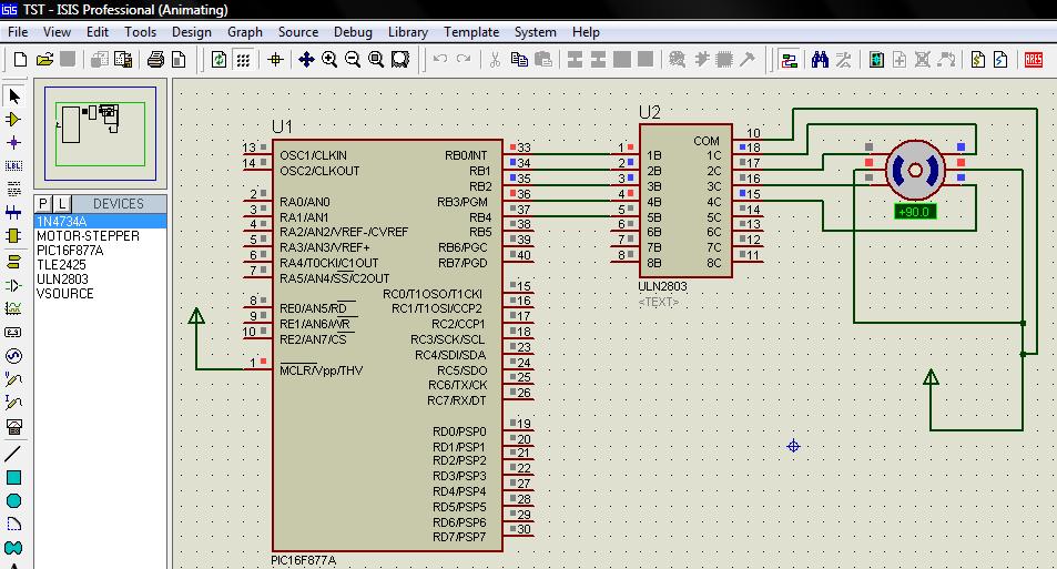

Hi Kulanga can you post the circuit where you connected BLDC-star and the code. that would be helpful because we can be able to
see where corrections have to be made. For instance look at my circuit diagram on the attachment and the code I used to run the program.
;PROGRAM FUNCTION:turning motor
    list        P=16F877a
    include    "P16F877a.inc"
                __config 0x3D18
    CBLOCK 20h   ; Temporary storage
         dc1
     ENDC
    org     0x0000
    goto Start
;Program Start:
 Start
    call Init                ;to initialize portb
;Subroutines: wait
  ; Outer loop iteration count
       movlw   5            ;count 5 times
       movwf   dc1
       decfsz  dc1,F        ;Decrement 5, Skip if 0
       goto    $-1          ;wait for loop count to finish
       return
Init
       clrw                 ; Zero.
       movwf   PORTB        ; Ensure PORTB is zero before we enable it.
       bsf     STATUS,RP0   ; Select Bank 1
       movlw   0xF0         ; Set port B bits 0-3 as outputs
       movwf   TRISB        ; Set TRISB register.
       bcf     STATUS,RP0   ; Select Bank 0
Main
  ;applying different sequence of pulses to drive motor
       movlw b'1001'
       movwf PORTB
       call wait
 end
