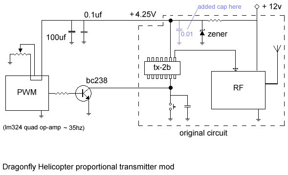

Early experiments are good. Replacing the original full speed on/off switch in the transmitter with a PWM circuit to control the main motor works well, the motor speed now being truly proportional, hopefully giving much better up/down/hover control. (so far without any changes to the receiver end)
However there's one snag so far with the circuit I've used. If any part of my body gets too close to the circuit (or the aerial), the motor spins up to full speed, dropping back to controlled speed if I move away again. I've tried various decoupling caps etc to no avail.
If anyone can help I'd be much obliged.

Just tried circuit with PWM running about 10hz.
Seemed to work ok at first - no speeding up but not getting full revs because battery in chopper was a bit low so tried with fresh battery.
This gave zero to full revs but speeding up effect returned! Could it be I'm overloading the tx (or rx?) somehow. Tx is on 27mhz, uses 5 transistors, but apart from that I haven't given much attention to it so far.

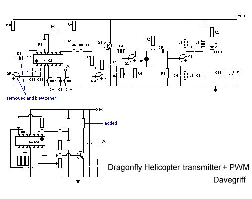

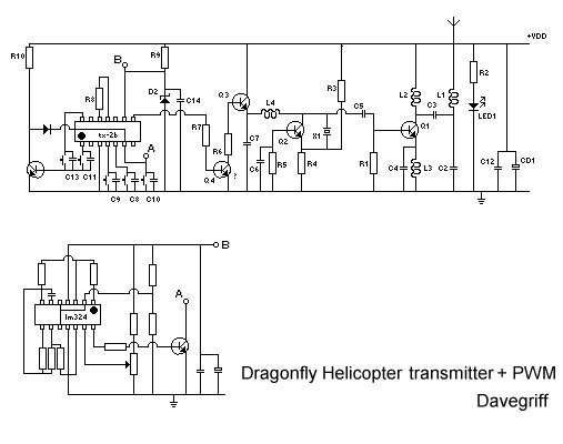

Haven't tried lower frequency yet but here's the circuit + that of pwm.
I posted query first about six hours earlier, but when it didn't appear in the forum and could find no record of it I posted again. Its now appeared so is showing twice! Know how I can get rid of the other?
Had gone to bed when I had an idea. The original circuit has a pull up resistor + diode linking the left/right and boost control pins (presumably to give full throttle during spins). Tried a pull up res on the output transistor of the pwm and its solved the problem! Great - now all I need to do is tidy up the tx and somehow use the two spare channels for direction (work on rx I think).
Guess that will teach me not to mess with a circuit till I know what it does.
Many thanks for your help John, will let you know how I get on. Davegriff

I've looked at the two schematics you have posted, and nothing jumps right out at me as being wrong. But, I am more of a "try it" type person with a breadboard, rather than one who etches a PCB and solders in components based on my knowledge of design. One question though: Why do you power the PWM add-on from "B" rather than from Vdd? Could the added voltage drop across R9 during the PWM "on" cycle be enough to upset the transmitter?
The result that still bothers me is why the system seemed to work when the receiver batteries were low, but not when fully charged. John
Sorry. Edited post with schematic but must have been after you looked at it.
Solved the problem with a pullup res. Take a look and at following post to that.
A-A just to be sure not to over voltage tx-2b. Now take a look at new jpg. Removed a couple components and somehow blew the zener open circuit and pumped 7+ volts into tx-2b. can't find solder shorts etc, so may be coincidence. I've got another tx-2b if its blown but no zener low enough and can't remember how to wire transistor as zener. Is it base joined to emitter and z across collector emitter (npn). Live out in the sticks - have to buy on internet, postage etc for small orders here are ridiculous, so may have to wait a while.
