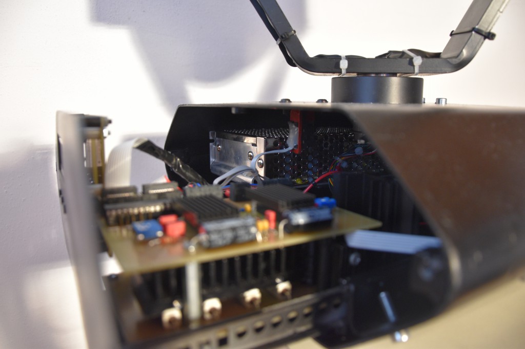

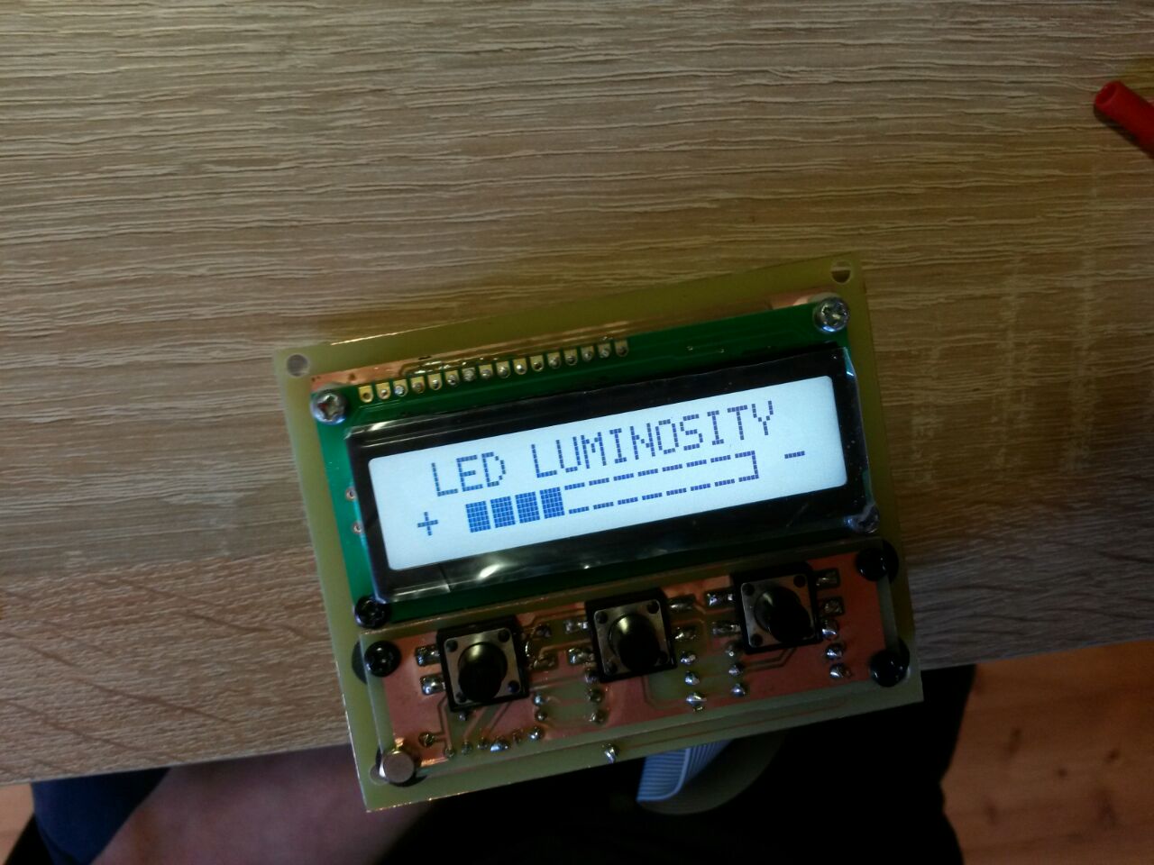

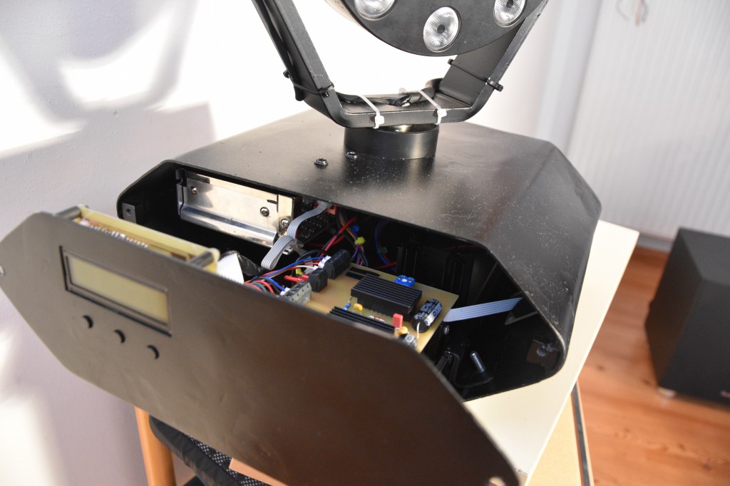

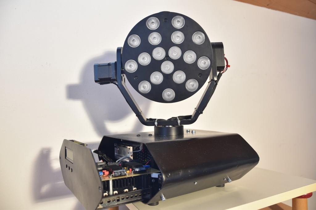

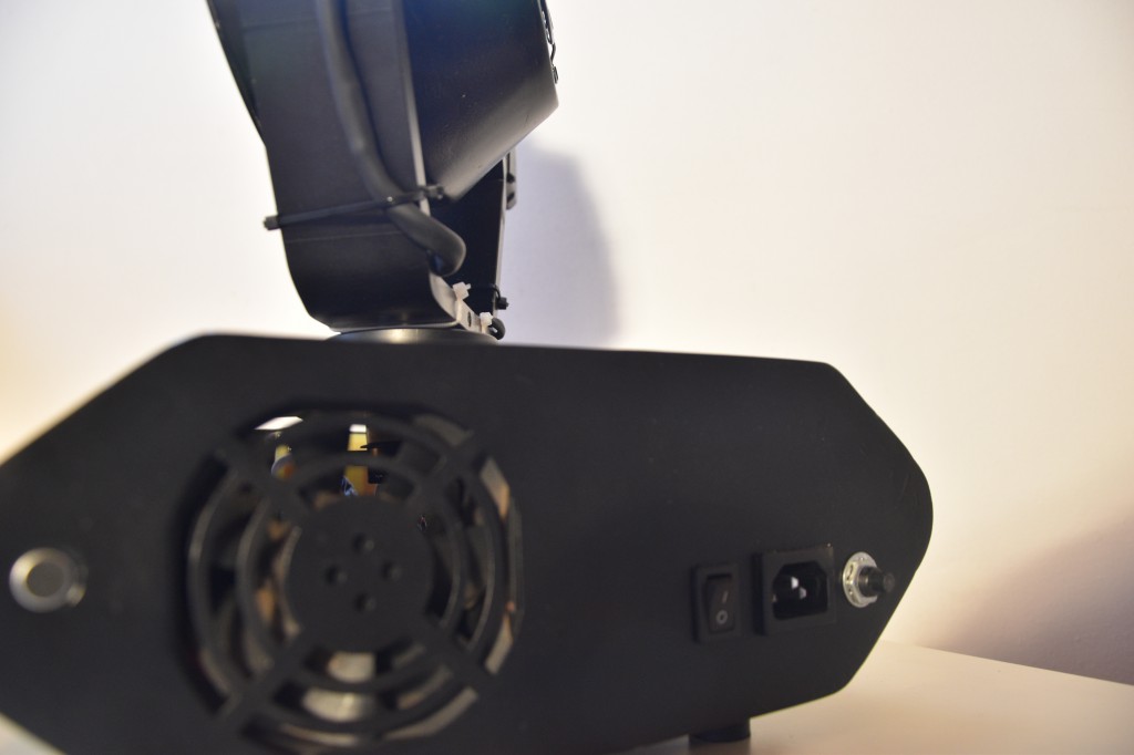

It is the wrong forum? If yes sorry. No i want to share the idea, the concept, some photos and maybe schematics if someone is interested in
Thanks, here some photos :

I thought you were selling too, and take that as a complement, your build is good and your vid is quite professional.
Are both motors steppers?, do you have sliprings to take power to the leds, or do you have wires and manage it in software.
Very impressive.
Do you have a BOM for the project and a total cost? I looked at several of these types of lights when i was planning the lighting for my wedding and it would be interesting to see how your cost compares to the commercial stuff?
What LEDs did you use, getting a good colour spectrum, true white and equal dispersion is what ups the price tag on the high end units
I'd also be interested to see your schematic as i wonder how robust / stable it is for long run times.

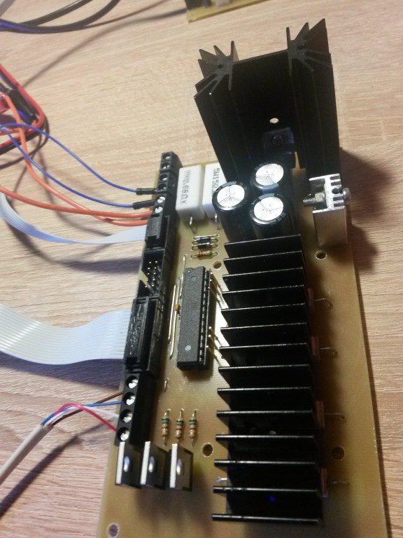

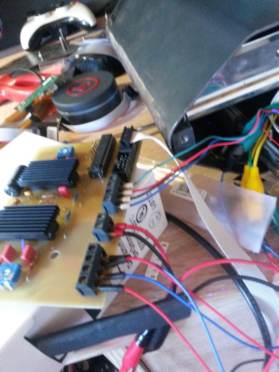

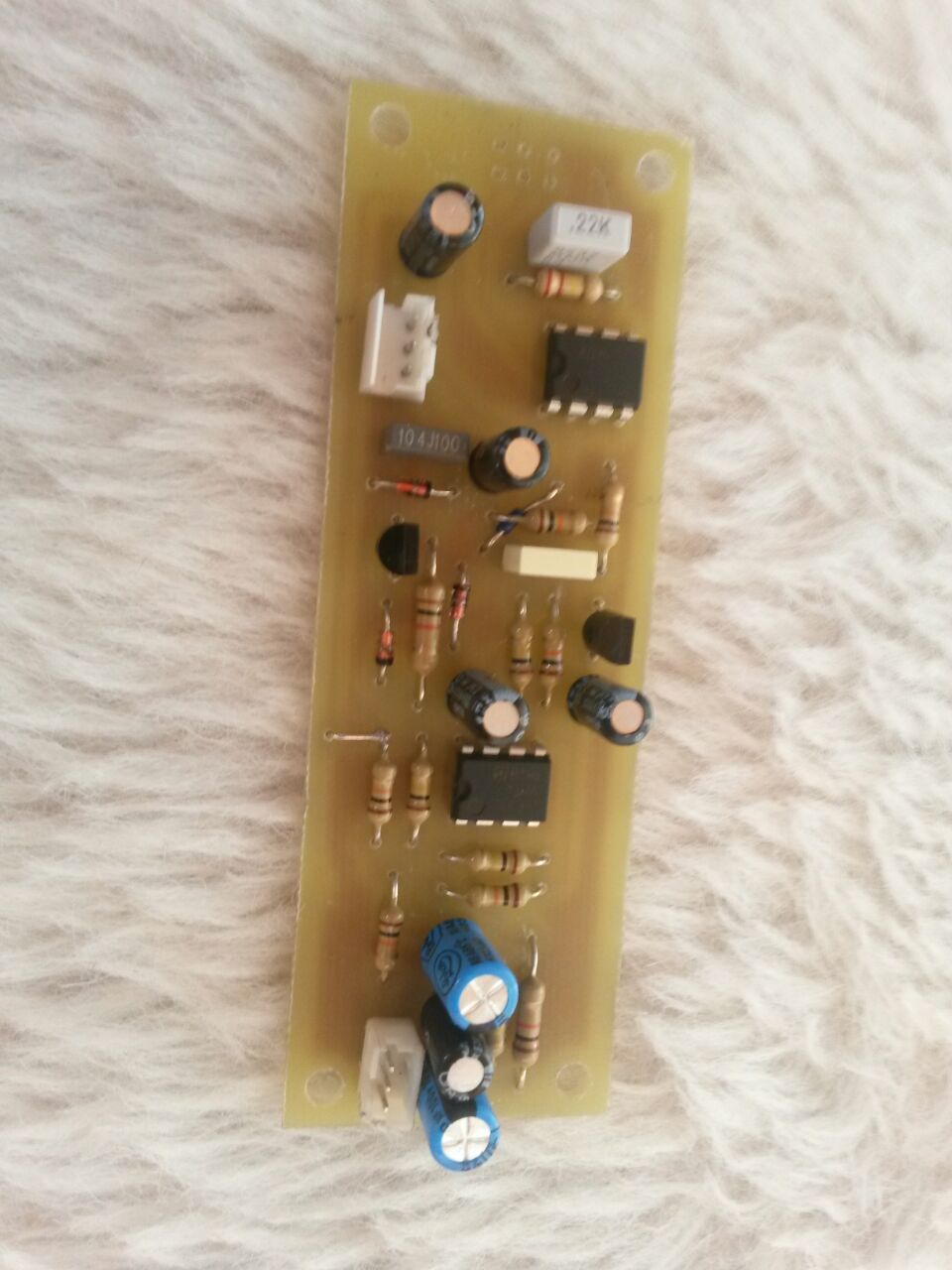

The LEDs are 3W TRI Colour. It's a module from a company called L&A. The module costed 160€. I don't have a BOM sorry, but the total cost is around 350 - 400€. Here some photos of the circuit boards:
Certainly looks like a pretty ambitious and well executed project. We're all technical on this forum, so we'd be interested in seeing whatever you're willing to share - parts, schematics, algorithms, listings, block diagrams, the lot!
