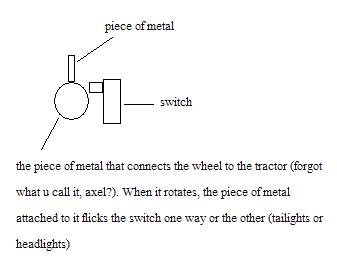

U know wut would be cool, is if the headlights came on wen u go forward, and the tailights come on wen u reverse (i dont know if thats what u already said). You could make it so that when the the wheel goes forward, it flicks a switch one way, and when it goes the other way, it flicks the switch the other way.
