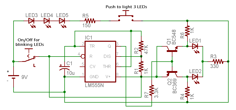

So I'm building a prop for a Sci Fi comedy show that's going on here in Chicago. It's sort of a cross between a geiger counter and a Tricorder from Star Trek. I thought I'd take a crack at making it look functional by adding some lights. I've been doing a little bit of research - checking out some websites here and there and the tutorials provided on instructables.com - but before I make a fool of myself with the soldering iron I was wondering if someone might be willing to donate some time to help me make some diagrams. I have nothing to give in return, save some karma, thanks, and a credit in our program.
I'm fairly confident that once I have the components and diagram I'd be able to do the construction myself. It is going to be placed in a tin housing since I thought it would be easy to drill any holes in that material.
So here's what I'm thinking. There need to be two separate circuits built because I need it to do two separate things that I don't believe could be accomplished with one, but if not, lemme know, 'cause I sure don't.
1.) Two alternating blinking LEDs (red and green) controlled by a simple on/off switch. - This seemed a little more challenging.
2.) Three LEDs controlled by a momentary switch (only needs to held on for about 15 seconds)
That being said, would anyone be kind enough to help me figure this out? As I said, I have nothing to offer, except a thank you and the feeling of superiority over someone who doesn't know electronics.
I would be happy to provide whatever information I can.

I will help. The alternating green and red LEDs are not difficult. You can use an astable 555 timer and a few transistors. I'd like to get a little clarification on the portion with 3 LEDs though. Do you want the user to just push the pushbutton once and then have the LEDs go out 15 seconds later or will they be holding down the pushbutton for the whole 15 seconds? Either way is doable, I'd just need to know before making the schematic.
Let me know and I can draw up a schematic in a few hours.
Edit: Sorry forgot to ask, what will be the power source? How about a 9V?

No wrong terminology, I just wanted to make sure. That's actually easier than making it with a time delay although it wouldn't have been much trouble even with the time delay. Let me draw up a schematic and I'll post it in a few hours.

Here's the schematic. For the 3 LED portion of the circuit, it will work as shown with pretty much any color LED except for blue or white. If you want to use either one of those colors, let me know and I can modify the design.
Edit: Sorry, I realized I accidently omitted a component when I was drawing everything up. Here's a corrected schematic. If you're wondering what changed, I added R7.

Holy Crap! This is amazing, I can't believe how fast you were able to get this to me. I've given you some rep points, and I'll give you some more if I can. I'll be in touch with you about the progress of this, and when we get our programs printed up I'll send it in the mail to you!
Many Thanks!
No problem. Glad it's what you were looking for. You can increase or decrease the speed that LEDs flash by changing the value of R2. A higher value will slow down the flashing and a lower value will speed it up. I'll be looking forward to recieving the program. I guess I incorrectly assumed that you were making a TV show but it sounds more like a play. Have fun building the circuit.
