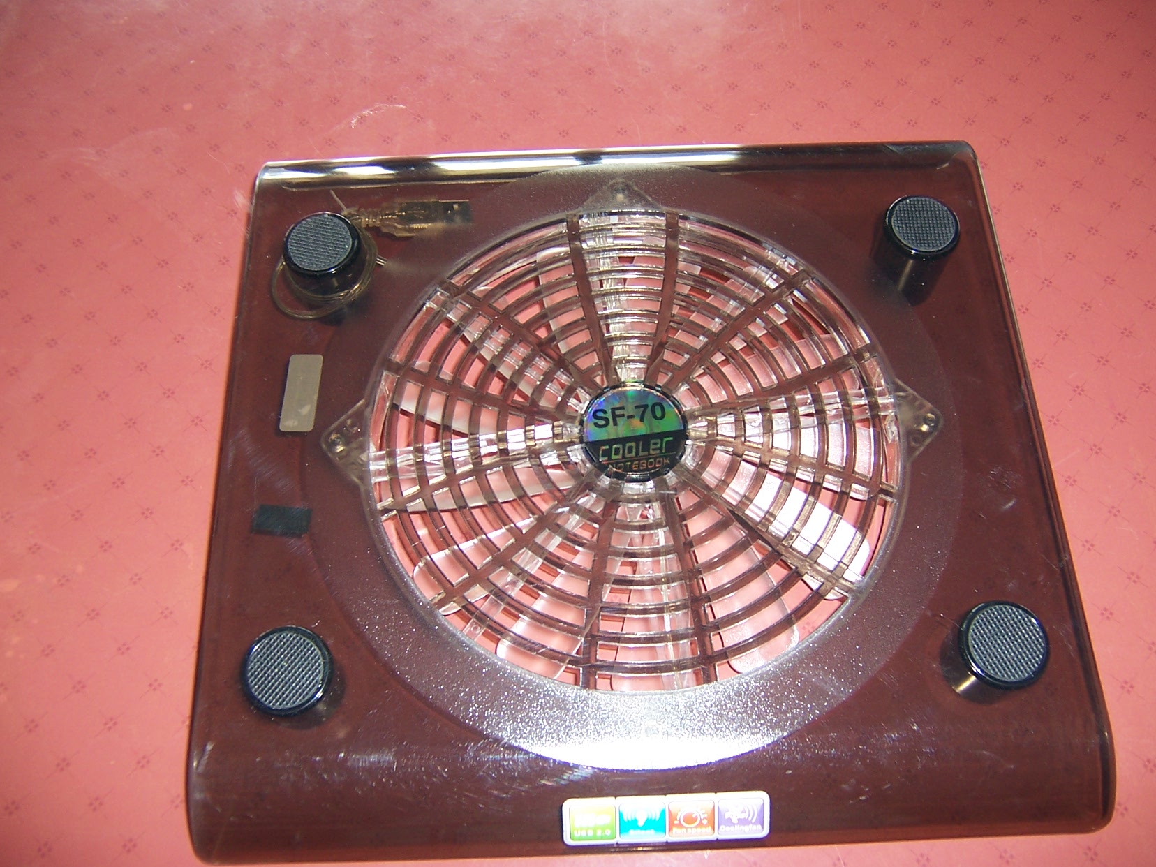

Hi thedudex2,
you might check at your local computer shop for a notebook cooling fan.
It plugs directly into a USB-connector and has a fan diameter of 19cm (7.5"). Put your notebook on top of the cooler and you're done.
The fan is super silent.
Boncuk
That was something I planed to go for. I was going to hook up three pc fans and have them run from my lab top as a beefy cheep cooling pad. Further research told me that my USB cable would only put out 5v to run. So I did not think that it would work. Unless told otherwise. But my goal was to try to connect the power of the fan to my lab top via usb chord I proudly chopped.
PC-fans normally consume 150 to 250mA at 12V which is a maximum of 3W per fan. Connecting 3 of the same kind you might overload your laptop power supply.
As already suggested use a separate power supply for the fans.
