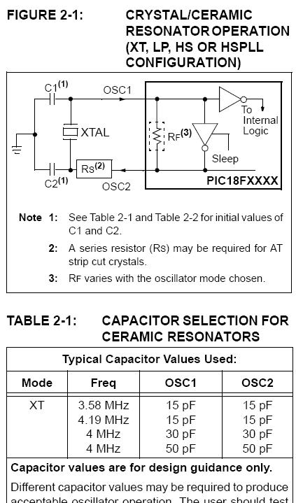

Soooo, I throw my code into that, compile a .hex file, import that to MPLAB, hit program, and all seems to work right. Until I apply power to the circuit, however... at which point nothing happens. I've checked and rechecked the wiring, and the only thing that seems dubious is the clock (I'm using one of those two-pronged crystal oscillators and I'm a little confused over the placement of the capacitors).

EDIT: Maybe it could be the clock setup, 'cause I've checked and rechecked my fuses and code. When using a 2-pronged oscillator (dunno how else to put it, those 2-legged silver cans), I have to use capacitors too, right? What setup does that need?
You need to look at the datasheet for your PIC for this section (the one for your PIC, not necessarily this one, tho they may be identical):
Ok, I've gone and gotten the recommended capacitor values specifically as the datasheet tells me. I've wired everything like the datasheet tells me, with just a few questions. the MCLR/Vpp pin should be tied to +5V, right? Does anyone have a full schematic of just a simple LED blinking board?

2- 8MHz should be HS, right? 'cause that's what the datasheet says and that's what I've set it as.
3- I've been thinking about that. For RC, what's a good value for the capacitor, and what do I set for #use DELAY in my code? All the datasheet tells me is >20pF for the capacitance, but how does increasing the capacitance change the startup time or the clock speed?

Well, I got back from Rat Shack, happy as a clam to have some new capacitors when, lo and behold...
My conversion was off in my head, and thinking .022uF = 22pF turns out to be a mistake and it would seem my clock problems continue.
It looked like, the only capacitor they carried in the pF scale was rated 100pF. I might've missed over something lower, but I'm not sure.
How much of a problem would it be to use 100pF in place of a 15pF:ltoet:x:ltoet:33pF recommended cap? would it be a problem? And if so, how well would a 100pF cap work in an RC setup, where it's only recommended to be >20pF?

Well, uF is 10^-6, nF is 10^-9, and pF is 10^-12, so 0.022uF is 22nF, or 22000pF
The 'metal can with 2 leads' is a crystal, and it probably won't start up with 100pF. Don't confuse a crystal oscillator with an RC, they are very different. With an RC osc. the cap charges through the resistor, so using a cap which is five times as large, would take five times as long to charge.

Sorry, I didn't see that. Perhaps digging through that data sheet would be good for you, however you are correct. The 'F872 doesn't have an internal oscillator.
If you don't have access to components other than mail order, you might try an RC circuit. Microchip recommends charging a greater than 20pF cap through a minimum 3k resistor. If all you have is a 100pF, you could charge it through a 3k resistor which would give you an idea that your cct. was working.

Well, the components work!
