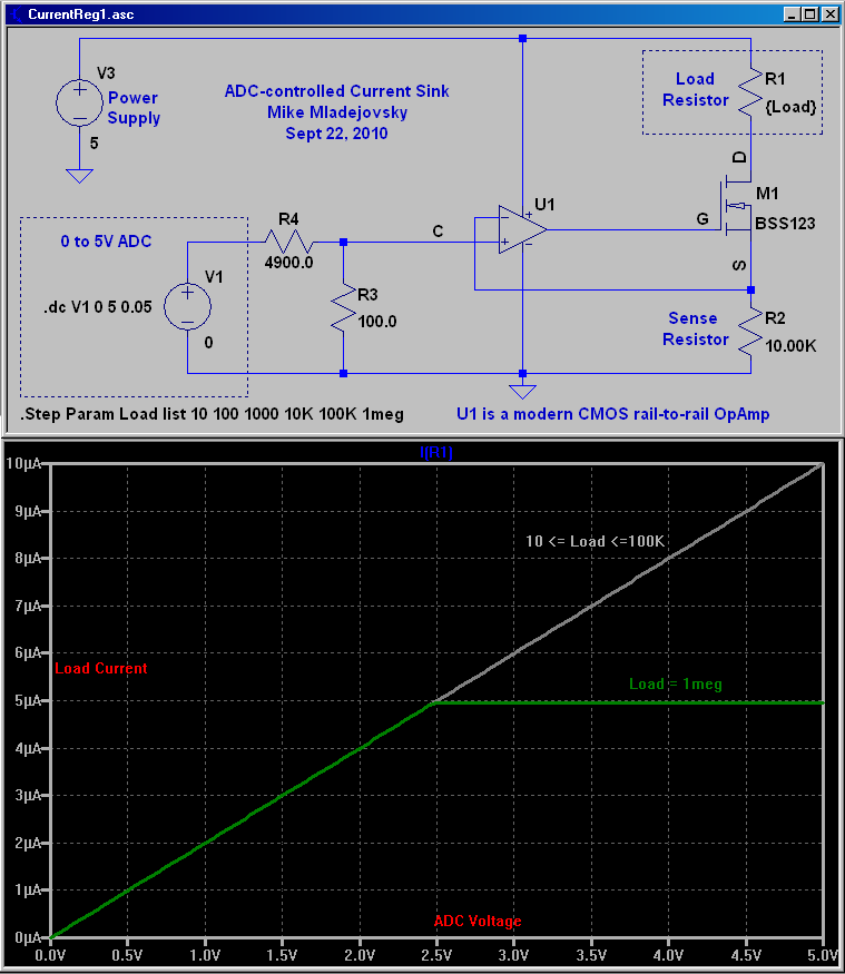

Hi everyone,i want to make a programmable current source/sink (source or sink depending on a digital signal) but i am a beginner and i don't have a clue...It has to provide 0-10uA,10 bits resolution,can anyone help???
Here is a sink that is controlled by an ADC (assumed to be 0-5V). The sim shows its compliance is limited only by the supply voltage.

Thank you!!!But,as i told you i don't know much,so could you explain the circuit a little bit?Also,do you have specific parts (op. amps etch.) to suggest for the implementation because i don't have much experience.
The OpAmp has feedback around it such that it makes the voltage across R2 (the 10K shunt resistor) follow the voltage at the non-inverting input. That determines the current through R2, which must be the same as the current through the load resistor (because the gate current of a FET is ~0).
The voltage at the non-inverting input of the OpAmp is divided down from the output of an Digital to Analog Converter (DAC, not ADC like in the schematic), e.g. a DAC6571. There are hundreds of similar DACs from various IC makers available.
The OpAmp could be a TLC2272 (dip package), or any of hundreds of similar ones available from various IC makers.

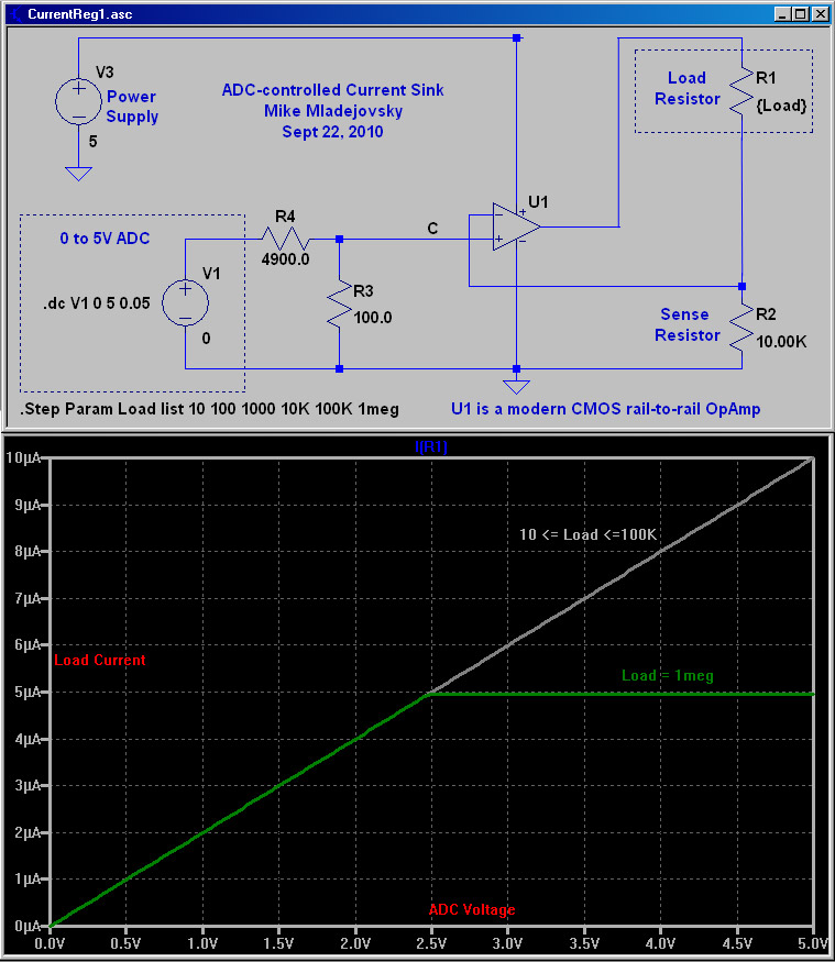

Actually, what is the MOSFET for? Didnt he want low current like 10ua or something like that?
Hee hee, i just had to ask because normally MOSFETs are employed to provide fairly high currents and after all the little op amp can surely handle 10ua all by itself can it not? <chuckle>
What is so funny??? If you notice, the NFET I specified is tiny; I used it as a voltage-controlled current-source. Do you have a circuit that makes a current-source for a ground/VDD referenced load using just an opamp and some resistors? Obviously, you can put the load in the feedback path, but that forces you to have a "floating" load.

Modified yours

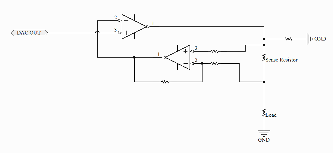

If someone had asked me to do the same thing, I also would have used a pass transistor and not thought twice and I didn't think twice about your circuit. It's not like the circuit wasn't good, it's just funny to me how my habits block my own innovation. Here is an abbreviated schematic as requested.

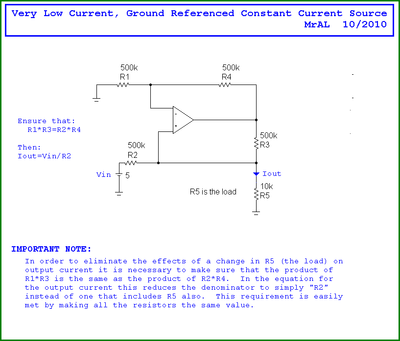

I had a hunch that this could be done using one single op amp though so that brought about the following circuit.
It should be noted though that the output equation contains the load resistance (R5) in at least one place and to cancel that resistance out requires the products as shown on the schematic to be the same. Also as noted, if all the resistances are made equal this is easily met. To find out the effects of a mismatch of these two products we could do a few simulations. It may require 1 percent tolerance resistors but again we'd have to do a quick study to find out for sure. I have a feeling it would mostly affect the gain.
Vin in the schematic is the assumed 5v DAC but the resistor values can be adjusted for other levels.

Mr Al's circuit has higher compliance if R3=R4 and R1=R2 but R1=n*R3, where n is 5 to 10.
If the opamp is powered with split supplies, and the DAC is bipolar, say -5V to +5V, then Mr Al's circuit both sources and sinks into a grounded load.
